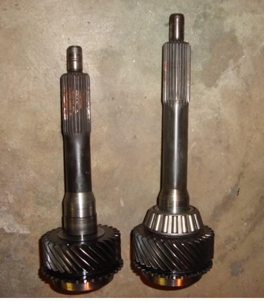

I believe the input shaft and faceplate are different.
You could swap out both to run a LS bell and hydraulics. He will need a firewall plate and master to go to the release bearing.

The Lt1 front cover won't accept the hydraulic bearing from the LS style T56, because it's not machined to accept the bearing. I considered getting my LT1 front cover machined to accept a hydraulic bearing, but I found a deal on a new LS style front cover, so I bought it, when I was converting my lt1 t56 to an LS style t56. I see no reason why you couldn't change the front cover to an LS style cover, and still run your current input shaft, although I personally haven't tried it. Let us know if you do this, please. I'd like to know if it works on an LT1 T56. That would be pretty trick!

LT1 left LS1 right
