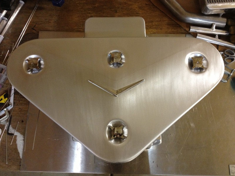

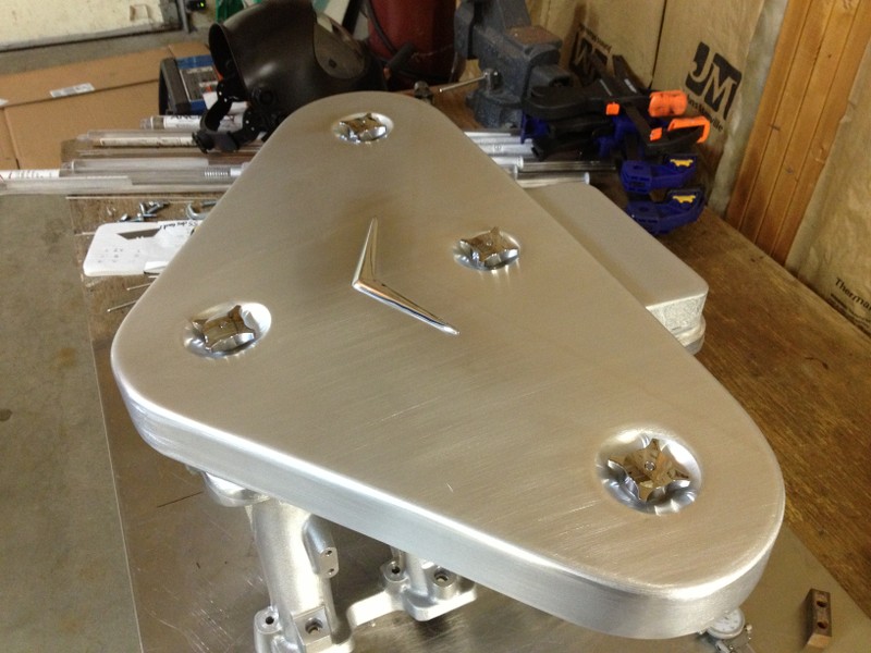

Thanks! From an outside prospective, should I sink the 4 star nuts into the top even if they are obviously not attaching dual carbs or filter pods?

I would since you're doing the faux top.
Shoot, some people probably bought those cars just for the batwing.

Skip, come on man it's not a faux top! Faux top would be like draping a batwing over the top of a stock LS intake. This one actually works! Well, it will work one day
I should have this whole induction/intercooler project finished up by the end of the weekend. I'll then show how it all works.
For now, a couple of progress pics....

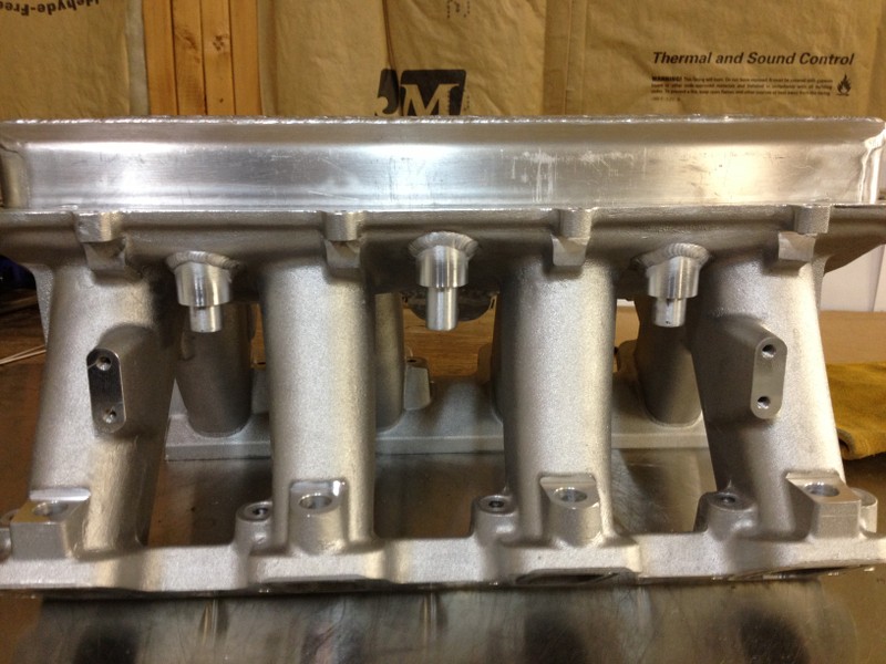

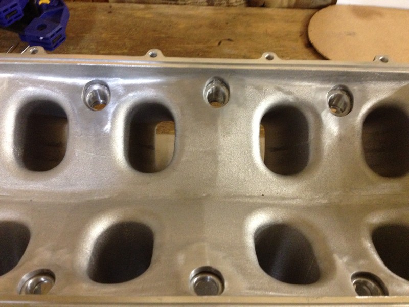

I didn't get the throttle body flanges so I can't finish it this weekend but here is the liquid side of it.
Triple 5/8 inlet and outlet tubes on the core end tanks drop through internally o-ringed bungs welded to the lower intake plenum. Hoses connect to water manifolds (with stepped internal directors to help promote even flow) terminating to a single 1" inlet and outlet through the rear bulkhead of the intake.
