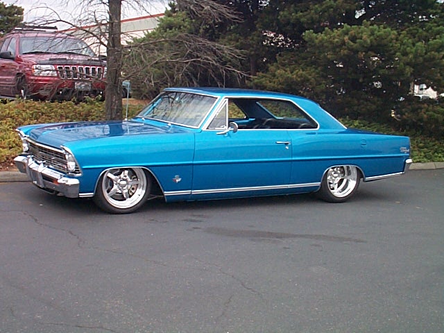

I love the stance on this car...Its mini tubed and air ride.....
