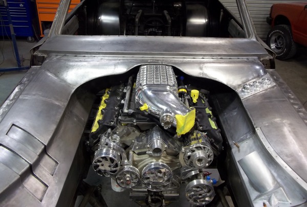

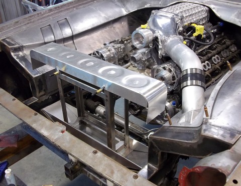

We got the inner fenders all finished up and the top and bottom tank for the radiator made and started on getting the exact placement of the radiator.

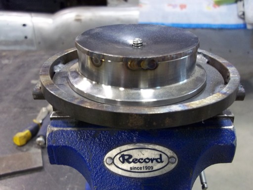

He'll be very pleased with what your doing. Awesome! Can you show what that die looks like from the side?
Thanks
Here it is. The top part of it is a half of a v band clamp with an 11 gauge top and the bottom is just some scrap that we had laying around. I know it is crude but it got the job done and did not take long to make.
