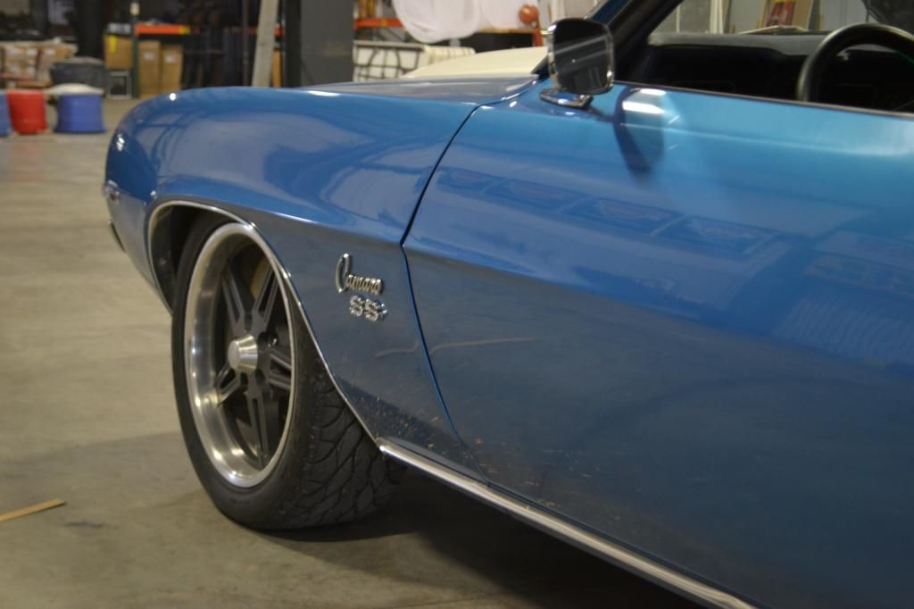

I have had the Truturn system on my '69 for over a year and went with 18x9" with 5 3/4" B.S. and 275 KDW tire. Before ordering wheels and tires I did a test with a borrowed 18x10" 5 3/4" B.S. and 275 tire and decided there was no way it would fit well without some modifications to the outer fenders. My car was already painted and been driven for many years so that was not an option. At my present ride height, the tire sometimes rubs the paint off at the top, bottom area of the fender while turned full lock and while moving over bumpy surfaces (like parking at a field). You can not see the damage except getting down on the ground and looking up at the fender lip. I will have to touch up the paint a couple times a year if I keep it this height. About half the time I do have to make 3 point turns while parking. I have only neg 0.5 camber now and plan to get it realigned to about neg 1.5 in a couple months, so that might help some. Also I removed those top fender bolts about 18 years ago and the fender has not fell off yet.

I will also mention that while at the Southern Slam Track event last year, I asked Stacy of DSE to turn the wheel full lock on her '69 Camaro test car. (The car now has a 10.5" wheel and 285 tire) The tire tread touched the top of the fender. And on another DSE equipped Camaro that had a lower ride height, I noticed some slight fender damage (bent) in that area.
My car presently has 1/4" between the tire tread and fender at full lock with no one in the car.

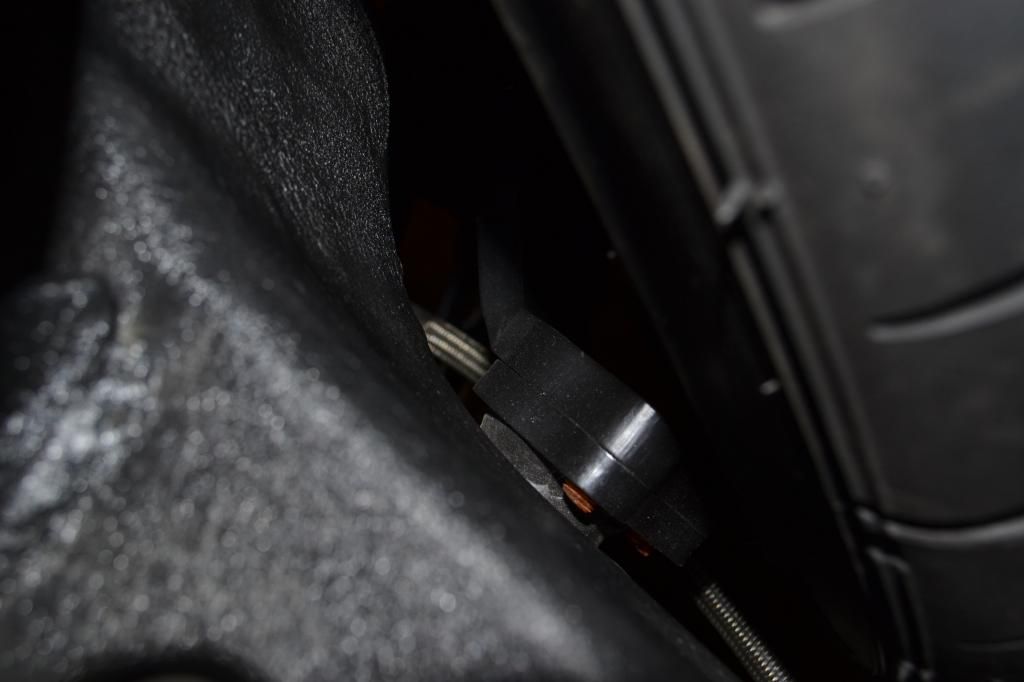

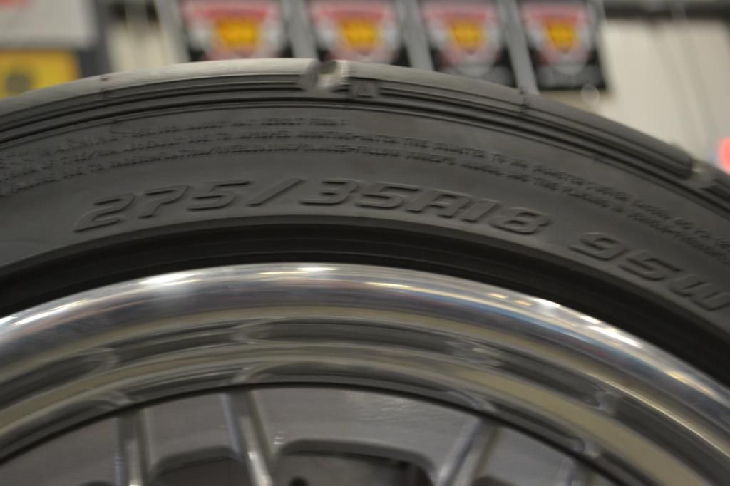

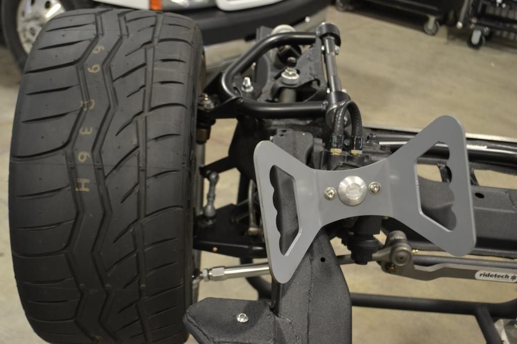

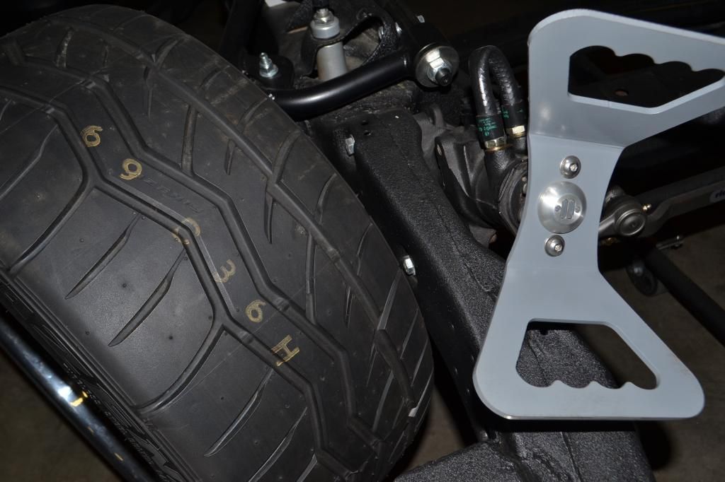

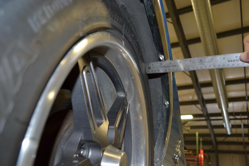

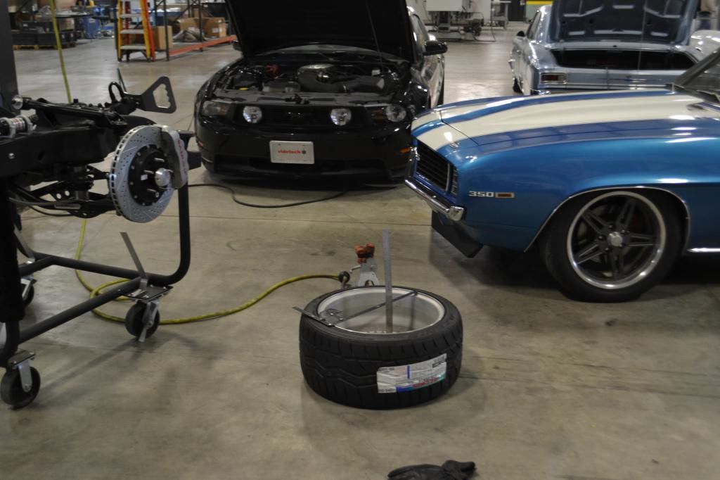

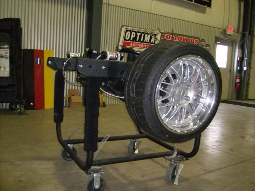

one of the guys here at the shop has a Daily 69 with all the suspension gear and stock fenders, chrome fender trim, and a low ride height and he runs 8 inch wheels, so he pulled it in the shop and I used a recommended 18x10" rim with 5.75 back spacing and a new 275/35/18 to check fitment, right off our shop Tru-Turn display, here's a few pictures and I hope these helps
first the tru-turn setup with the 18x10 rim for reference

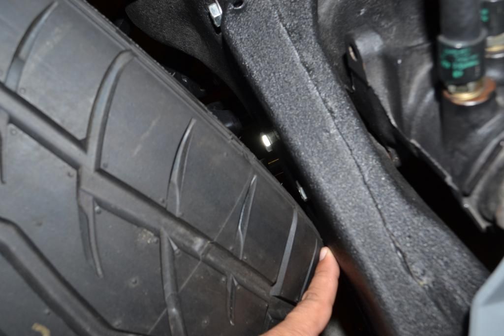

lock to lock views of tire to frame clearances left and right
left turn first
here is the tire barely touching the frame under full lock
then right tire just kisses the sway bar under full lock
and over a half inch away from the arms

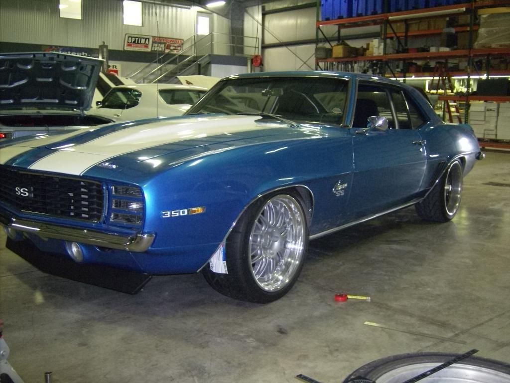

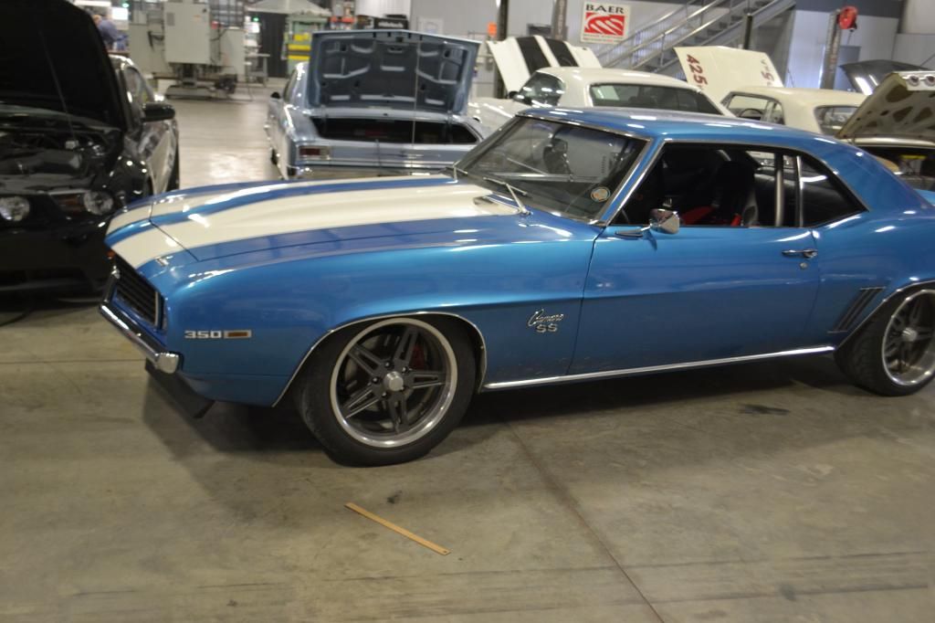

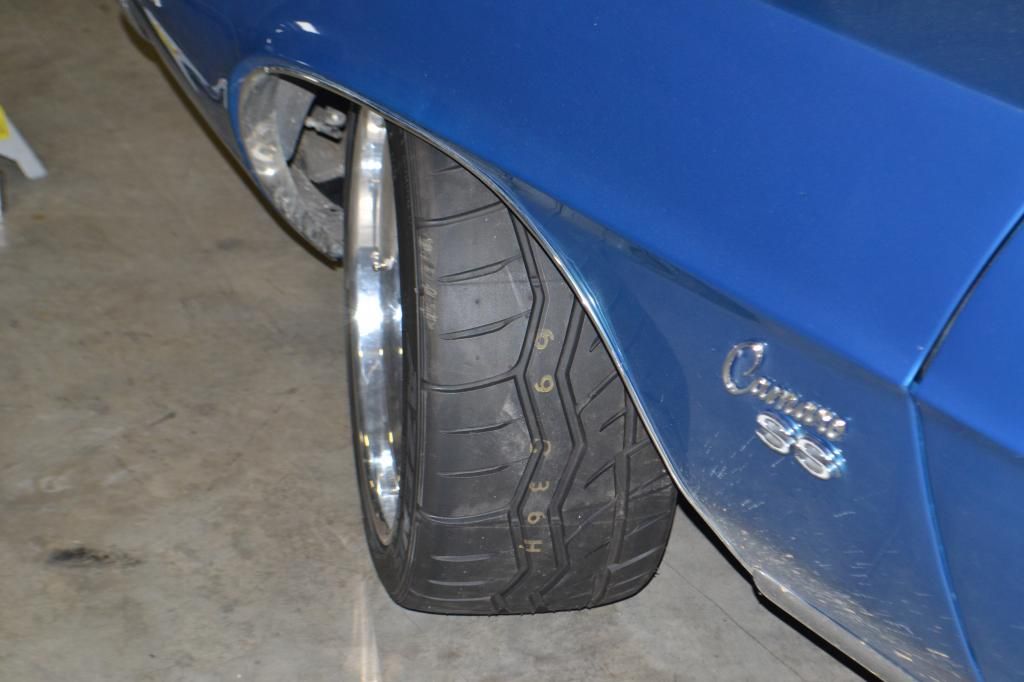

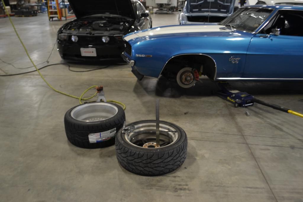

next we bring in the victim! a nice 69 camaro with stock unmodified fenders, with chrome fender edges, and all the bolts in place
here you can see the 8 inch rim and all the clearance

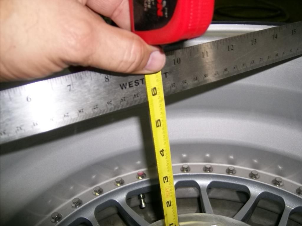

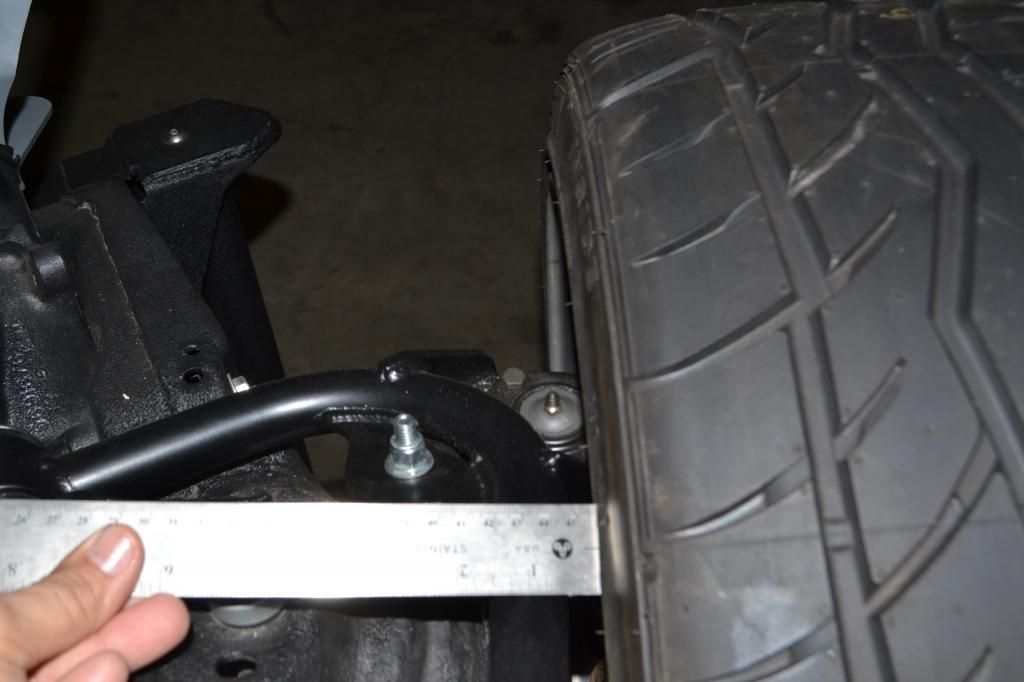

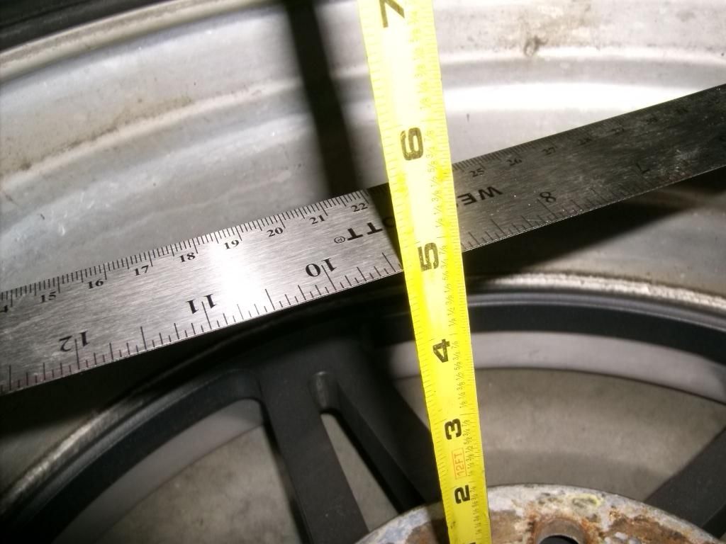

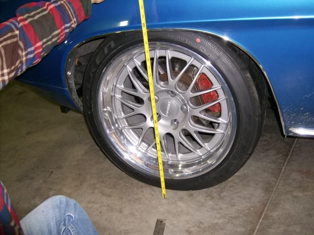

now to measure back spacing as a prof of life for everyone
it was hard to read the silver ruler with the camera flash so we switched to a standard yellow tape to show the 5.75 backspace

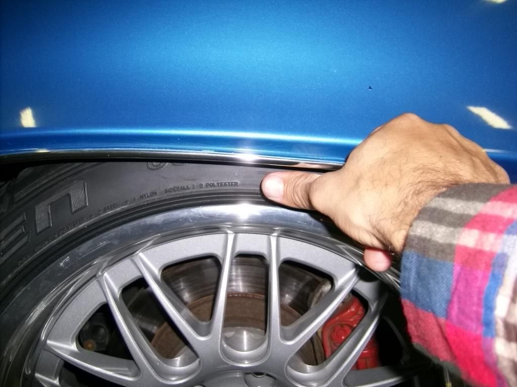

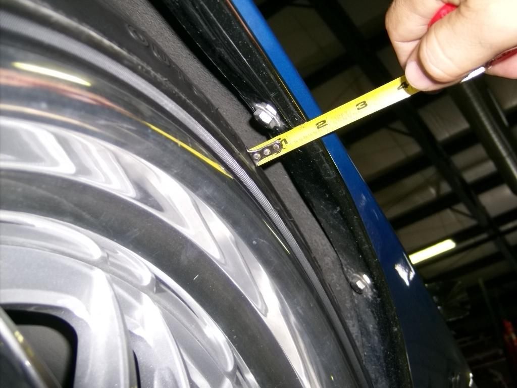

and I measured the 8 inch rim and it was a 5 inch backspace(it read 4-7/8 in reality)

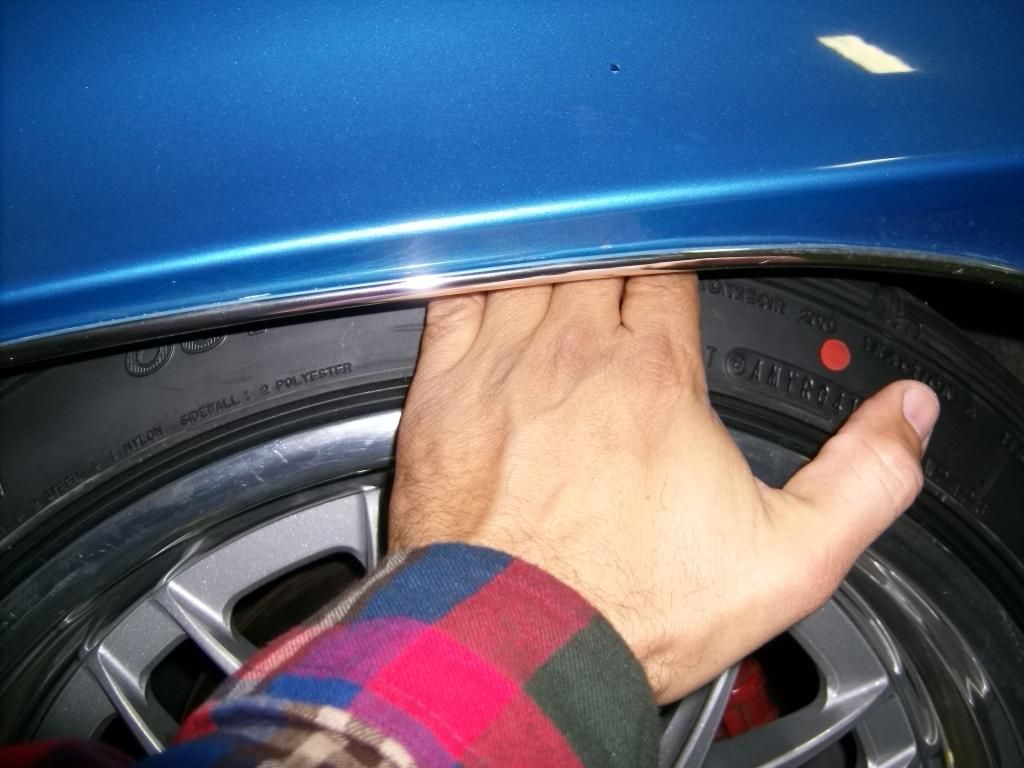

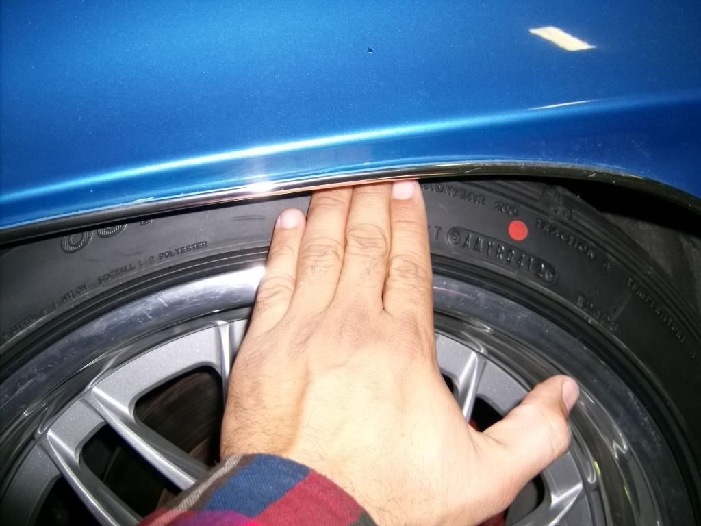

ok now to install the rim, and then I moved the car around the shop to settle the suspension to actual ride height
now left and right turns for clearance
so the question is how much space is there?
enough my fingers fit
roughly about a thumbs thickness above the rim

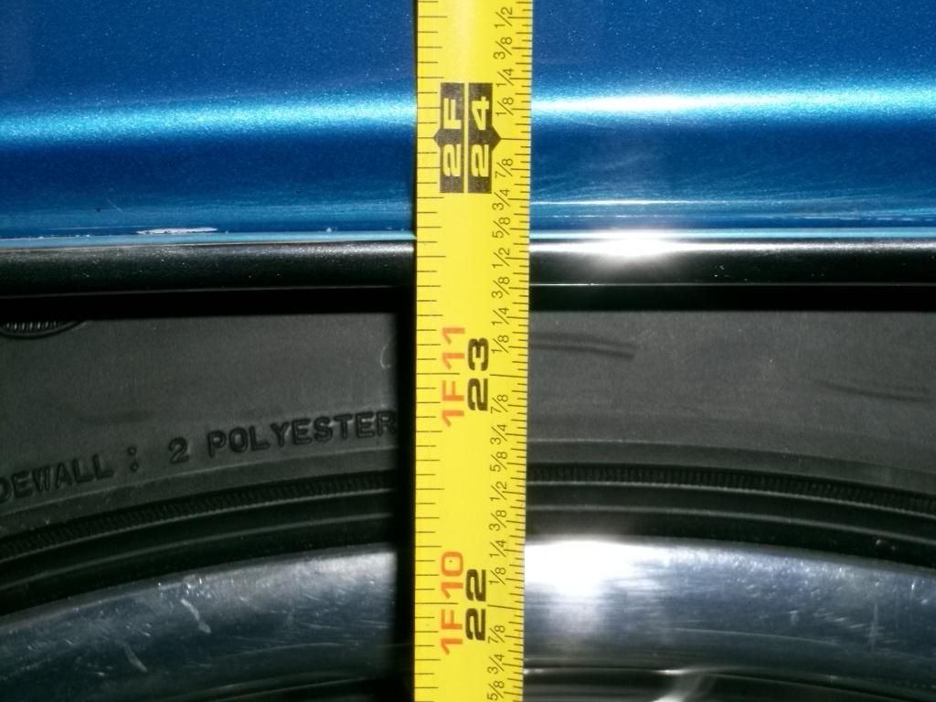

or here is the actual ride height numbers ground to fender edge 23-3/8 inch
Rod Prouty
My websiteAuto-cross 101
Bangshift Stories

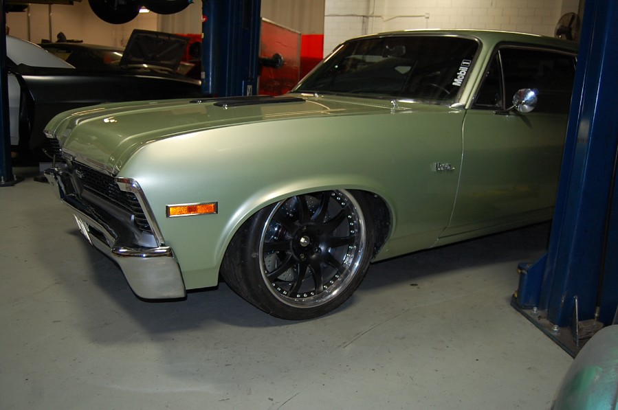

every car is different...I still say its all in the alignment..btw....18x10 6 7/8" back space 285/30/18 23.5" fender height -.8 camber 5.6 degrees on caster on a 71 Nova.
Modifications, button head fender well bolts and tru turn. Steering components are 1/8" away from wheel hoop inner step. Fully cleared on a smooth hoop.
