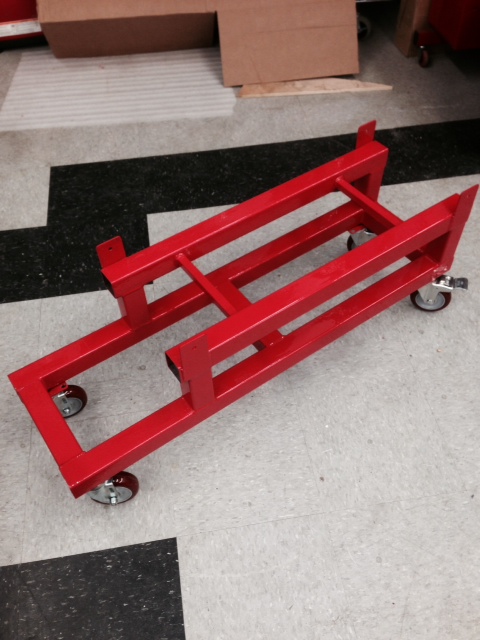

Made a cart this afternoon from some 2x2 scrap tube and some decent 275lb casters, to get this thing up off the floor. (It needed to be 'Murican height, and not Taiwan height). This will raise it by 13".
I extended the base by a bit at the motor end of the saw, since when the thing is in the vertical position, the stock base gets a bit "tippy".
when the paint is dry i just have to hoist up the saw and put it on top. It will bolt on at the four tabs, to secure the saw to the base.

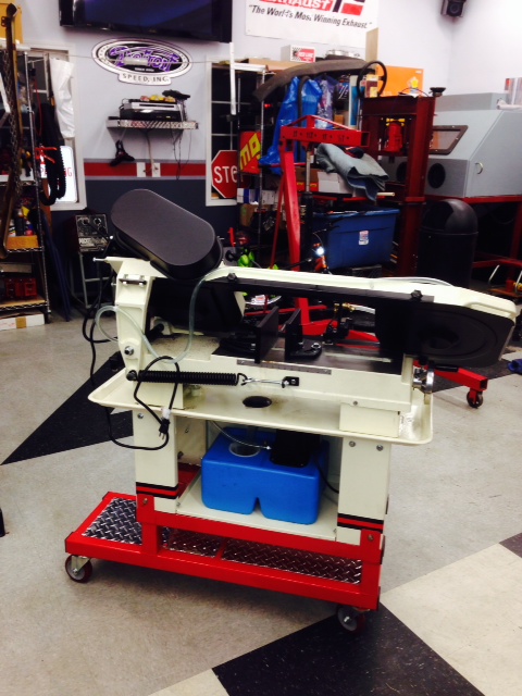

This is much better. Vise jaws are up at belly button level now. and with the head tilted vertically the center of mass is well supported. Sorry for the fuzzy pics.

Looks good Rob.
Fore and aft is covered.....how is it side to side?
Mine has a fixed kickstand on one side. I'm thinking an aftermarket motorcycle stand might be the ticket.......if you need side support.
