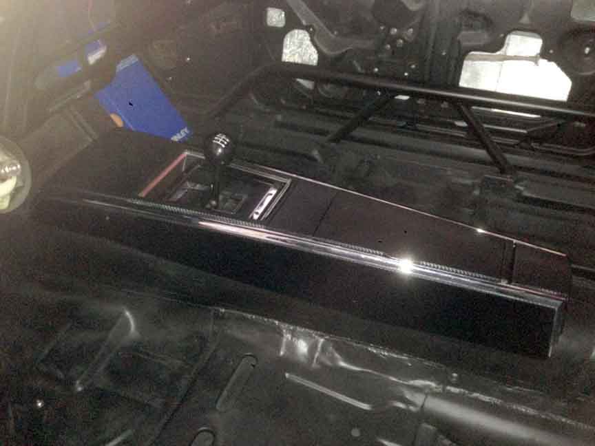

Nice work there Brendon, Is that the original center console you are using ?

Thank you! Yes, that is the original console. I just wrapped it with carbon fiber wrap (3m "shelf paper" ha ha). The nice thing about the wrap is that it doesn't permanently damage the console should I want to remove it.

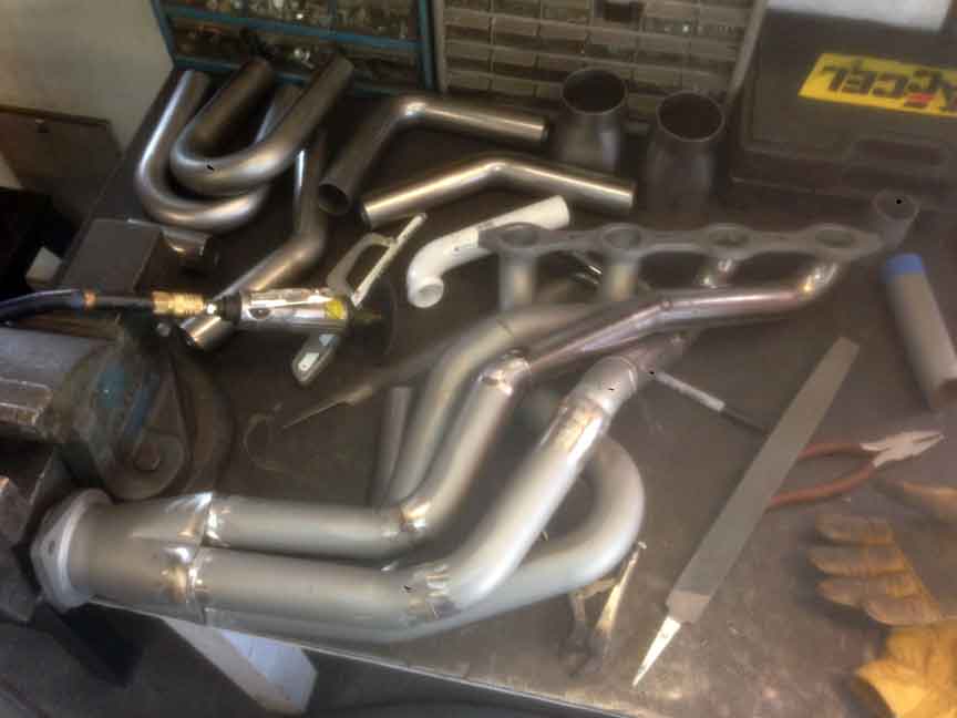

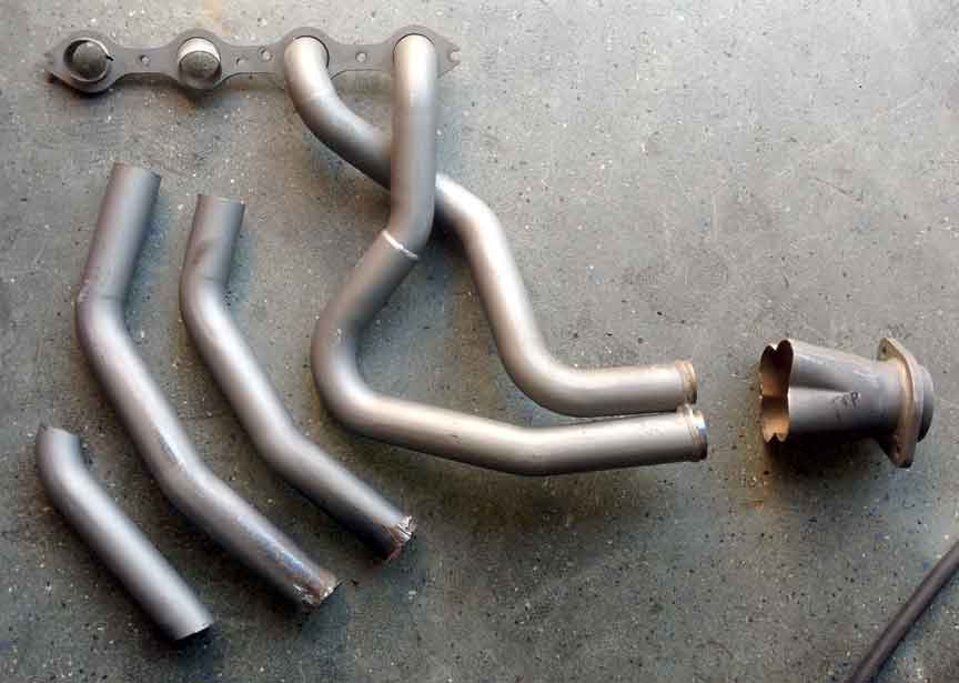

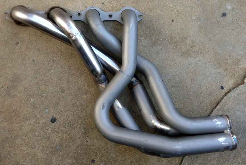

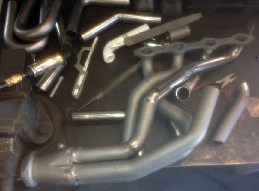

OK, I made a mess in my garage this weekend, I mean I did a lot of cutting, sanding/ grinding/ trimming to rebuild the driver side header to fit my car. Man, these things are a lot of work. Of course, I'm sure there are some tricks to doing this that I wish I knew about. I just need to put the collector back on, do some clean up work and send these out for coating.

Good job! That's some crazy angles to work out! How did you do the layout? Was it by eye cutting and tacking pieces as you go or did you use some kind of mockup wire or PVC?
  #367
Old 02-12-2014, 09:05 PM
Tuske427's Avatar
Tuske427 Tuske427 is offline
Join Date: Jan 2010
Location: Los Angeles
Posts: 662
Thanked 17 Times in 12 Posts
Thanks, Ryan! I worked from the top down, and did one at a time. I did buy some pvc tubing I thought I could use for mocking up, but ended up not using much more than one curved part for basic placement. The diameter was wrong and didn't match the curves of my metal tubing.
Once I had the top areas figured out/ past the tight spot I just joined them back to my original collector. Then, when it was mocked up, I had to take the two tubes back off completely, and weld them up, then reattach them and weld them up completely.
Having a sanding disc was key for me for making the tubing flat for good joints.

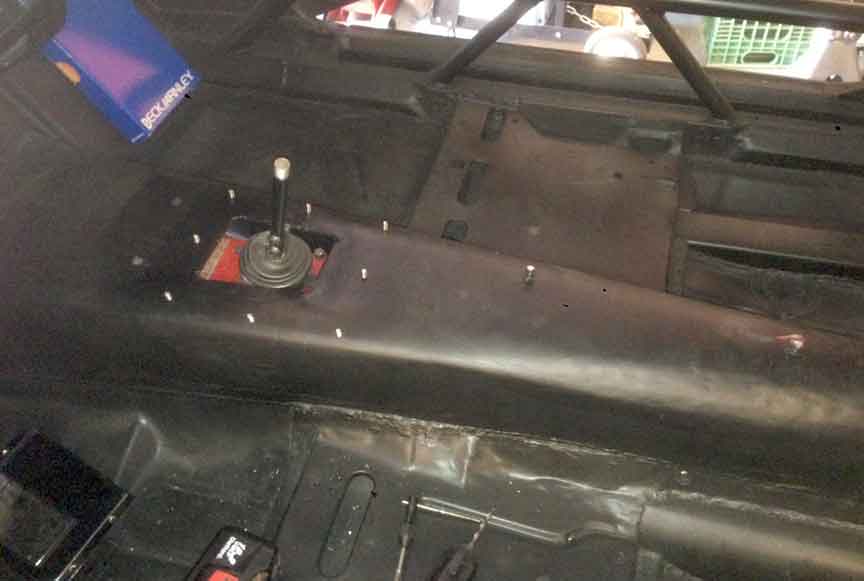

This weekend was a bunch of little projects. I got the collector back on, as well as O2 bungs, and added fasteners to my trans tunnel for the center console and rubber shifter boot. I also attached a few more clamps for my fuel/ brake lines.
My wiring showed up so I can start to work on that, too. I need to get my headers coated now so I can get them installed and then start reinstalling the front end sheet metal.
Long Live the Muscle Car
