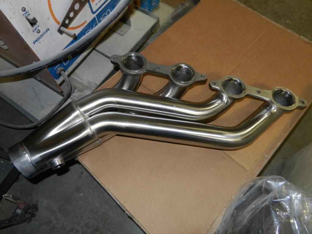

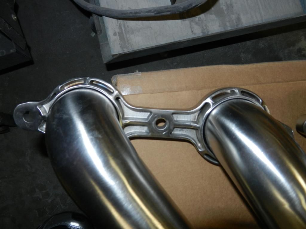

These are the flanges on the Ultimate Headers for my Chevelle. (totally different application using a RS chassis) Well built and good looking.
The ones that Blake showed are nice as well. Headers are one of those things that you are kind of stuck, either spend alot and get a good piece or buy some inexpensive ones and fight fitment and even worse... Leaks. Kinda comes down to what is your time and frustration level worth?

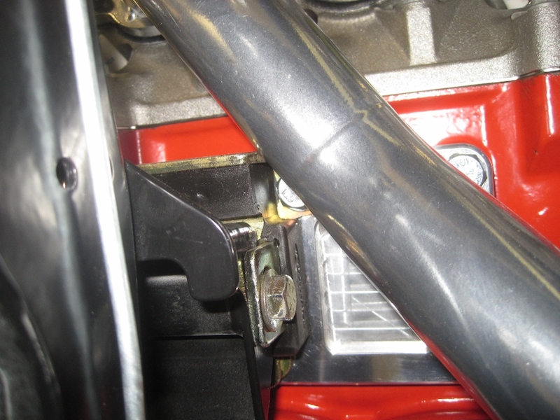

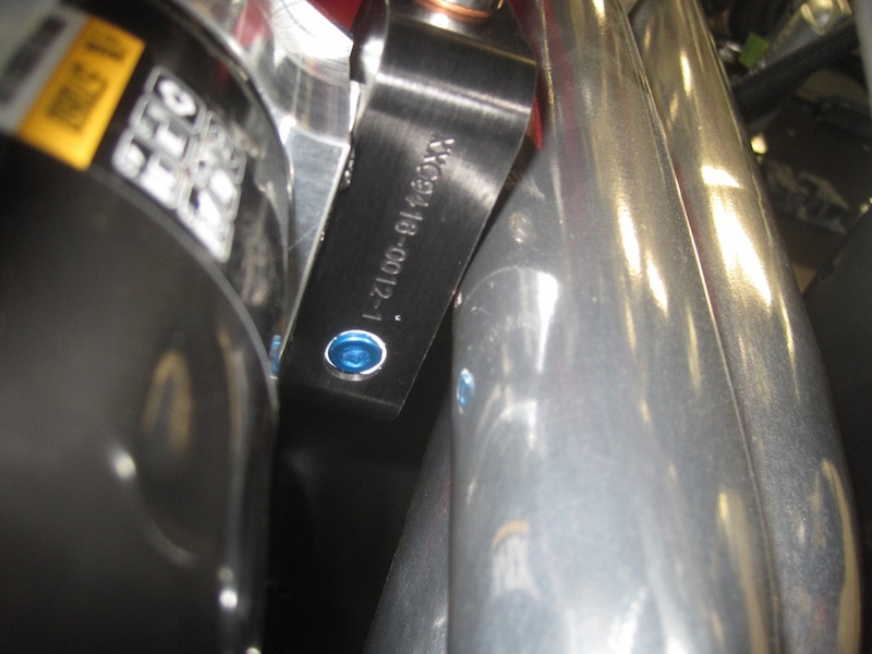

We had to clearance the DSE motor mount.
Name:  Header clearance to motor mount.jpeg

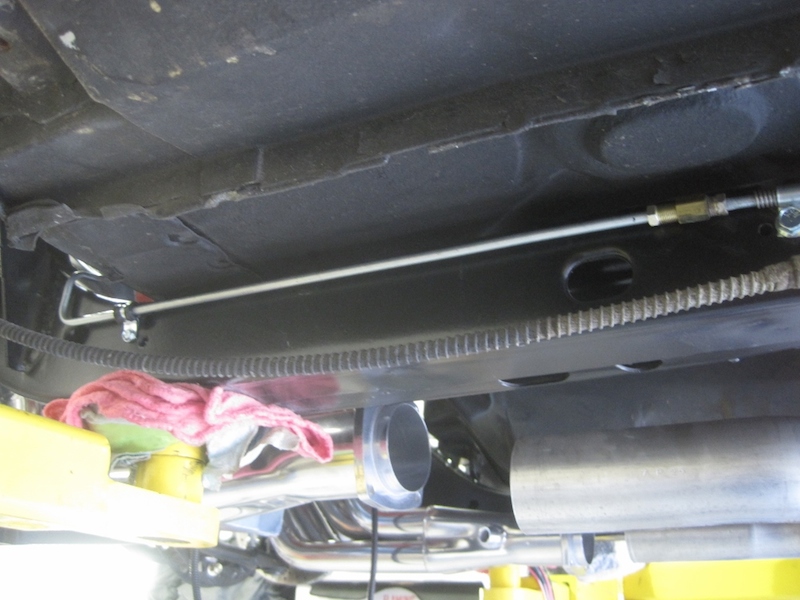

Better angle of how tight the headers fit
Name:  Rear brake line and headers.jpeg

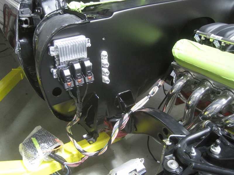

Name:  ECM reinstalled.jpeg
