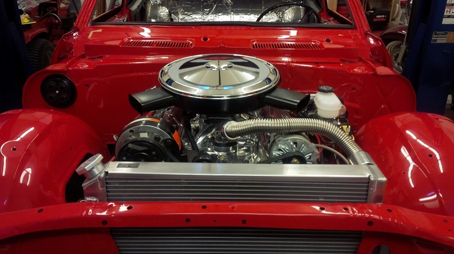

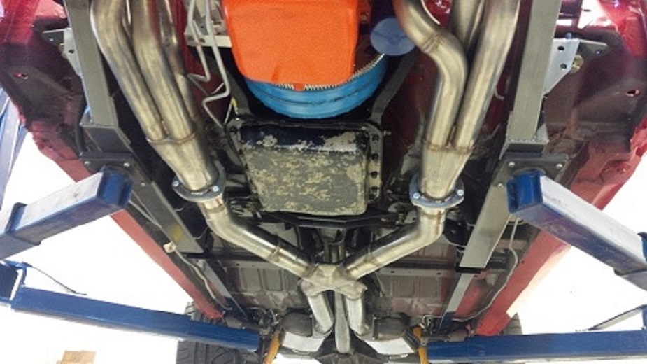

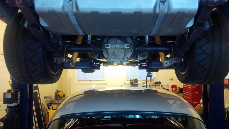

got the hydroboost,power steering plumbed,cooling system,all c5 brakes installed and lines run.put in "c' clip eliminators and HD strange axles with 1/2 inch studs.had driveshaft made,3 inch stainless magnaflow exhaust.i wired in the battery in trunk with ford starter relay.wired in ignition switch,fuel lines.tci shifter. inner fenders.getting there. i should be on the road by summer. probly late summer!

What accessory bracket set are you using on your 427? Looks like 88-93 GM sbc serp brackets.
