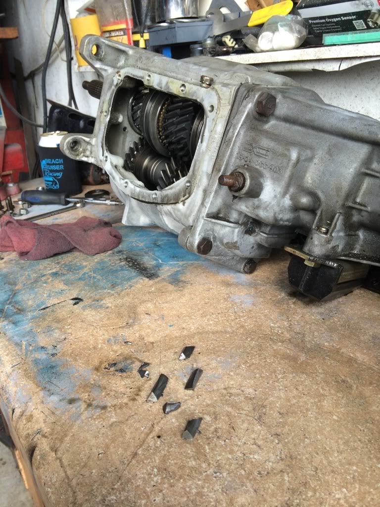

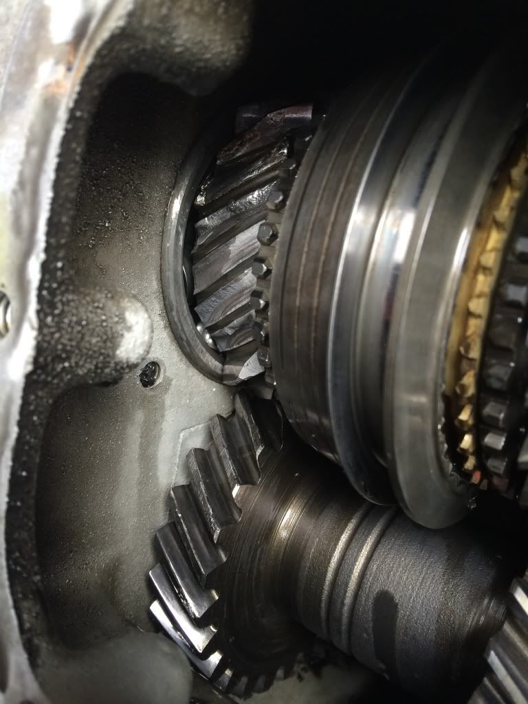

Got the trans out, lots of little pieces of the main drive gear in the case, this is what Ka Blewey looks like!

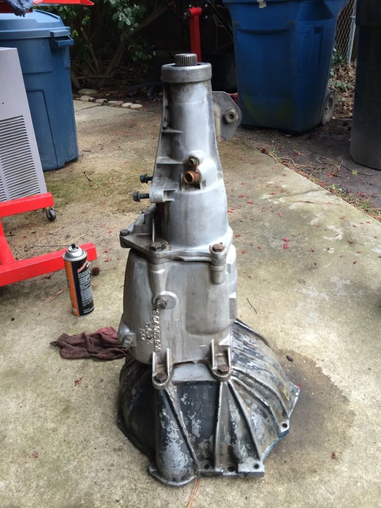

Grabbed this today off of Craig's List, it has an even steeper 1st gear than what I had before (Good for standing start autoX stuff), spent the day cleaning it up and replacing a few seals while it's out of the car. It appears to have been rebuilt before, everything in it checks out and looks good! Going back in the car tomorrow night. should be rolling to C&C for the weekend! Grand total, $150! sometimes you just get lucky...
