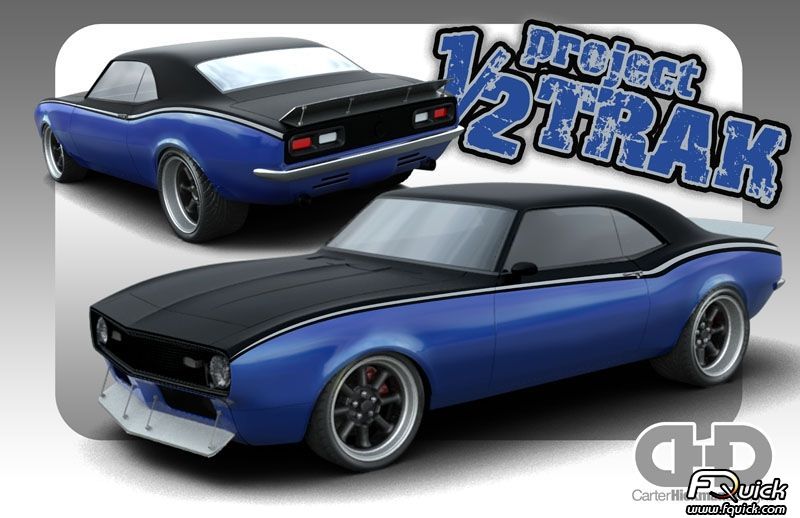

Originally Posted by Damn True View Post
Picked up the Lateral Dynamics bits from the powder coater this afternoon and there's a big pile of boxes stacked in the garage.
Actual work...coming soon!
Yours is the first rendering I saved to my hard drive when I discovered Pro Touring.
For the newbs here...
Chris
Its not a Vega!!!!

Wow, thanks!
