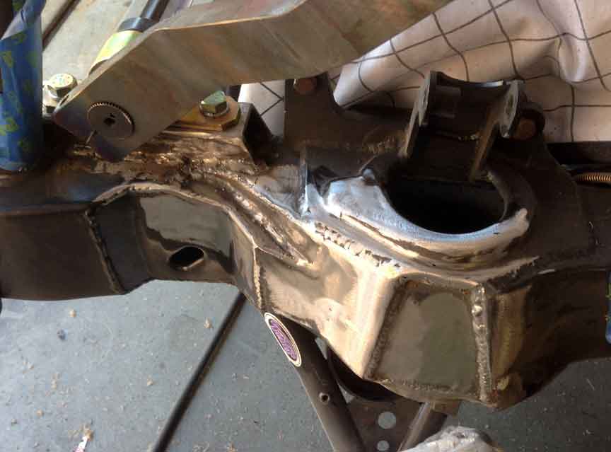

I welded up my frame areas this weekend making sure I still have clearance for the bar and bolt head. I also ordered some heim joints and other little parts to help finish this one.

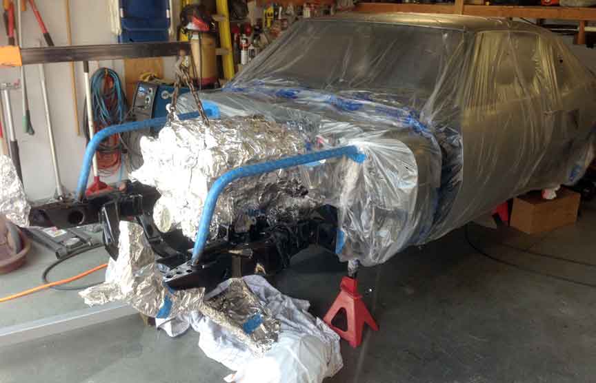

This weekend I painted my frame again. I'm a bit bummed because I wanted satin black, the can of KBS paint I bought said satin black, but it came out glossy. Grrr. Oh well, I want to drive this thing so the shiny paint can stay for now. I'm not trying to build a show car.. I spent the rest of the weekend putting parts back on.

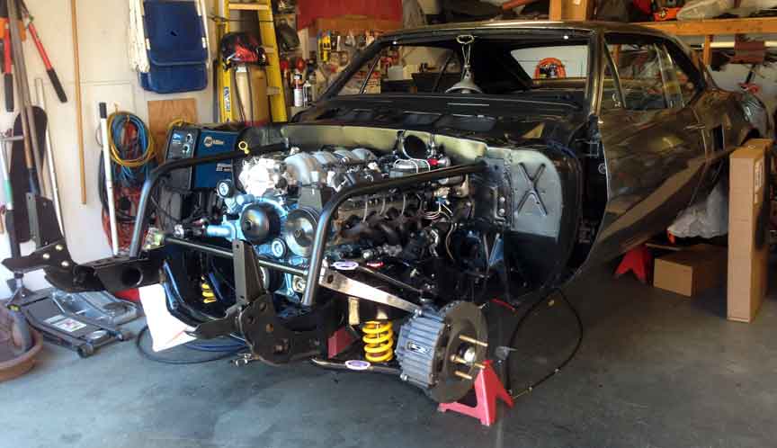

Back from my bi-annual 2 week work trip overseas this weekend, and got a day in on the bird. I made lower end link mounts for my front sway bar. I also mocked up where the end links might go and ran the suspension through its full travel lock to lock to make sure I wouldn't have any binding, and gave myself some clearance for when the alignment shims come along and move the upper ball joint closer inwards.
