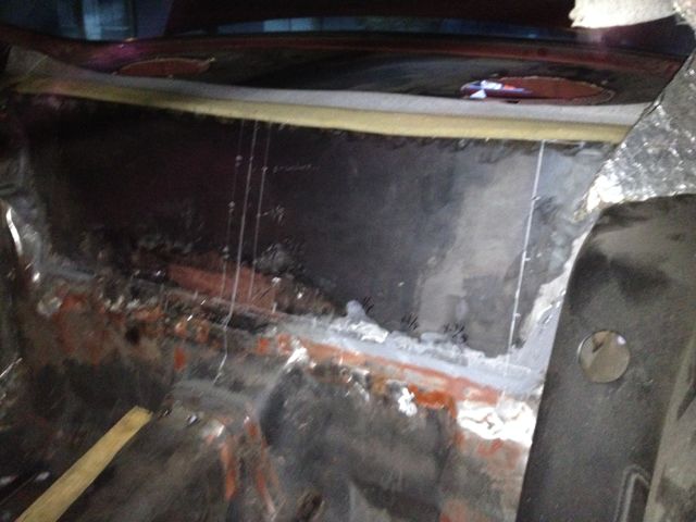

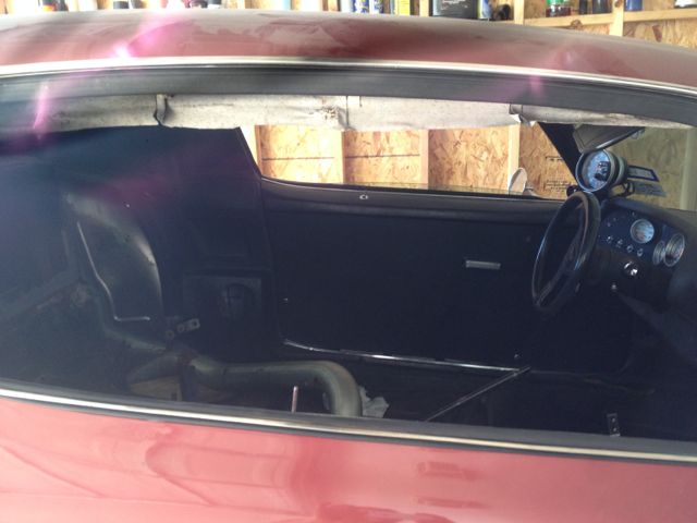

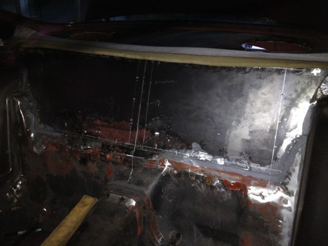

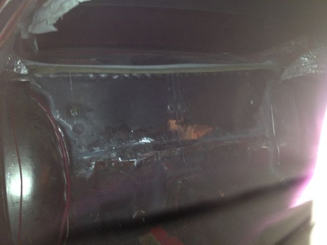

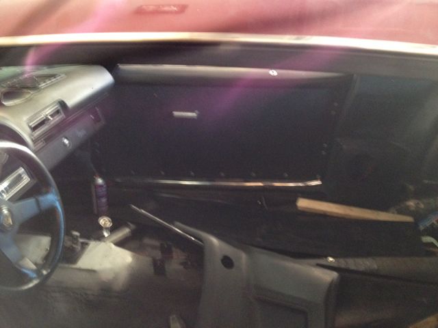

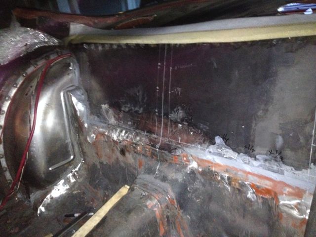

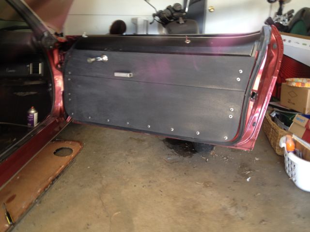

I've been working a little bit on interior cleanup. I tried to make a set of door panels a few years ago. They turned out good at the time but heat caused the glue to release and they really started looking bad. I grabbed a sheet of 1/8" black ABS and built some new door panels.
I plan to use the same material on the rear seat closeout. I added some allen head bolts with stainless washers to create a little more texture. I also cut down the bump in the rear section from the floor seam and welded it closed. '
For the lower area I'm thinking to grab some 1/2" or 1/4" square tube and build a box big enough to house the side exit exhaust if I go that route. I can this cover with the ABS. If I decide not to put the exhaust there I may also move the battery there in the future. I need to weigh the car to better understand my corner weights before making this decision.

I like the look of that panel Steve.
