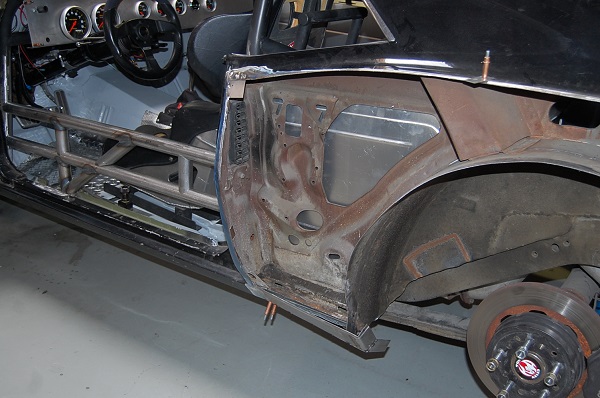

Right now im working on the rear inner wheel house structure and i'll post up a bunch of pictures when im done. If I planned it right it will support the quarter skin fully making it easy to remove or replace.
The thing that is taking the most time is trying to tip toe around old repairs and rust damage around the tailpanel. It should be replaced but we have a track event to make in May. That's a can of worms to be left be for now.

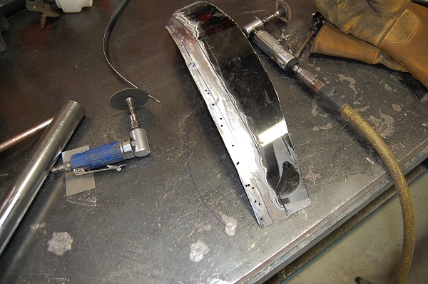

Just a few pictures of the rear quarter work. The 335 19's take up a bunch of real estate. I pulled the front of the quarter then will conture the rocker to help direct the air around the tire. Also close up the gap a bit too.
I actually recycled the curved section of the old quarter panel that I cut off and used it as a flange to keep the new skin flush. Worked out great. It was clean so I tried it. Tacked it in and fit the new skin.

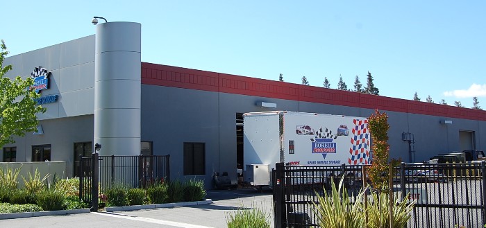

thanks guys, right now its a Borelli Motor Sports getting a Dyno and alignment check.
This place is amazing. This is what my shop wants to be when it grows up.
As soon as I get my bearings i'll update the updates...we are still staying dark till then.

That place is legit. They bring out the heavy hittin entourage to the track too.... makes Weld's rig look like a Mini Cooper.
