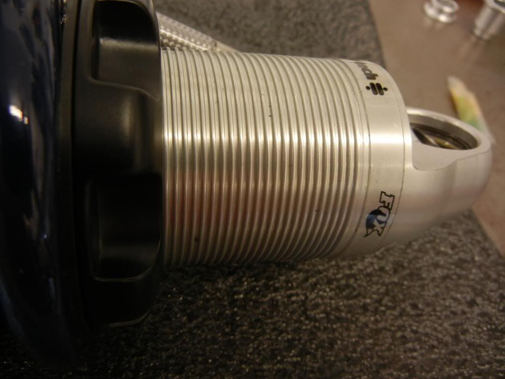

What sealed the deal though was the addition to Ridetech's offerings of a true 3-way adjustable damper. Developed in partnership with Fox Racing these are truly top notch pieces. In a former career I worked closely with engineers at Fox on development of a number of bicycle suspension dampers and I'm well aware of the depth of their experience, the talent of their engineering staff and the resources they can employ to develop a solution to a unique challenge. If you aren't aware (you probably are) Fox in addition to being a leading supplier of motorcycle, bicycle and snowmobile suspension is among the leaders in developing cutting edge off-road truck dampers as well. With data and creativity coming from those various areas of expertise and the knowledge and resources available I had no doubt that the solution to be co-developed with Fox and Ridetech would be a good one. The results found on James car proved out that assumption and I was sold.

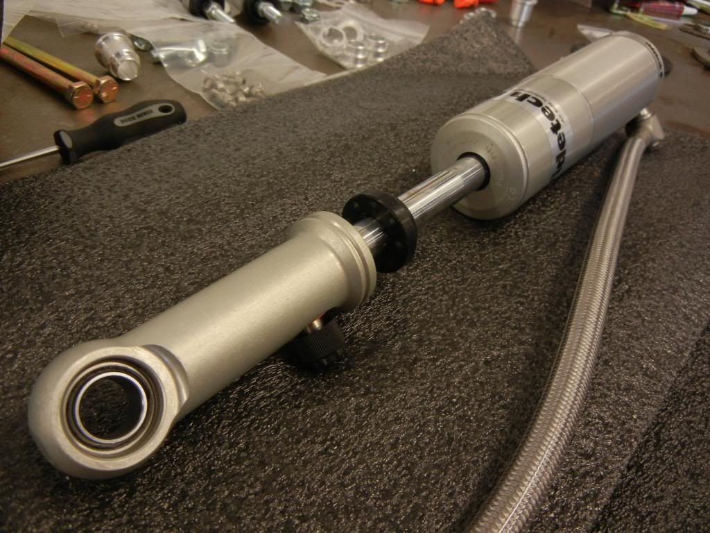

The second thing that struck me was how bloody nice the machining and fitment of the parts was.
The attention to detail on this stuff is apparent. The install kit for the shocks comes with a variety of bushings that will allow fitment to darn near any application.
....darn near. Because the Chicane coilover mount has one shock mount stub permanently affixed I had to machine my own bushing for one side. The means of doing so violated every safety discussion my HS shop teacher ever had and I shant disclose it here. It wasn't particularly difficult....it was just unsafe. It'd have been easier, and safer, with a proper lathe or mill...but I have neither. At any rate between RT's supplied parts and a bit of ingenuity (cough) I made it work.
The spring perch and pre-load collars fit perfectly and adjustments are buttery smooth given the precision machining of the shock bodies.
...and the shocks come with top notch springs from Hyperco. Tough to beat those. I'm starting with baseline rates of 700 front and 300 rear and as I'm sure you noticed in previous posts, I used the RT shocks in the rear as well....

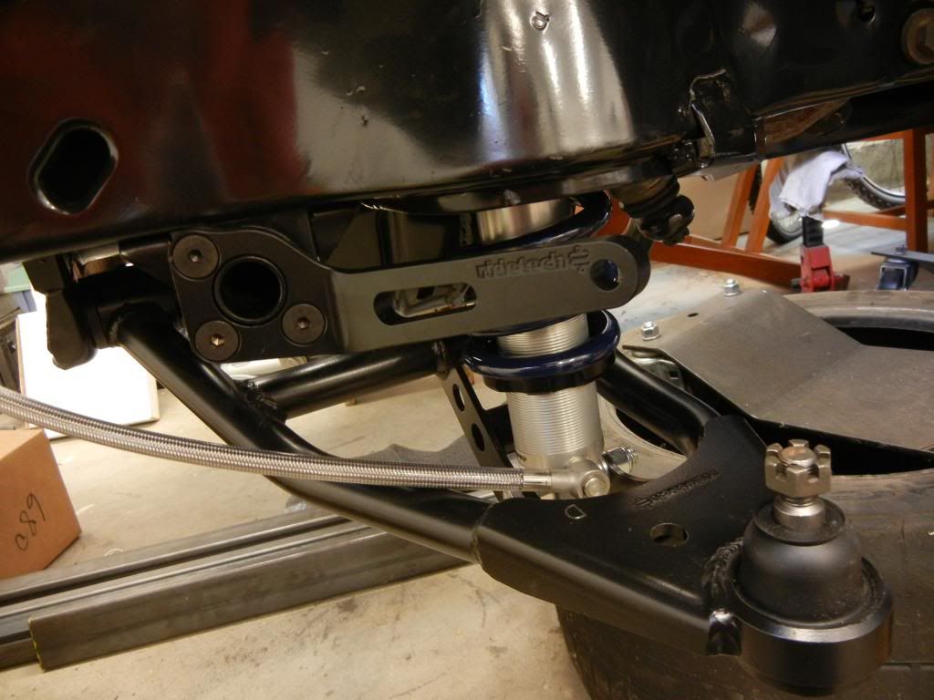

Next item up was RT's front sway bar assembly. Again, really superb machining and excellent fit of all the parts. Absolutely no effort on my part required to get stuff to fit. Everything went in just right, the first time w/o any form of modification needed. Given the variations in production tolerances on 40+ year old cars this is kinda astonishing.

The control arms are just really burly pieces. I regret that I didn't take any pics of them prior to assembly so here are a couple from RT's website:
The lowers equipped with delerin bushings are built like a bridge abutment and fit perfectly into the spring pockets.
The uppers, also delerin equipped, feature a clever means of adjusting caster. Rather than stacking up a crapload of shims to get to the caster setting you desire, the RT cross shaft is milled out to accept one of three slugs that are centered or offset to the front or rear. This provides for three much smaller adjustment ranges for caster w/o a cludgey stack of shims.
[Note: I do in fact have a crapload of shims there. Seemed like the best place to put them so I didn't lose them before I got the car back on the ground and can do a rough alignment.]
