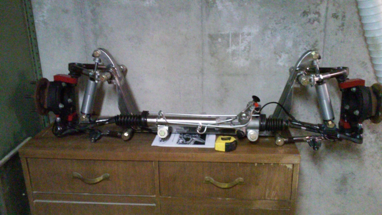

Not much in the way of hands on, but I have been stocking up on parts. I had to design my own spindle so that I can use the massive (15") SRT front brakes on a Mustang 2 type front suspension. Scotts Hot Rod shop did a great job fabricating the IFS for my Dodge.

I purchased a 4 Bar rear suspension from No Limit.
