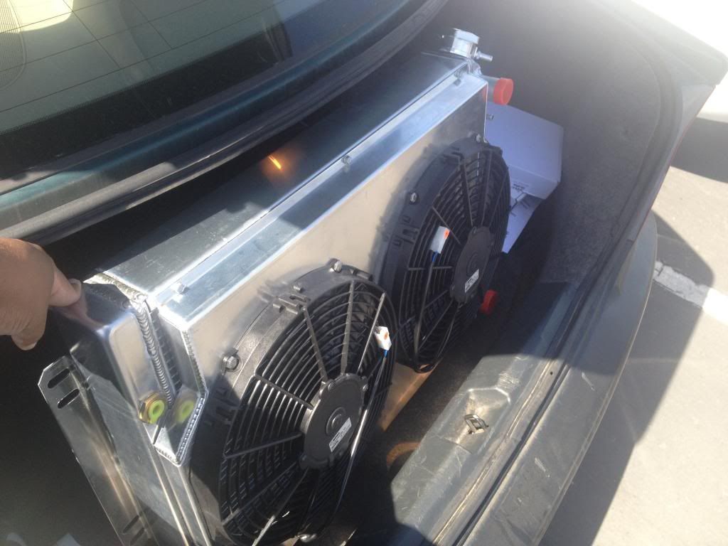

I got my Griffin setup in the mail today. This Project should pick up steam as i am now at the front of the shop

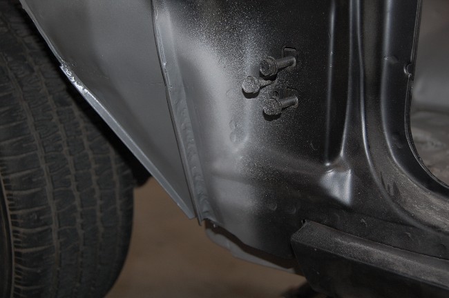

tulip rust damage repair.
made two filller pieces from 18 ga, bend here, trim here, cut there then welded in,primed and ready for black base paint then seam sealer.
