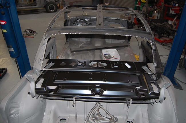

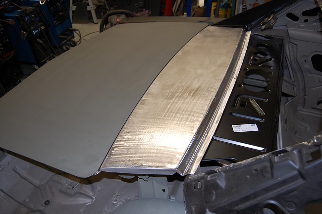

rust repair continues...front dash filler replacement.
Cowl panel installed during process to ensure proper location.

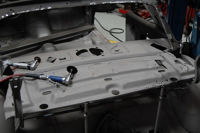

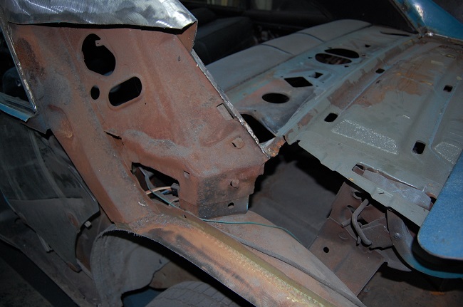

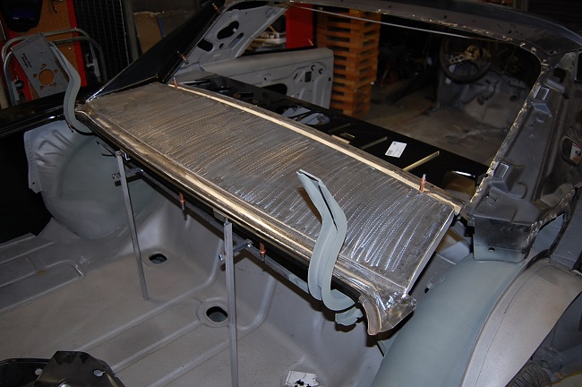

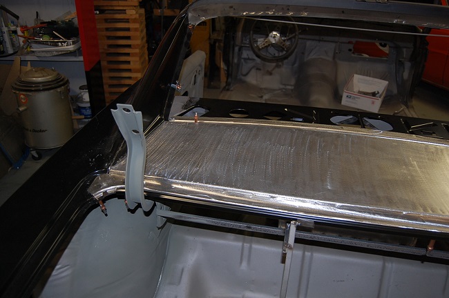

thanks guys....one of the reasons why this project sat idle for so long... the package tray damage. As soon as I sold the car...it was released by AMD. My luck.
Before and cut out and trial fit. fits pretty good.

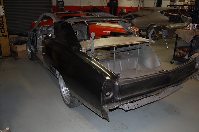

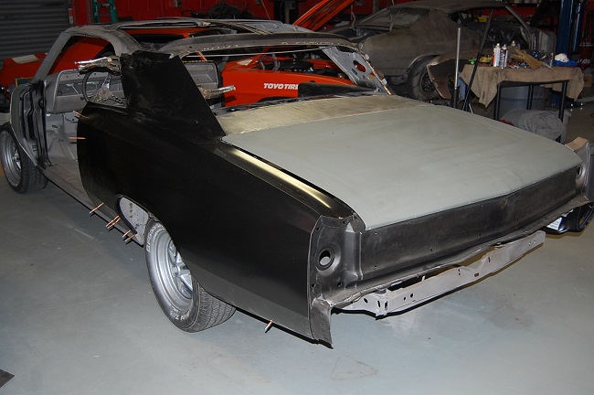

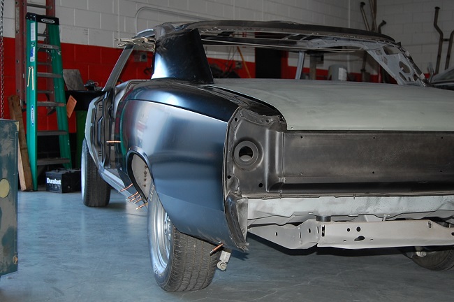

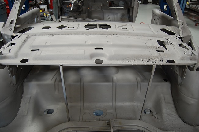

now that the center is where it needs to be its on to the sides. Starting with the tubs and quarter panel fitting.
The outer wheel houses and trunk filler were pushed out from stock. 1 3/4" at its widest spot. Then I will modify the quarter panel to fit. Here you can see how much more room it opened up.
I decided not to flare the rocker. I think it will be enough to fit the 315 easily.
