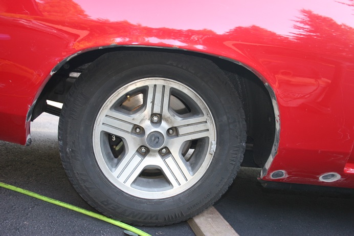

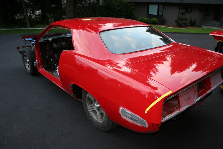

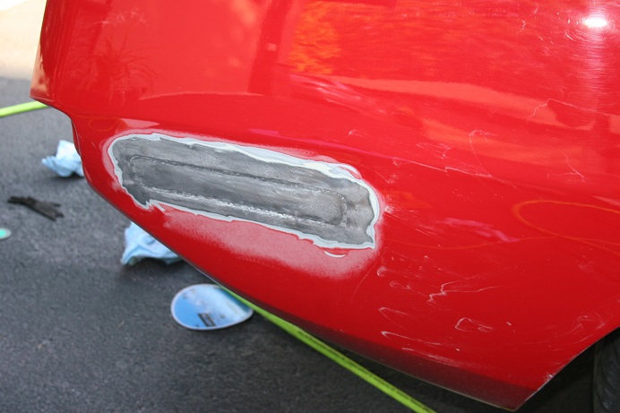

The car is quite straight Im going to finetune it (sharpen up the bodylines) and clean up the areas I showed you. I also tig welded the all the old moulding holes up relocated the truck lock and filled in the reflectors here some pics :
The the car was completely blasted when it was painted red as you see it has only a few layers ,skimcoat, primer paint a fantastic base i think with no need to strip this car in my mind unnecessary and unwarranted.
