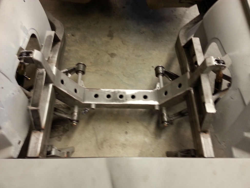

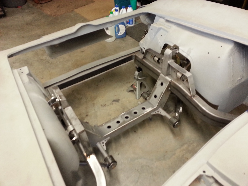

Default jydracing 63 Split Window Corvette

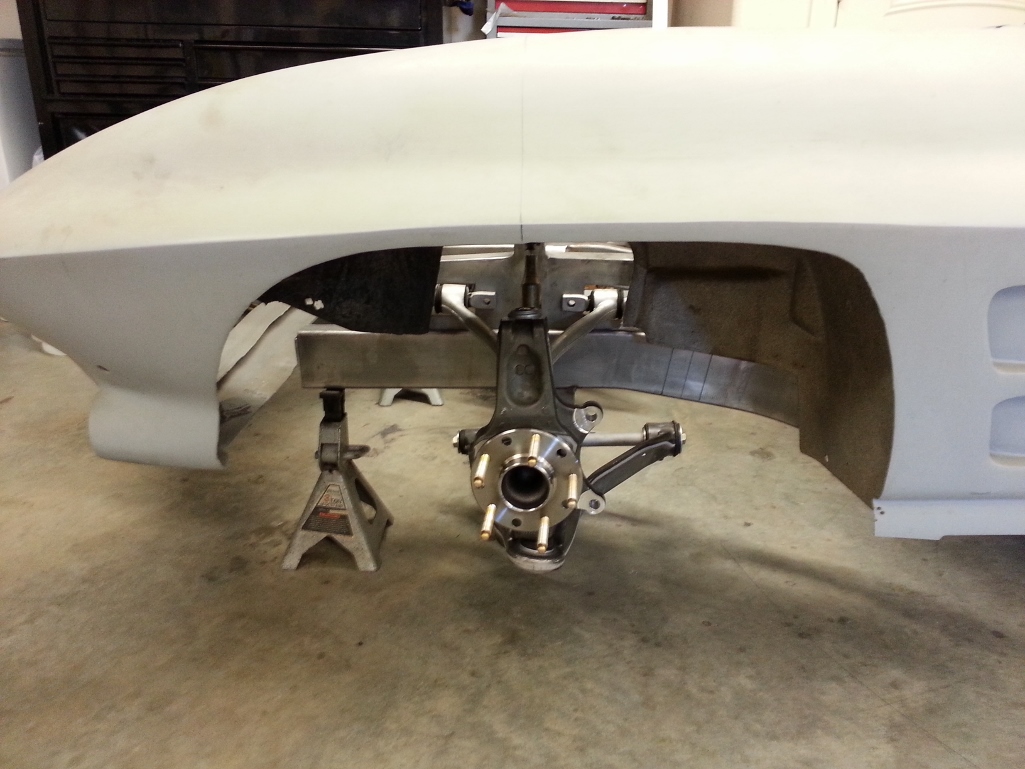

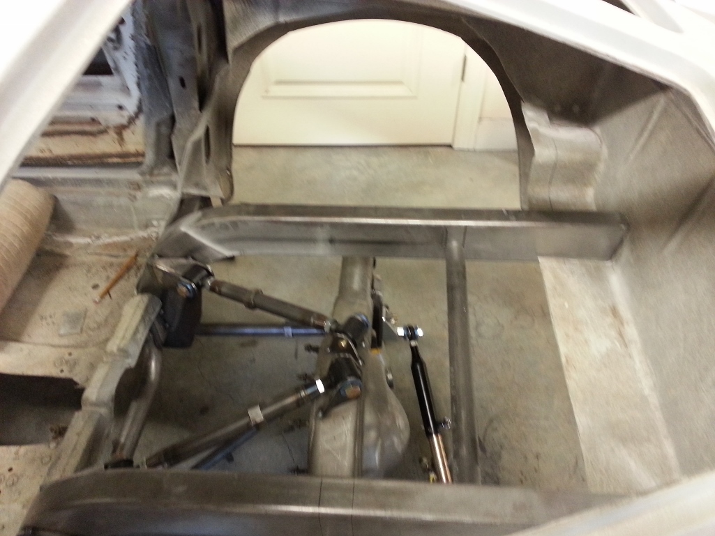

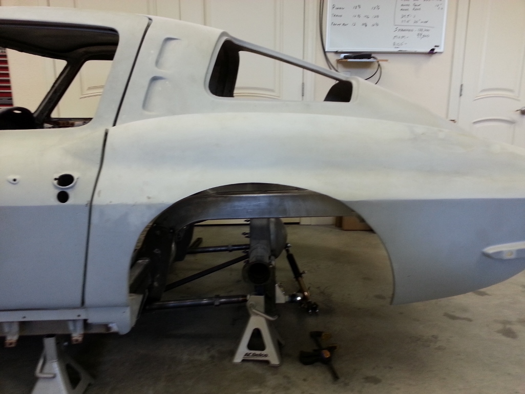

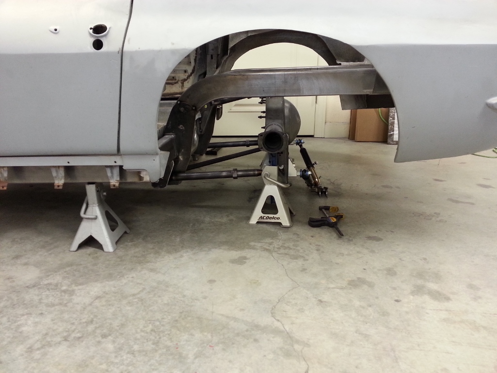

Spent today setting the body on the frame to see if my frame design will fit the body,,,or vise versa..... I think I got lucky!!!!!!

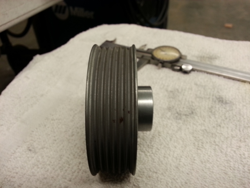

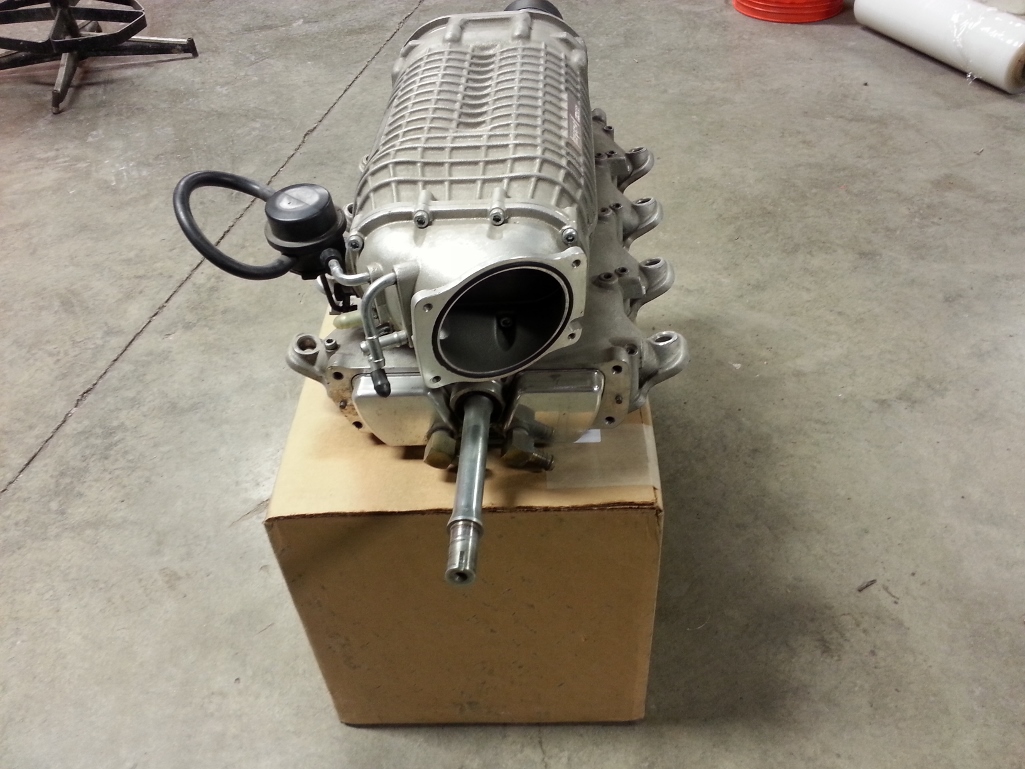

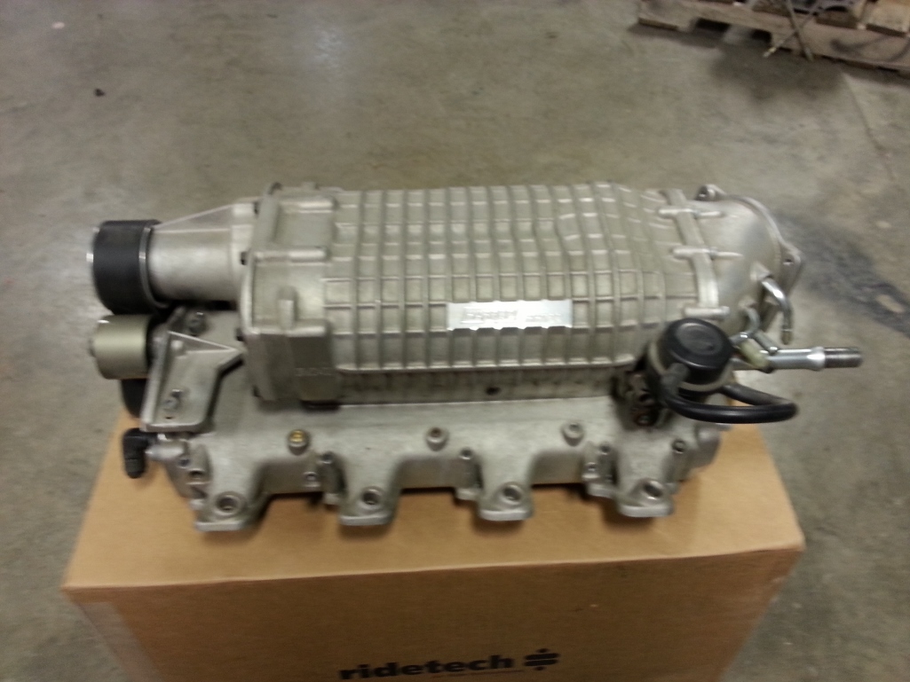

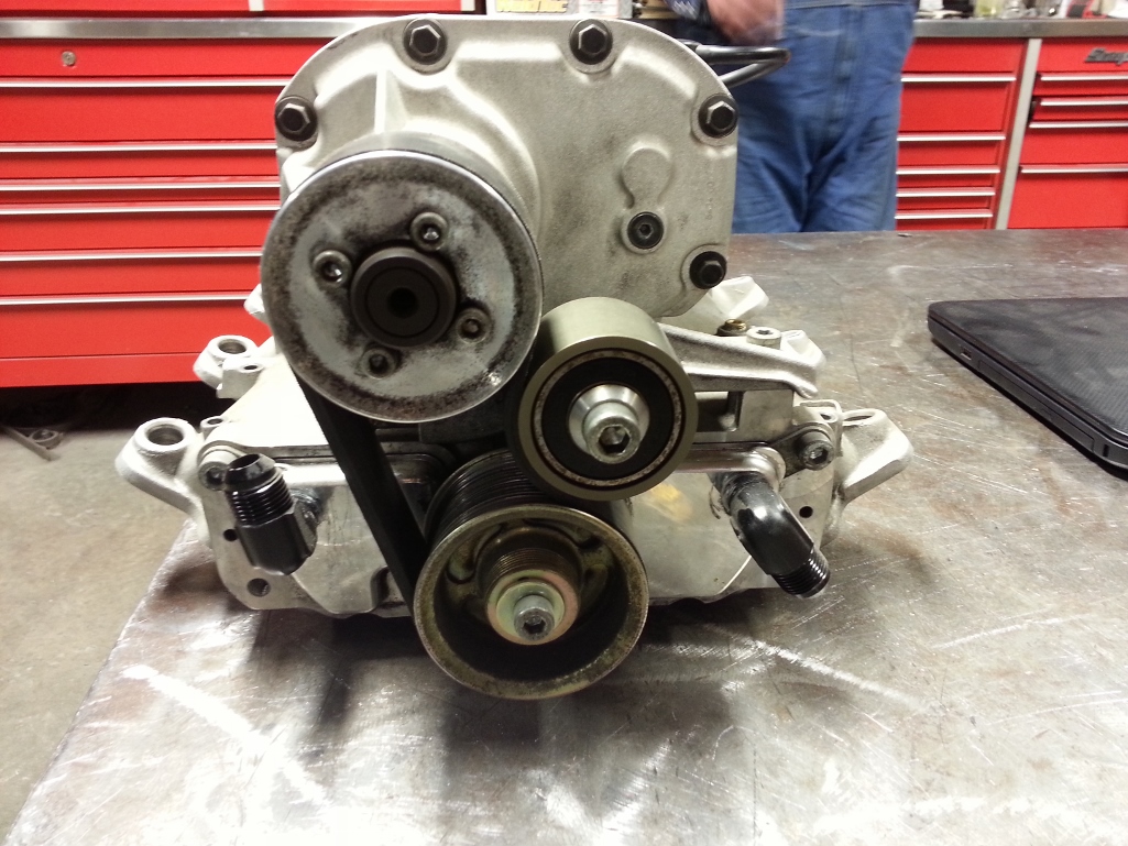

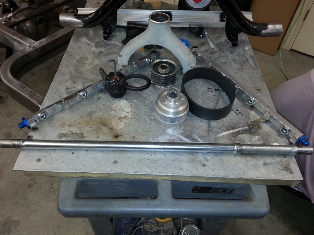

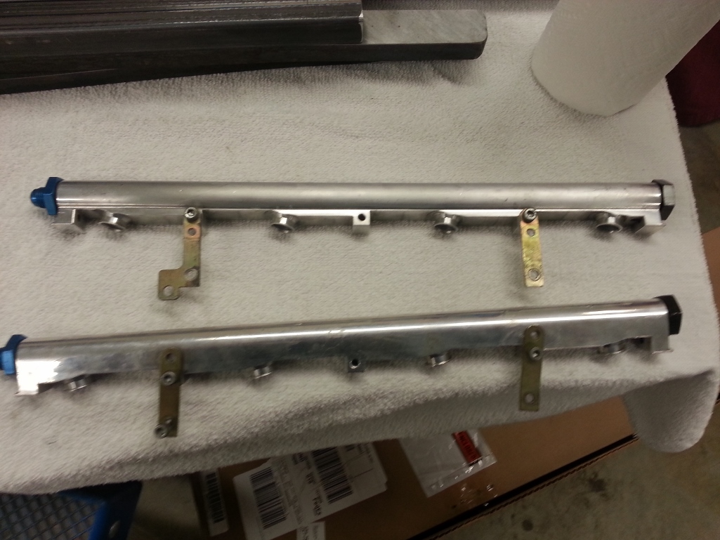

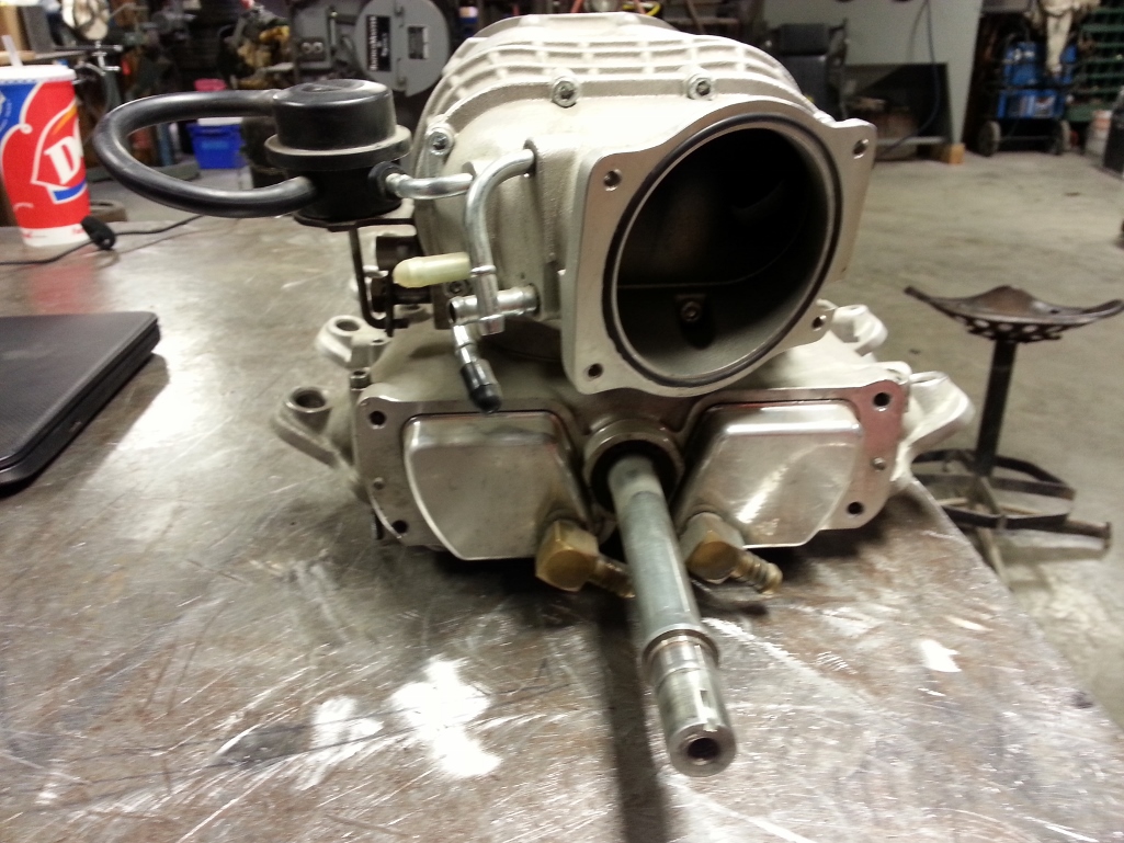

I decided to add a little more horse power to my project. I purchased a Harrop HH122 supercharger. It supercharger was set up for LS-6, so I decided to change it over to work on a LS-3. I also decided to update the supercharger while I had it apart.Name:  20140108_160557 (1025x769).jpg

Default jydracing 63 split window

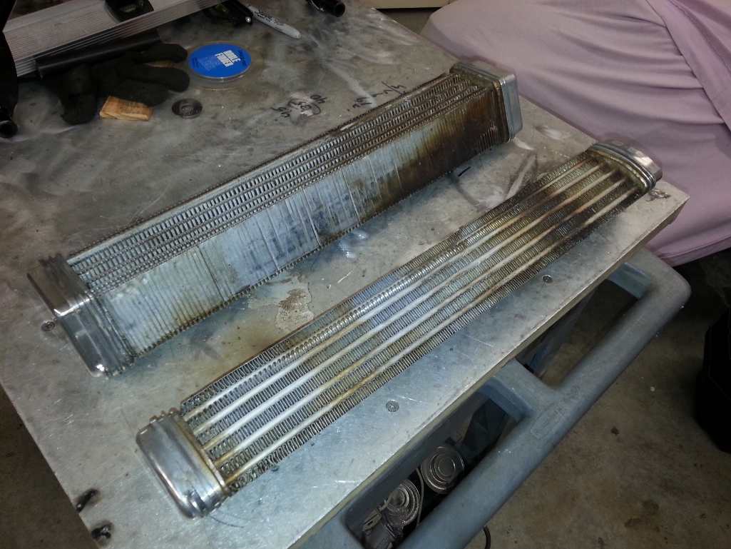

Had to take the supercharger apart, 1. separated the blower for the manifold, 2. take out the cooling radiators to clean and install new fittings, 3. Take all parts off of the superchargers, and replace, 4. take rotors out, check for damage, (none), 5. check for clearance, new bearings, put back together, check clearances again, 6. replace all external bearings, 7. replace all O-rings and seals, 8, put blower and manifold, (the new LS-3 manifold), back together,,,,,done
