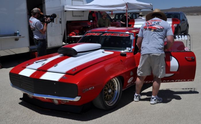

Also... I been working on some other upgrades to the car recently. I'm building a new larger spoiler with a splitter similar to the one shown here on "Big Red".
The spoiler comes back around the side (hard to see in the pic)
I've been wanting to improve the aerodynamics on the car so this is a start... I like the looks of this design.
