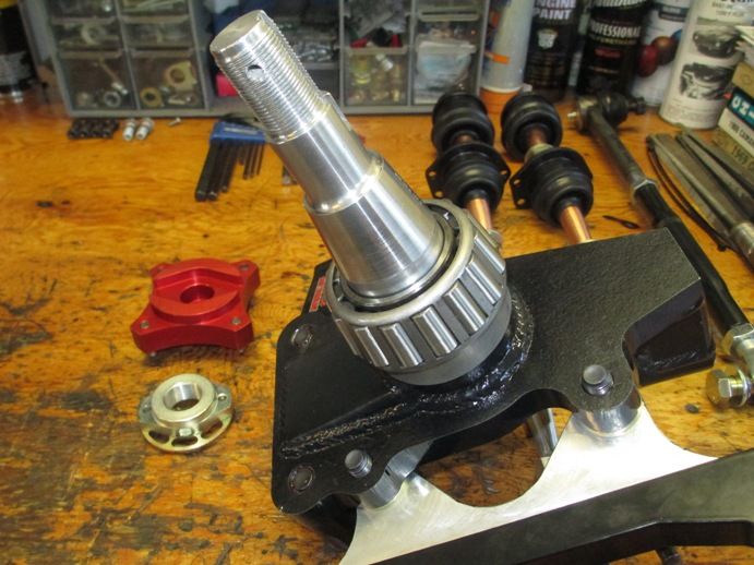

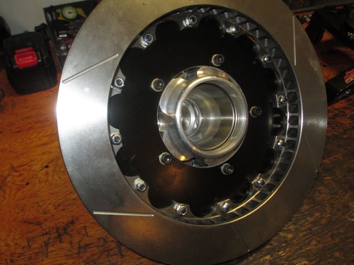

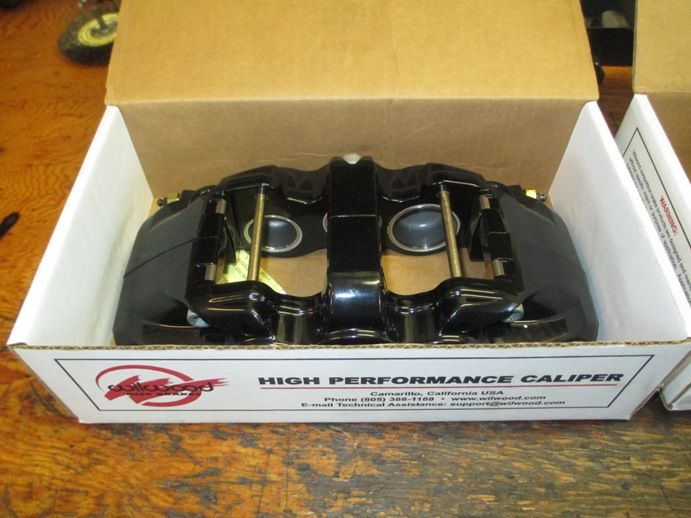

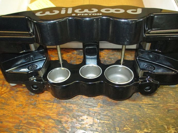

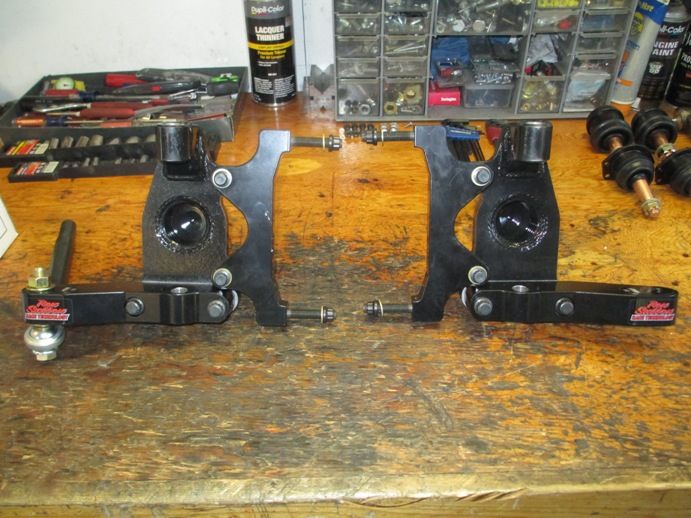

looking good. thats some serious shheet right there. I think Gaetano's dreams were just shattered. LOL
Originally Posted by Track Junky View Post
Was wondering when you were going to turn up. That's some stout hardware. Looking forward to seeing it come together.
Lookn great Dale!!
Originally Posted by rickpaw View Post
Looking forward to hear how the new parts work out.
Tu
Thanks guys... appreciate the comments!
