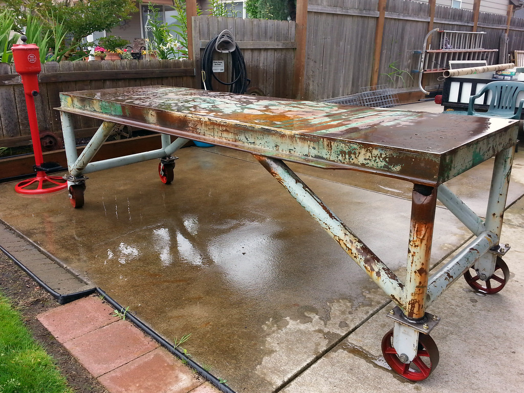

nice score and nice save, wheels are perfect, I like the patina, I'd be calling that piece done JMHO.
Started back on it at 6 a.m. sanding the deck with a 5" DA and 60 grit paper to knock down the surface rust and paint build up, paint was thick in spots so sprayed it with Talstrip paint remover which didn't get it all but improved the patina IMO.
One more light sanding and rinse then run a thread chaser through all the fixturing mount holes and I'm good to go!
Those casters made the table and they appear to be very tight, once thoroughly cleaned and greased it'll need a leash. I'm going to design some sort of stabilising feet for the swivel end to secure and level it. Visualizing a bar with adjustable feet, guide tracks at both ends and a screw jack in the center......open to ideas!

I don't imagine that table flexes much, do all four wheels stay on the floor pretty well? Anyway to put locks on the wheels to keep the table from rolling once in place? And what all are you going to mount on the table permanently, like vises, drill presses, grinders and such?
I dig it, I'd jump on a deal like that in a heartbeat. Great work table.
