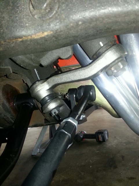

Here is a photo of them installed and the clearance by the pitman arm and drag link..This is the area to be concerned with.

Perfect! Just ordered mine. Thanks again.
