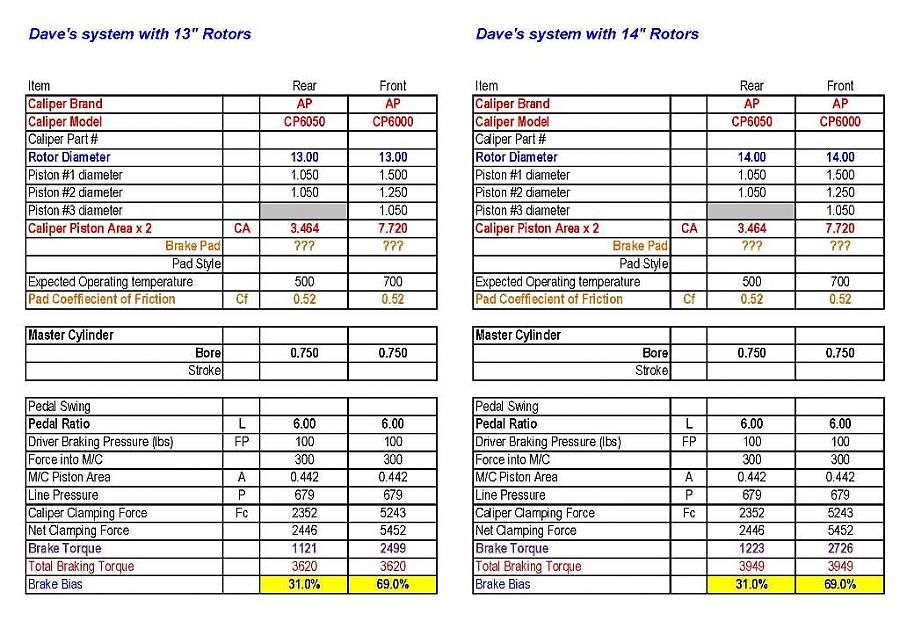

Ron, you should have Mr Sutton work up one of these charts for you:

Its funny Dave, I always was of the mind set that the rear had a fair amount less pressure then the front. If you think about it, if you run 3/4" masters front and rear, no matter what, the pressures should be the same front to back if the bias adjuster is in the middle. Clamping force may be different due to piston size, etc., but pressures should be the same.
If you look at Ron's chart, pressures are the same front to rear. I think getting it sized close then doing the temp check is really the best way.
No matter what it should be, my 2100F/400R is wrong. The rear bias adjuster is full open, my 7/8" master should have been in the ball park.

For what it's worth -- my Mustang had TOO MUCH rear brake -- and coming down the straight and getting into the brakes at speed started the rear hopping and skipping -- which then made it loose and nasty.
Ron (Sutton) started dialing out bias and it got SO MUCH BETTER... but we still had too much rear brake -- so now we've mixed up the compounds to see how that's going to work.
