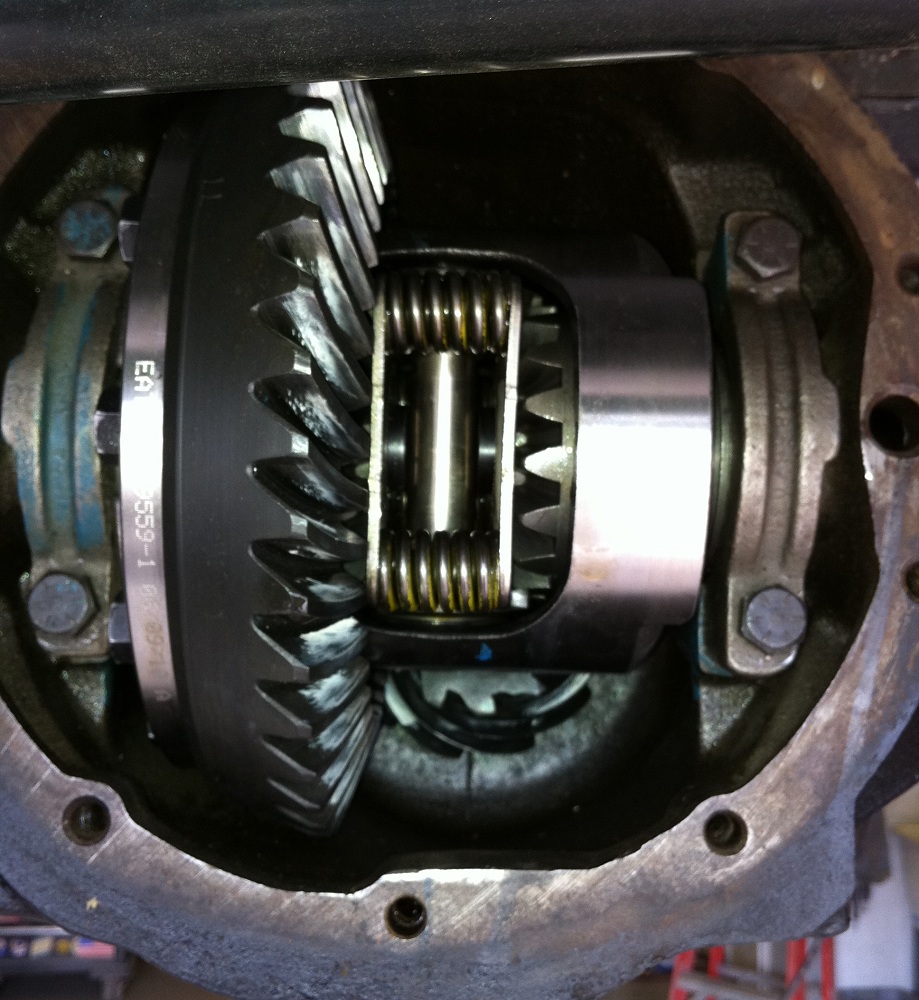

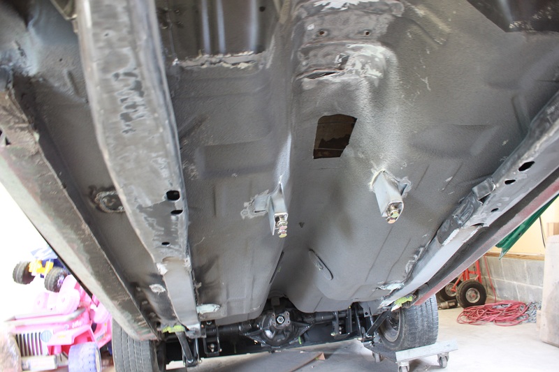

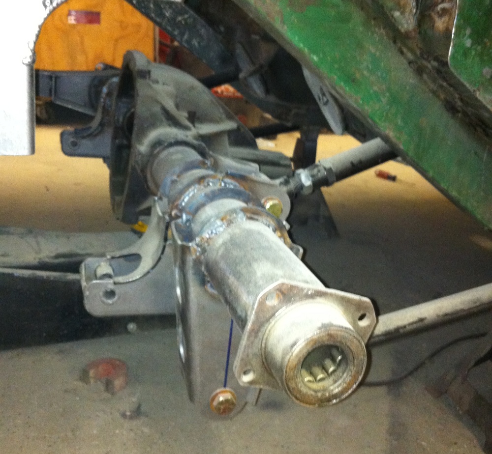

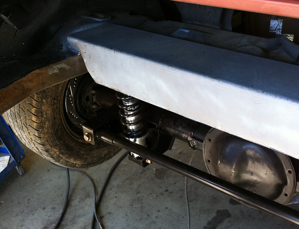

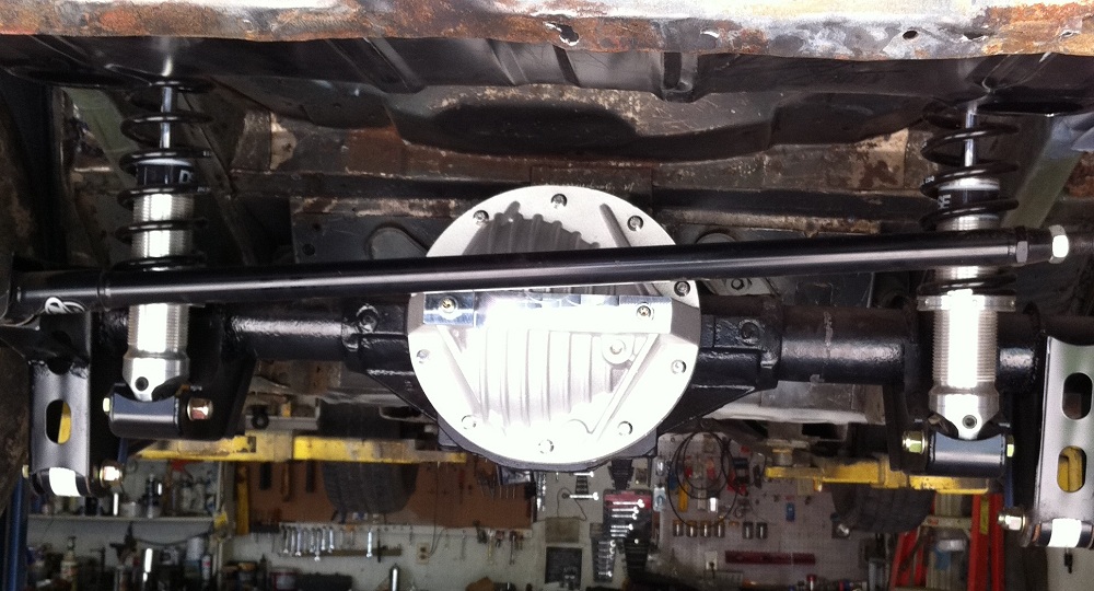

Now since I found out I had an 8.5 I would use it. Before I got this rear end my daily driver a 04 silverado's rear came apart. I put an eaton posi in it, but I didn't like in the truck. So found out that eaton posi will fit in a 8.5 if you change the carrier bearings and its 30 spline.

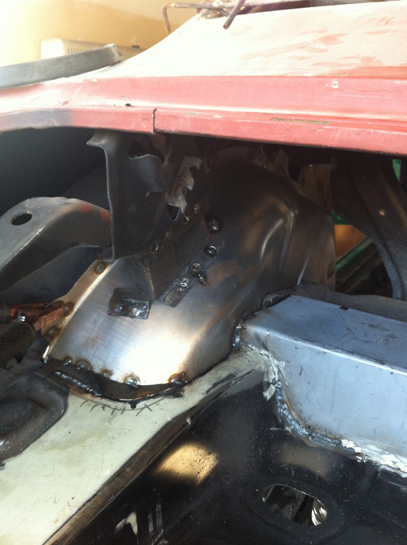

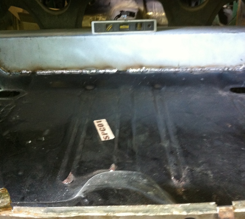

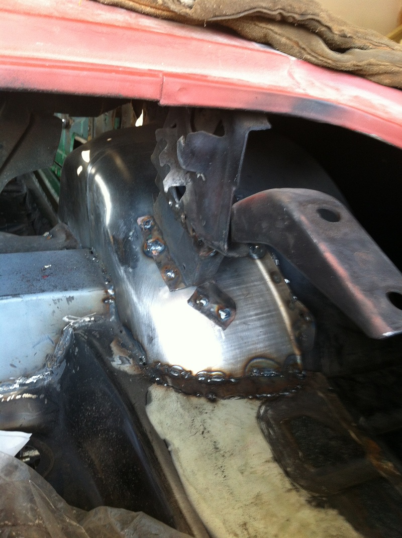

New trunk floors and deep tubs.

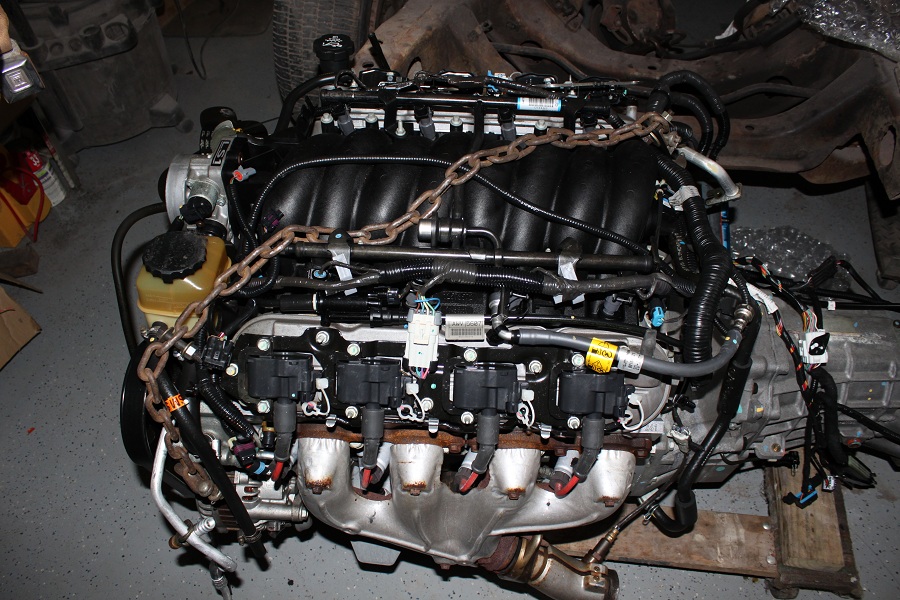

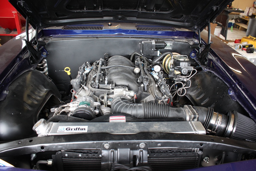

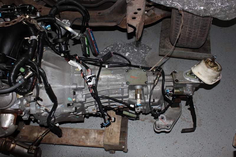

I found this engine and trans out of an 04 GTO it only had 20K mi.

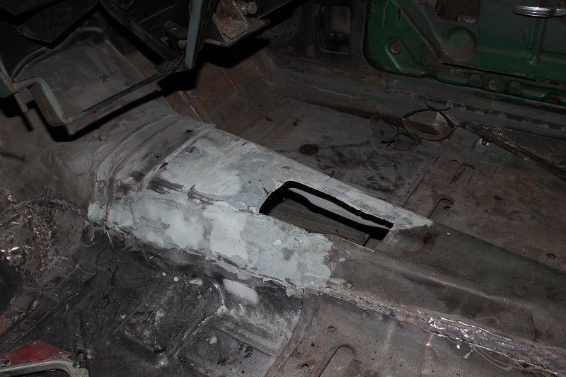

I had to take a big hammer to the trans tunnel to get this thing to fit

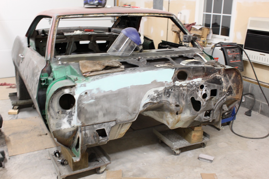

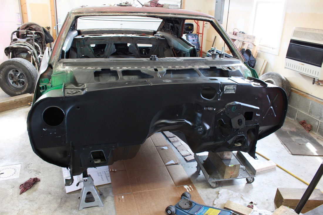

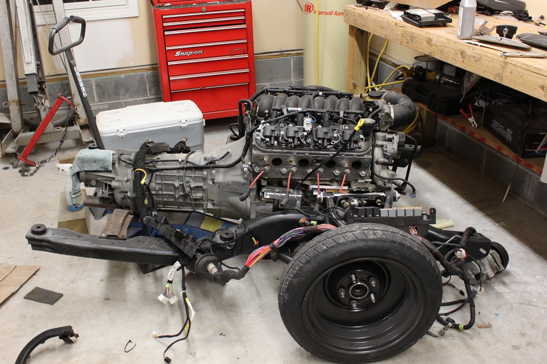

This is about 2 years into the build. It was fun back then.

I don't have a rotisserie, it would have made it easier. I just don't have the room.

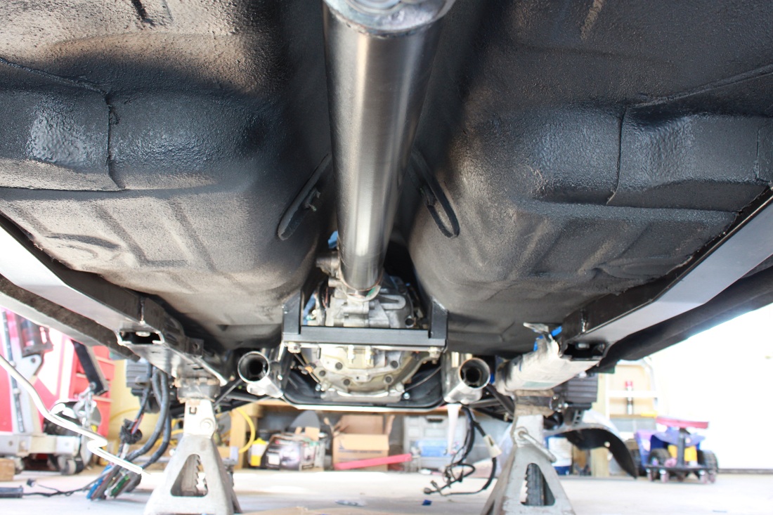

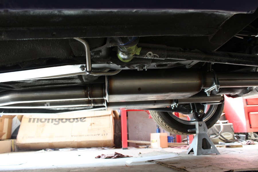

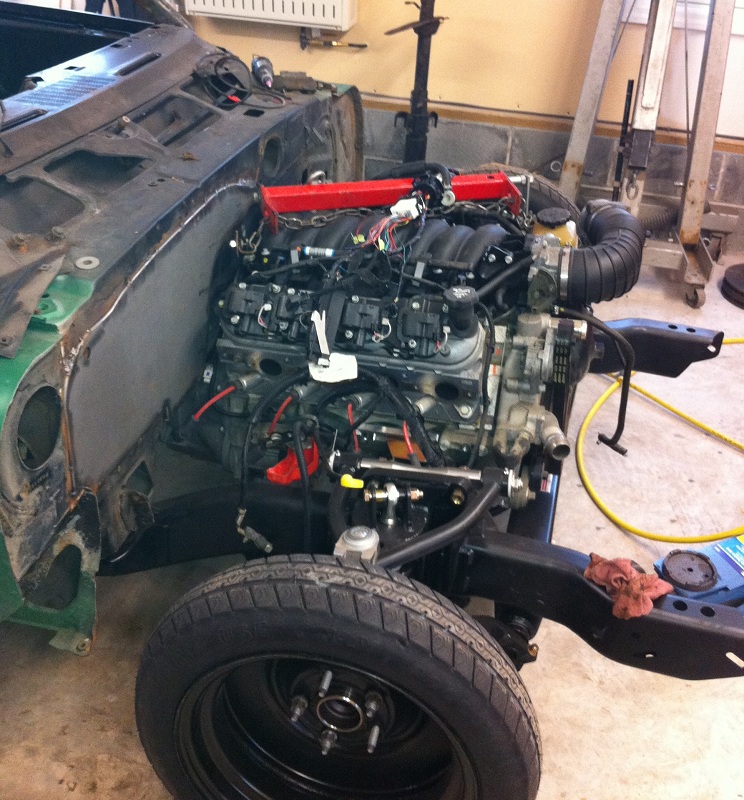

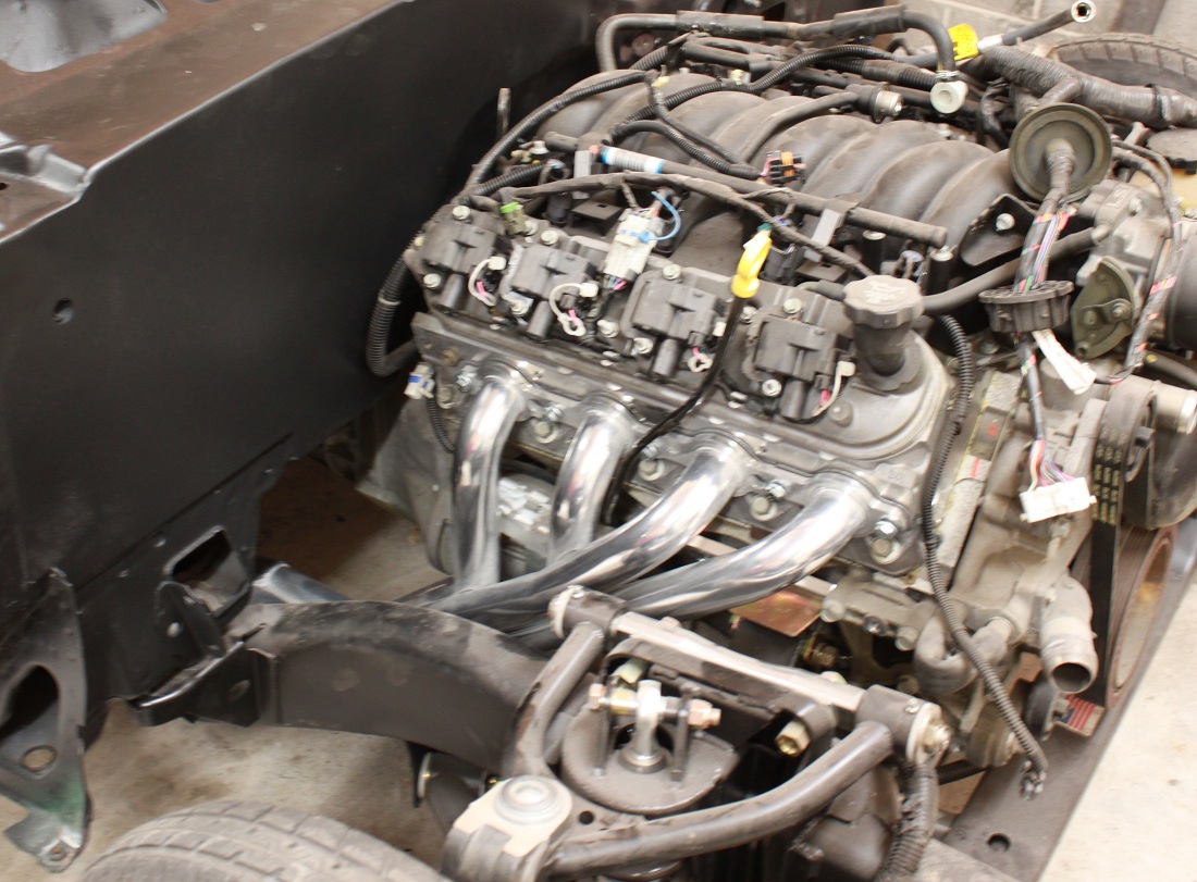

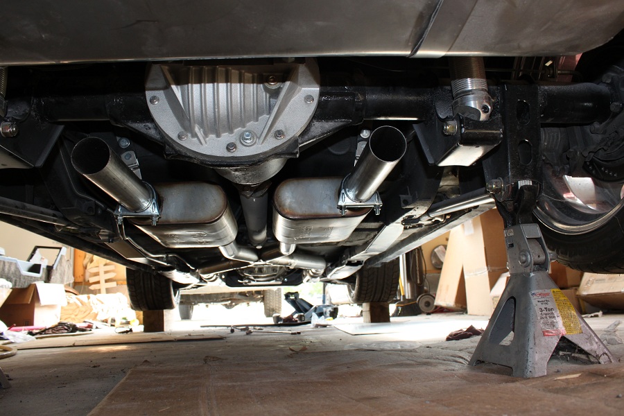

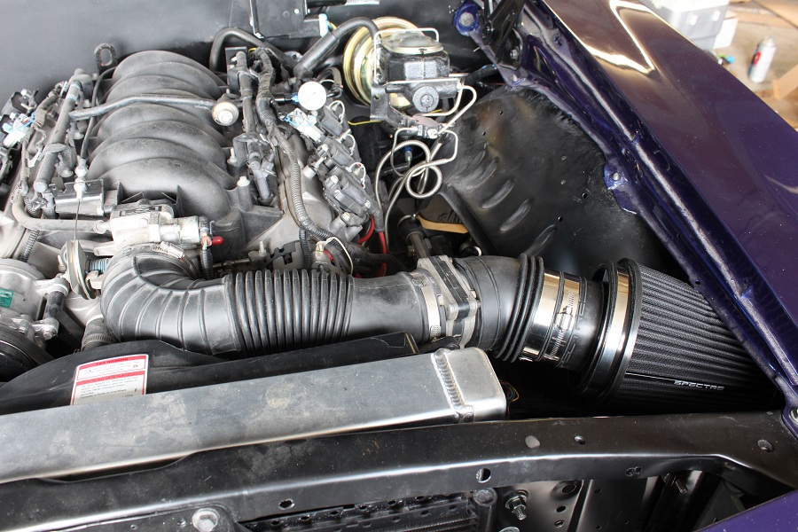

I actually got something done on the car and have new pictures. I ordered a cold air intake put it on and hated it. So I took it apart and used most of the stock GTO stuff. One thing it put the MAF way to close to the throttle body. I also put some of the exhuast on. I need to get tail pipes on, but I can't find anyone willing to touch it. One guy told me he would try, but it would be like $4000 and look like sh#@.
