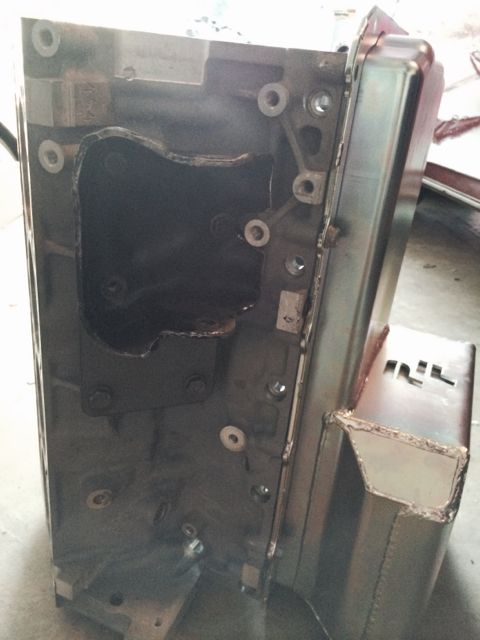

I've made a little bit of progress on the car but am still waiting on a few more parts.

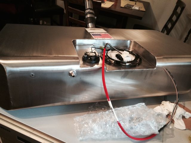

I decided to go with a vaporware tank with a ZL1 pump. The guys at Ricks did a great job and were terrific to work with.

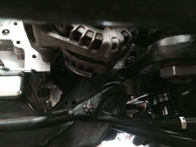

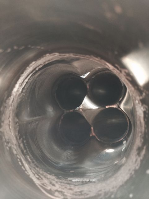

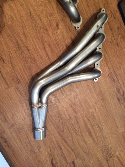

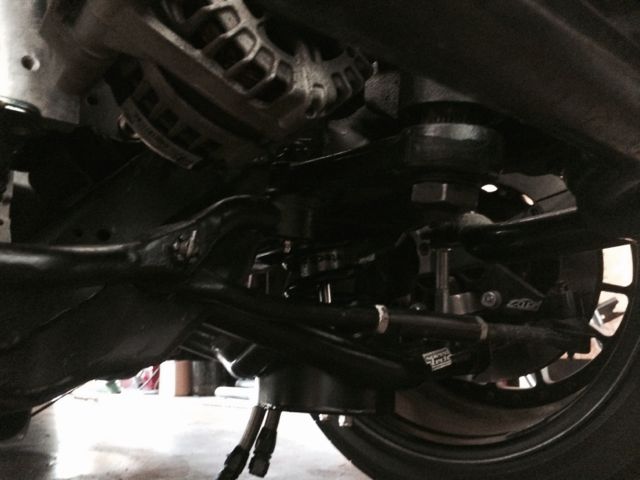

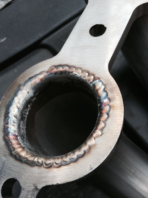

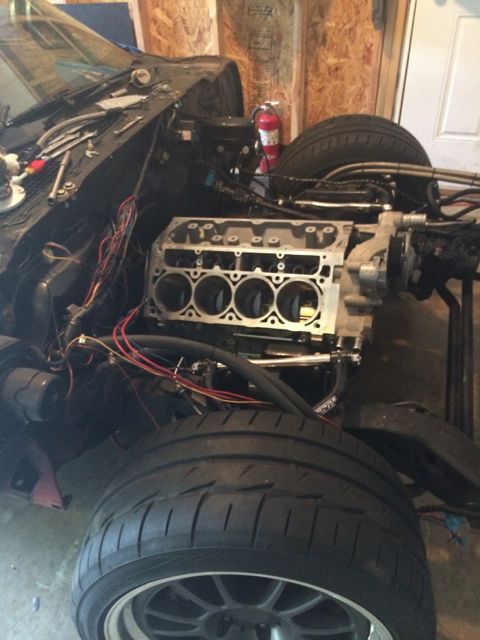

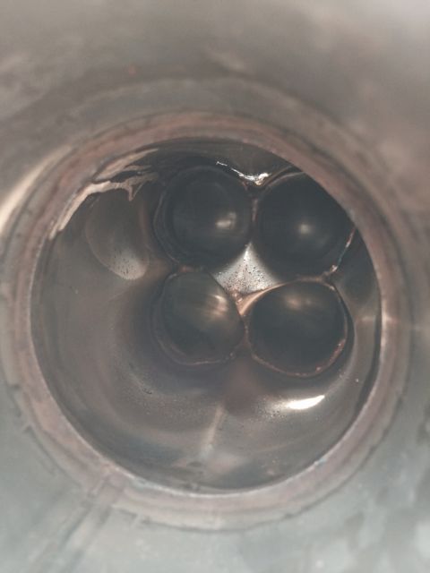

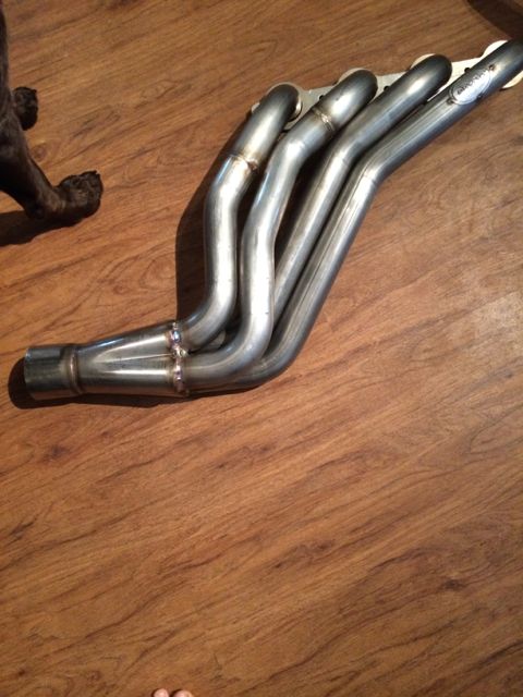

I also received my SW headers. In general these are nice but there were a few things I noticed could have been improved. At the collector they pinched the tubes down and did not clean up the inside. Also on the primaries they could have done a better job cleaning the area after the welding too. Nothing huge that a die grinder and some time couldn't fix. I did use the plates they sent and the fitting of the block with the clam shell mounts seems to be perfect. I never pulled the trans so it's in the exact position it was with the SBC. It bolted up pretty well, only needed to move maybe 1/2" which was simple.
I am very glad it is an aluminum block. It makes test fitting things soooooo much easier. Next thing I need to work out is the Alt/PS mounting. I want to place the alternator on the pass side below the water pump where the A/C compressor used to be. I also want the PS down fairly low on the driver side almost like the SC PS. I need to fab up some mounts when I find some time

Here is the factory 2010 Camaro mount with SW plates and Speedtech Pitman

I'm surprised at those headers --- you're spot on -- the weld quality - and in fact the mounting holes are not what I would expect. Sloppy!
