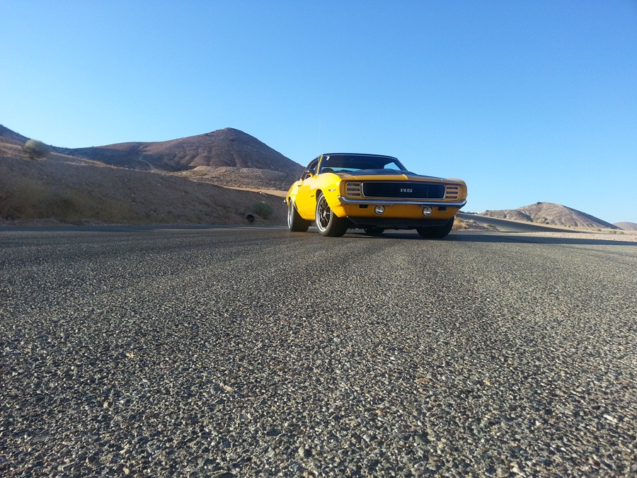

Bright and early Monday I jump in the car and head out to Willow Springs. I get there and am greeted by the staff and fill out paperwork and wait for the events to unfold. As the day progressed many pictures were taken, slalom was done as well as skid path. Most of the results were not reveled and even I will have to wait to see how it did..... rats!! The weather could have been better the first day. We were battered with wind all day which combined with the sun and the sand made for some red faces to say the least. By the end of the day I had met all of the manufactures and their crew that were there..... some cool people.

Glad you made it home okay! I didn't want to say to much in my thread but since you shared the carnage here I just wanted to say I have huge respect for you getting that car back on the track Tuesday! I'm impressed that not only were you still eager to have it beat on but even more that you came prepared with enough spares to rebuild your swaybar.
Hope to meet up with you at a track soon!
Oh and having been on the receiving end of a similar offer to help me get my car home recently it is humbling and amazing what a great group of folks there are in the car world.
EDIT: one more thing. Great pic in post 113!!
