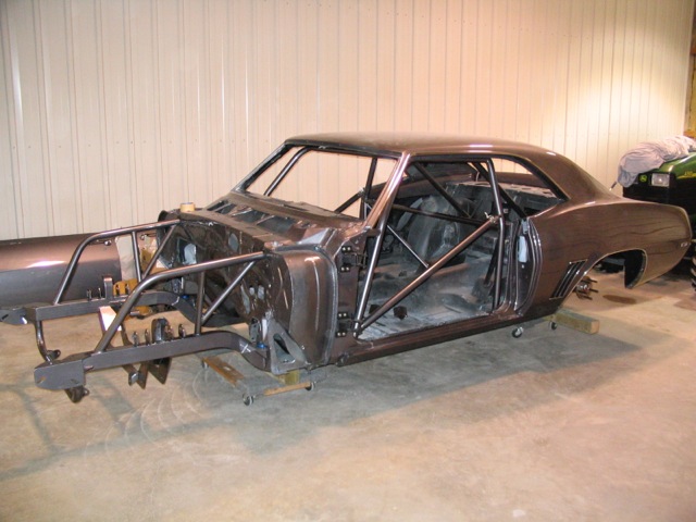

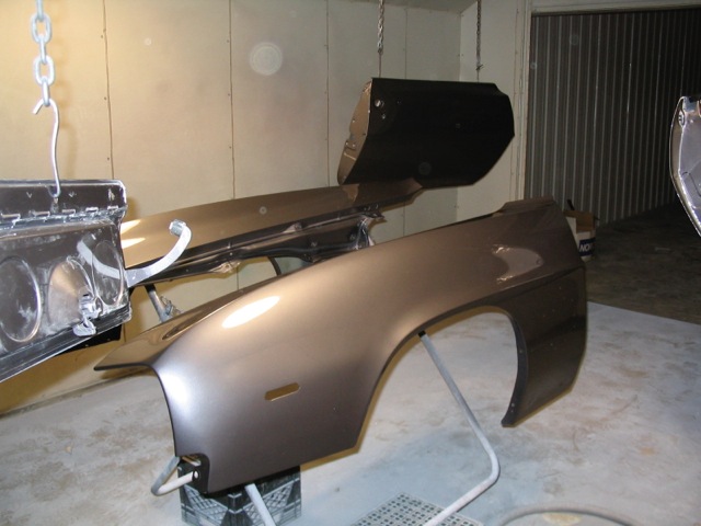

Thanks! It started out as BMW Space Grey metallic but after spraying a test panel we modified it with a touch extra black and purple so it turned out as a custom mix.

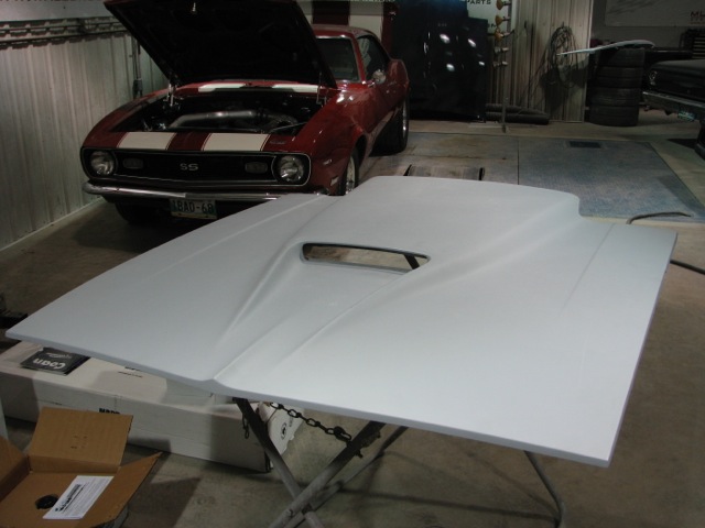

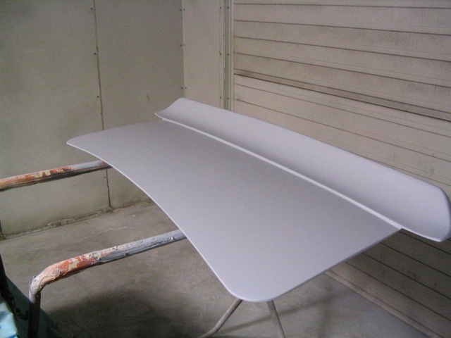

I have some more pics of paint and i wanted to try out the year one fiberglass hood and trunk lid. also the Marquez design lower valance as were going to run a nice big turbo and put the intercooler up front.

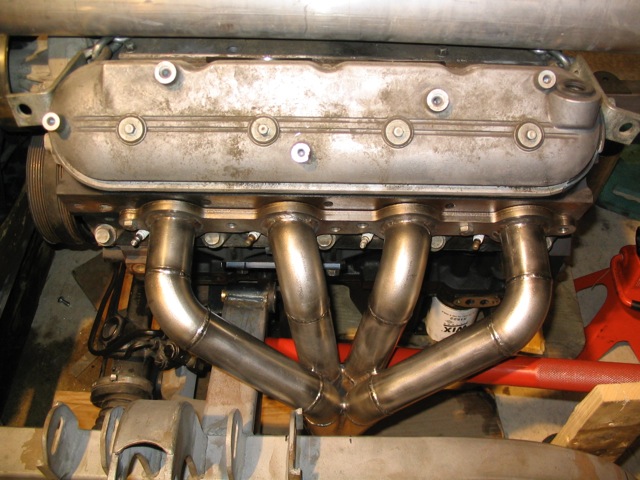

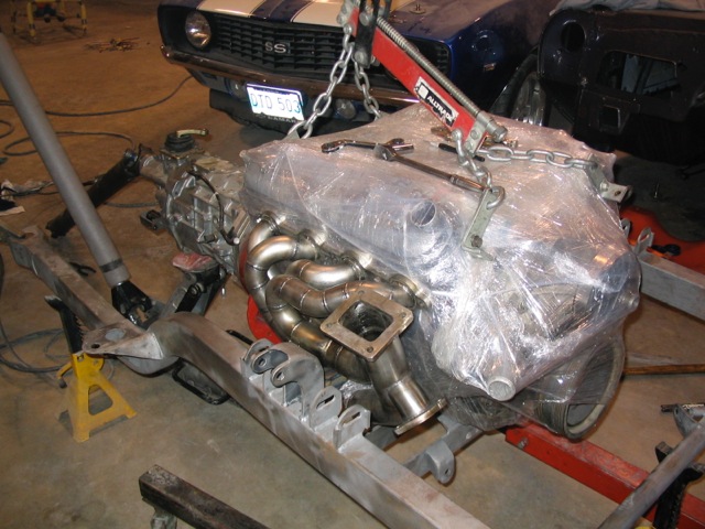

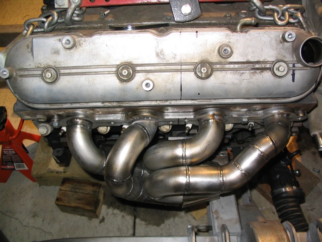

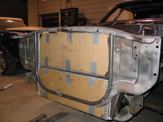

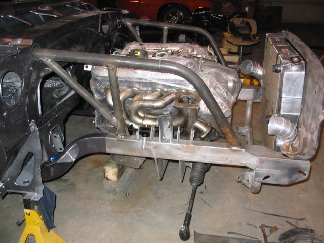

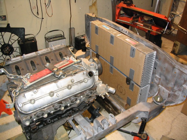

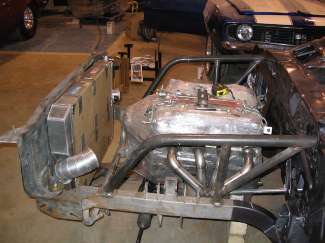

Heres some pics to show the front subframe. We wanted something light that would have a ton of clearance for the turbo exhaust. You will see our dirty mock up ls motor were using for now to build our stainless headers. The Radiator and intercooler is going to be a test as were basically splitting a semi intercooler and using the top half as a crossflow rad.

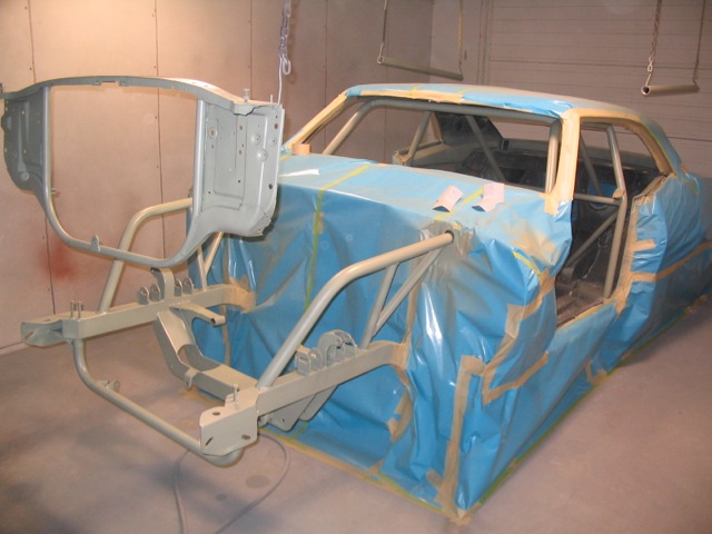

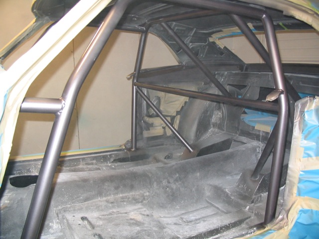

Time to paint cage and sub.
