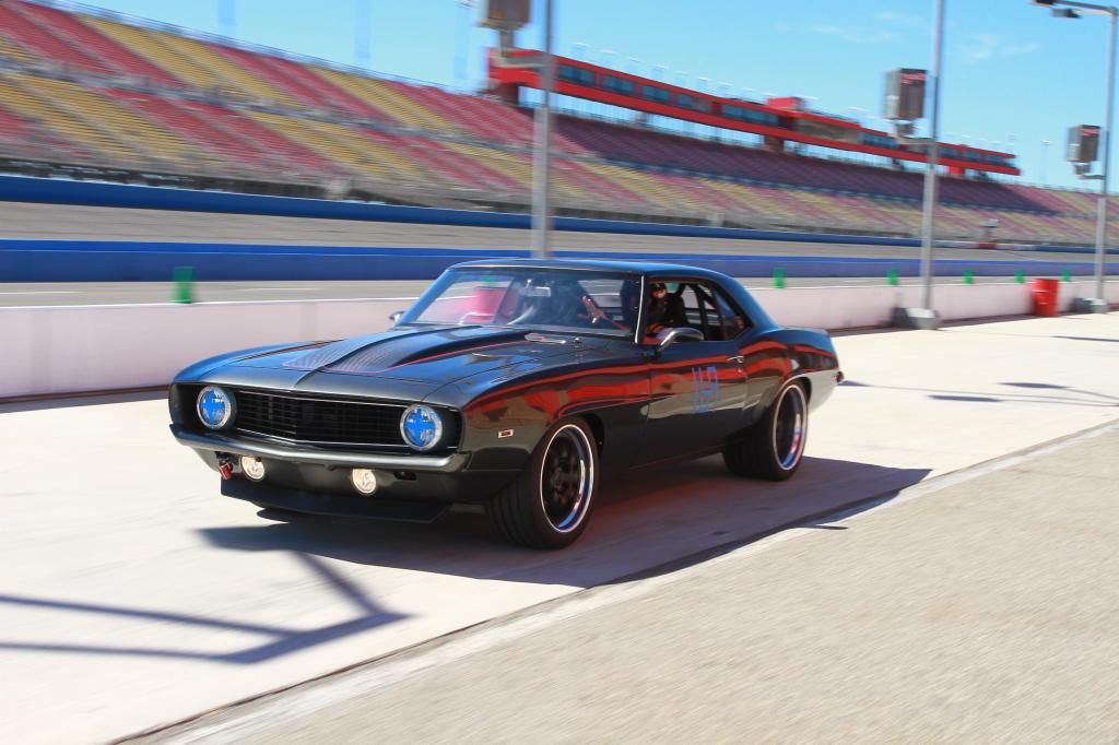

Some pics:
[/URL]

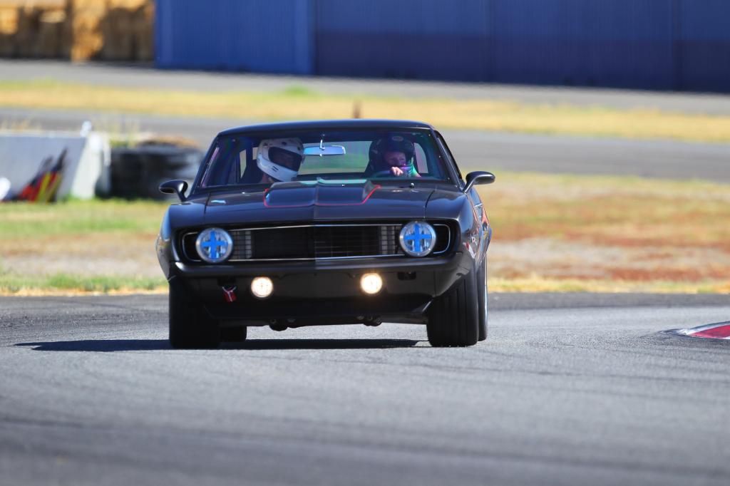

Originally Posted by Ron in SoCal View Post
From these photos, the car looks like it was tight/pushy in the middle of the tighter turns ... and therefore probably loose on the exits of those same turns.
Correct ?
Correct ?
Correct Ron. Turn in was fantastic, middle just a bit tight and just slightly loose on exit in very tight corners but completely controllable with the go pedal. I know there's a ways to go on tuning (I didn't change the shock settings once) but the car is much easier to drive as I was hoping it'd be and my goal was seat time and coming home safe.
