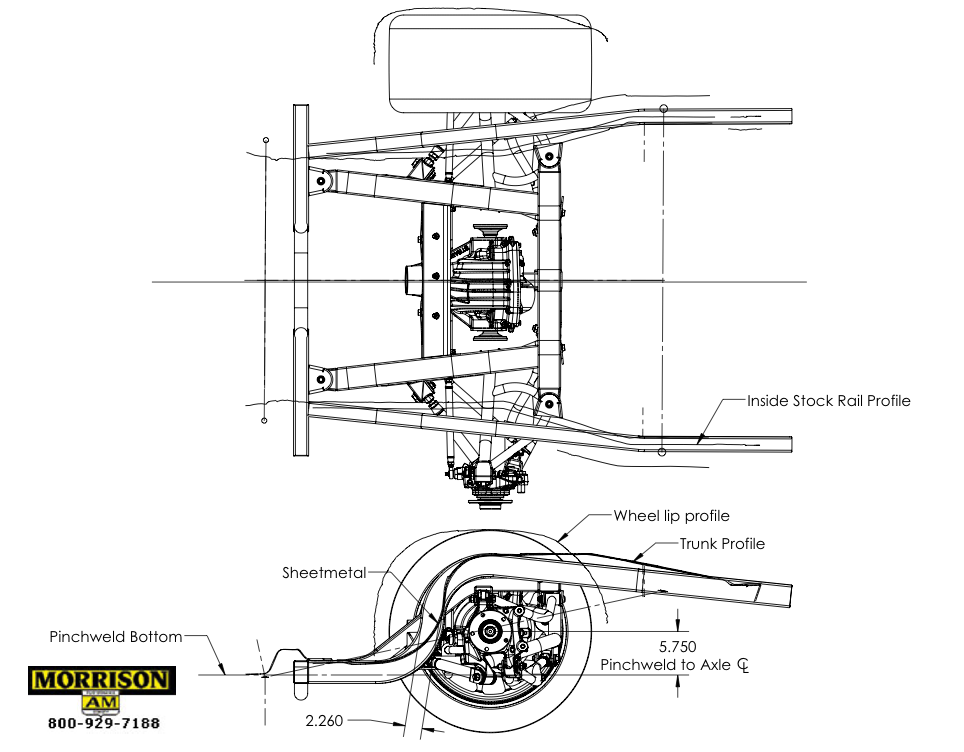

One option that was discussed with Art Morrison early on, was to replace the stock frame rails with first gen Camaro frame rails. I opted to retain the stock rails thinking it would be less work and less cutting of the car. Since it was a nicely finished car, I didn't want to do any more cutting than necessary.
Looking back on it, I would have come out with a better finished car if I had replaced the frame rails. The car would have been stronger and it took a lot of time to make up the plates and weld them in. One area that is tough to work on is where the stock frame rails turn upwards just ahead of the rear axle. There are factory overlapping flat plates welded to the floor there and they are sealed with a tar. Cutting or welding there is going to be tough because it will melt the tar and it'll burn. The frame rails would have to stick up into the car almost completely in that area. The area just ahead of what is marked "trunk profile" would need a little filler plating to support the trunk floor.

First gen frame rails in a second gen Camaro.
Looking back on it, I would have come out with a better finished car if I had replaced the frame rails. The car would have been stronger and it took a lot of time to make up the plates and weld them in. One area that is tough to work on is where the stock frame rails turn upwards just ahead of the rear axle. There are overlapping flat plates welded to the floor there and they are sealed with a tar. Cutting or welding there is going to be tough because it will melt the tar and it'll burn. The frame rails would have to stick up into the car almost completely in that area. The area just ahead of what is marked "trunk profile" would need a little filler plating to support the trunk floor.
David
Very interesting, thanks for the information.
We're doing a 5th Gen IRS in my 73 Camaro... well, I guess that's the Royal "we" as I am just driving it out to Scott Mock for him to do.
I like their lower adjustable control arms. I bought all DSE upper stuff, but can't find a 5th gen lower. I wonder if an an AME would fit it.
