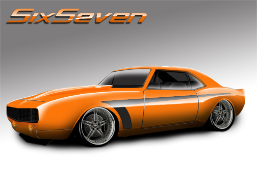

I wanted to post this and see what you guys think. This is my first attempt of doing a rendering. I know it is rough but any comments, suggestions, tips, or web links are greatly appreciated! I was a little hesitant to even post this because some of you guys have amazing talent. Any way let me know what you think.

Not bad, it looks very shiney! Overall the shading is pretty good.
A few things:
1.wheels are out of perspective and have a realistic look rather than the cartooney look the body has
2. continue that horizonline shine to the nose, it wouldn't stop at the front wheel
3. image is small so I can't see details in the grill
4. "shut lines" (door and hood lines) are way to dark and thick
5. you left out details that describe the fenderlips, there's a flare above the wheels on 67-68 Camaros
6. nose is too long
hope this helps!
