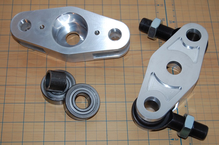

This car will be running a watts link.
Hopefully the one I made way back when will fit???? I'm going to email you some cad files shortly. At work trying to get like 5 machines running...what a Saturday

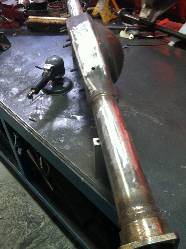

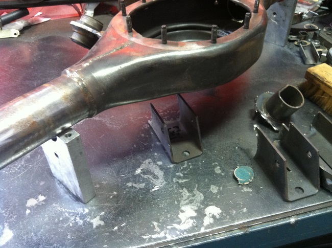

So we got the Quick Performance 9" stripped down and its time to narrow. After a quick check in the rear end fixture I found that the drivers side was a bit distorted, I took meaasurments and made notes.
We will bo going from 61.25 to 57.625"
Cutting the brackets off wasn't too bad. 2 hours later and we have a bare housing.
I need a set made with snap ring grooves. Do you need the snap ring or will CAD specs do?
Also changed made for the bearing bore and heim pass through holes.
lol got excited when I saw a post. .
Send me specs.
