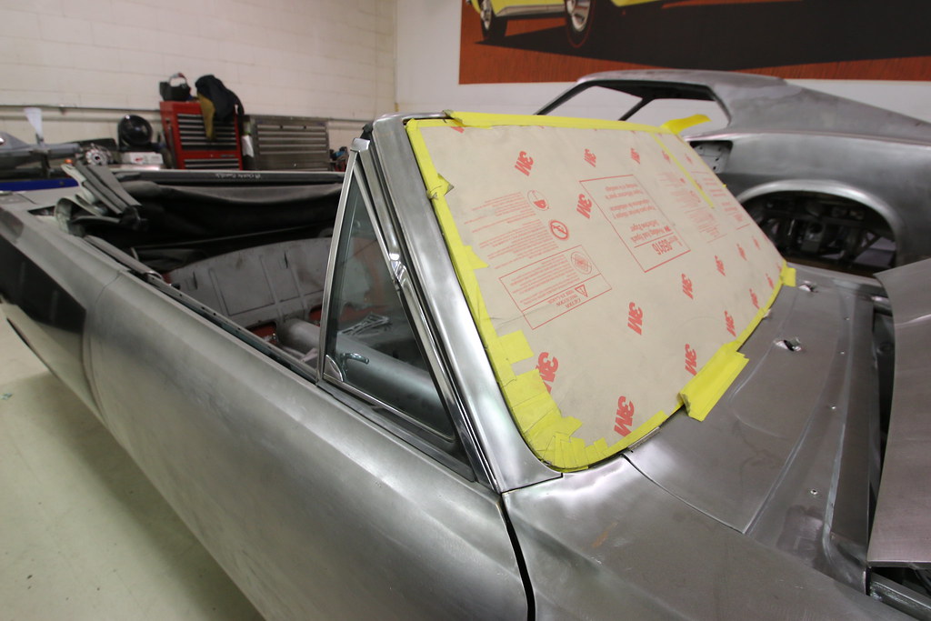

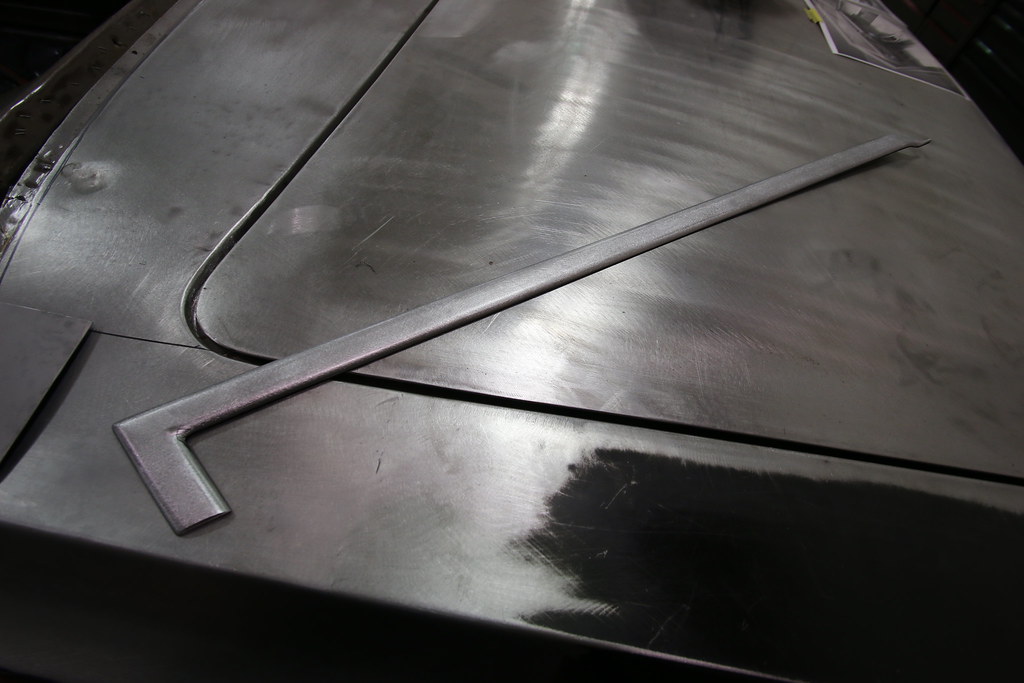

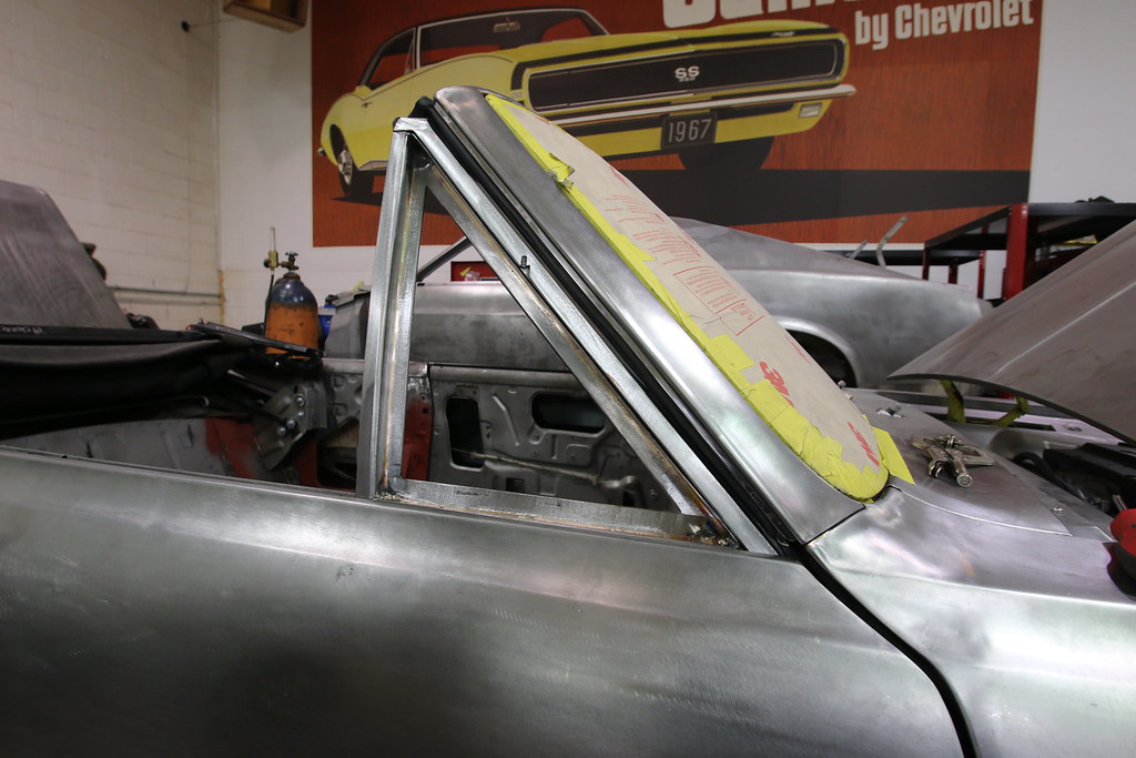

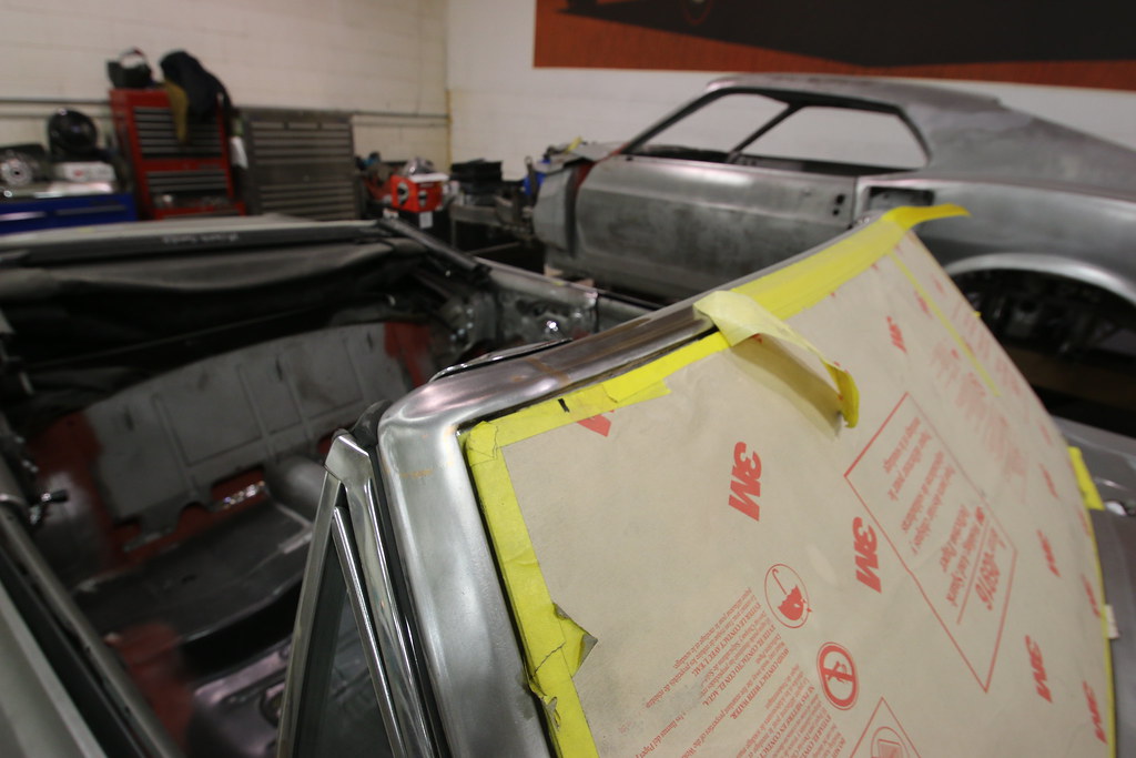

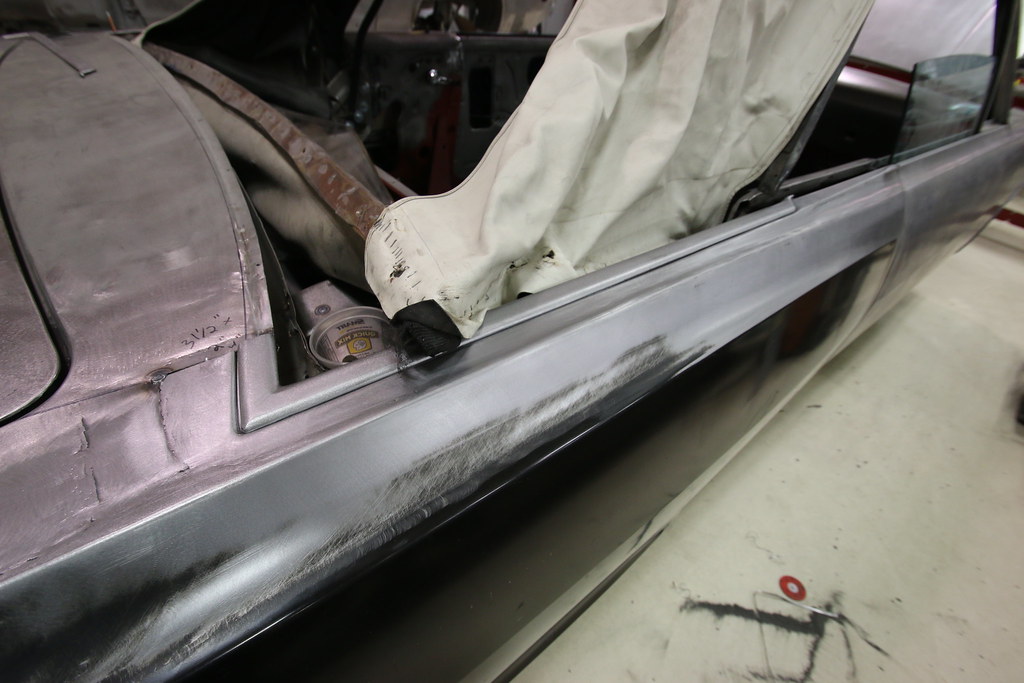

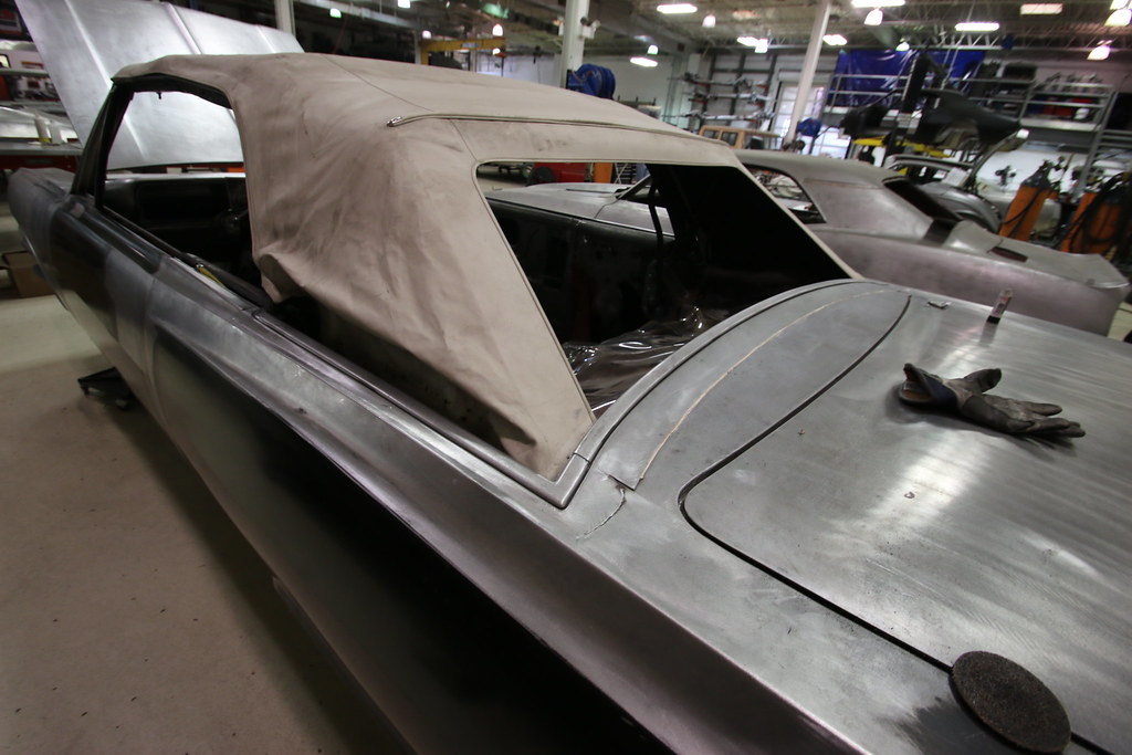

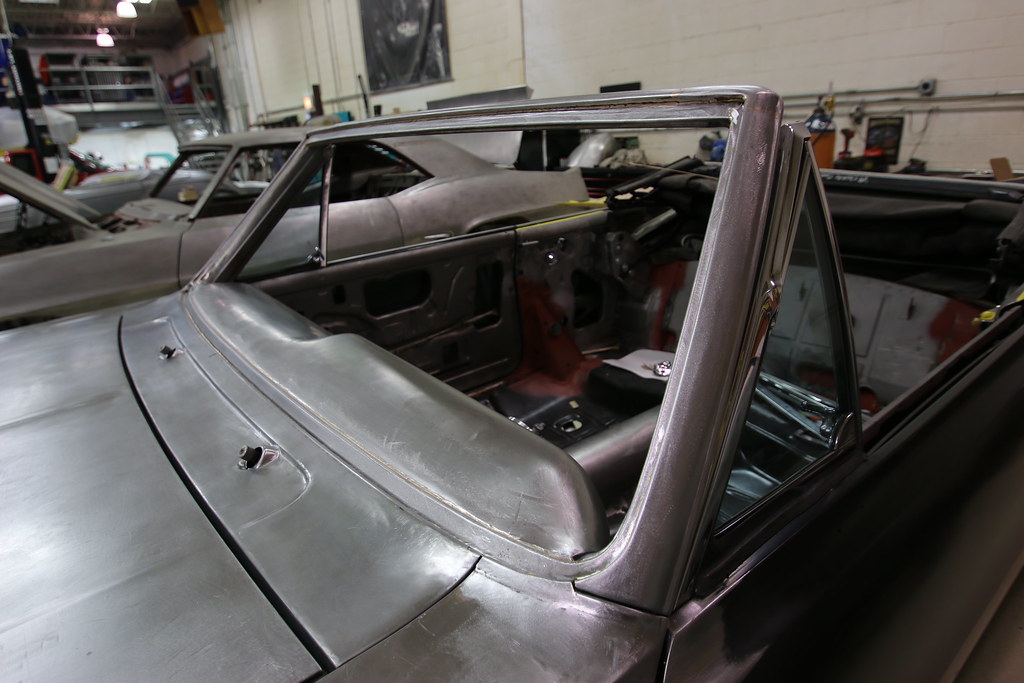

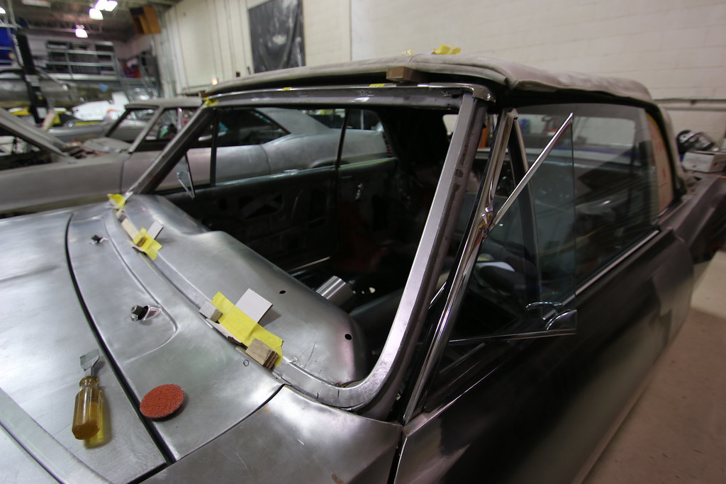

Picking up where we left off, attention turned to the way the glass will be mounted and the side vents. For a cleaner, contemporary look, we will be eliminating the vent function and installing a fixed side piece.

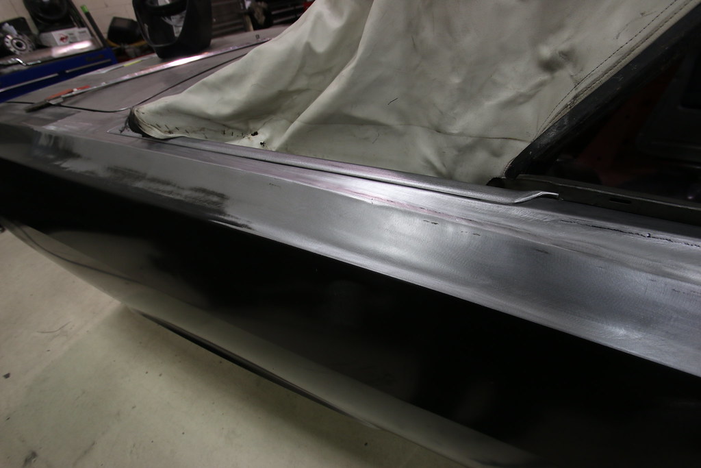

With the new quarters going on, the new sheetmetal created a lot of 'compatibility' issues with the roof and top mechanism, part of which meant new handmade trim and sheetmetal massaging in the surrounding area.
Note the rounded corners on the decklid also...
