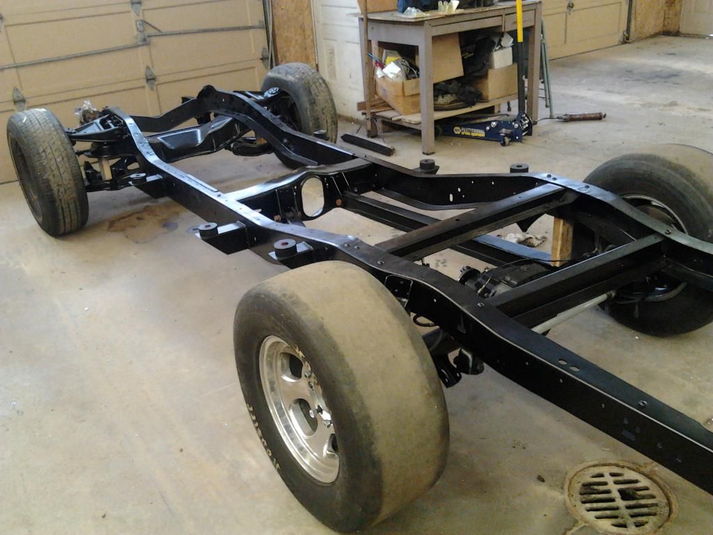

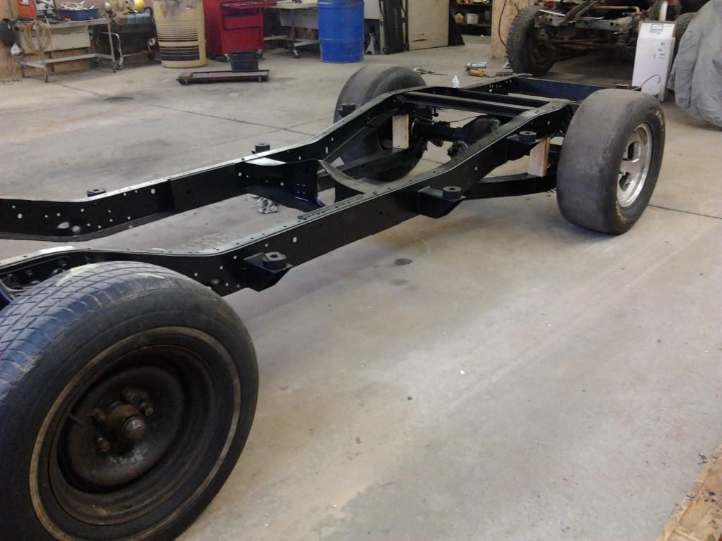

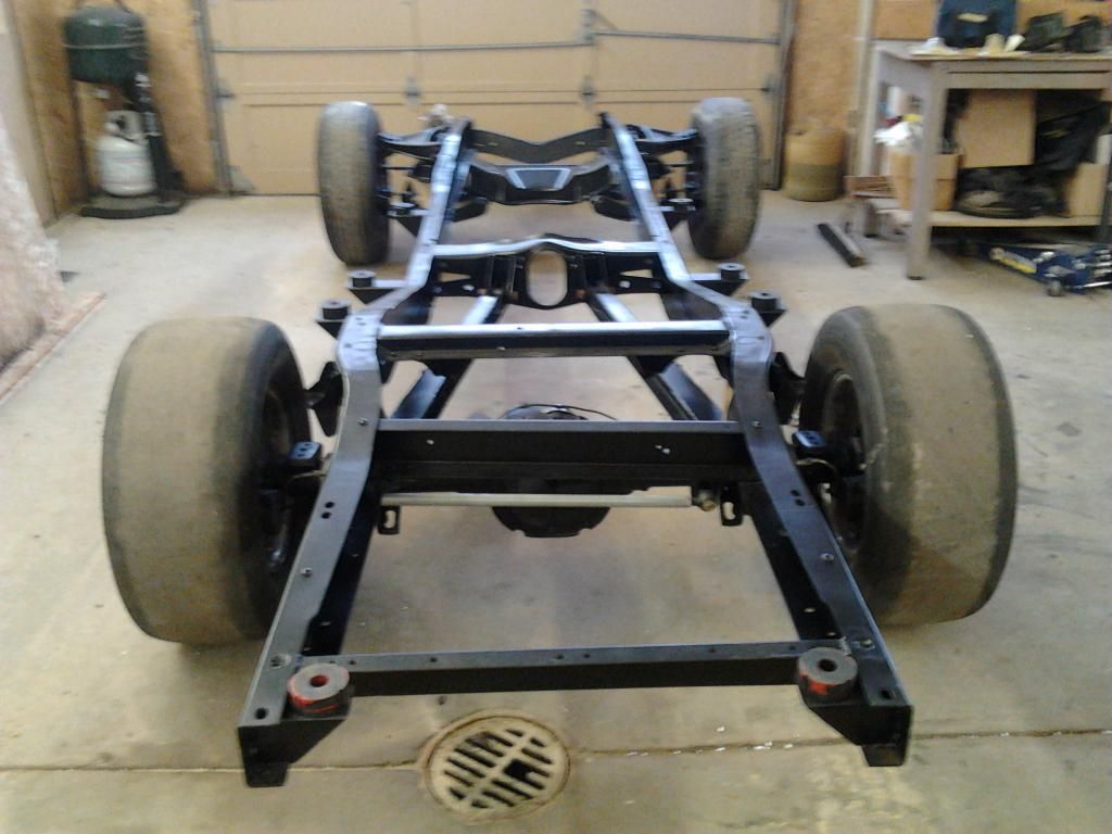

Rolling chassis.
Body back on and ride height (at the time) set. It will be much lower and obviously a different wheel/tire combo.

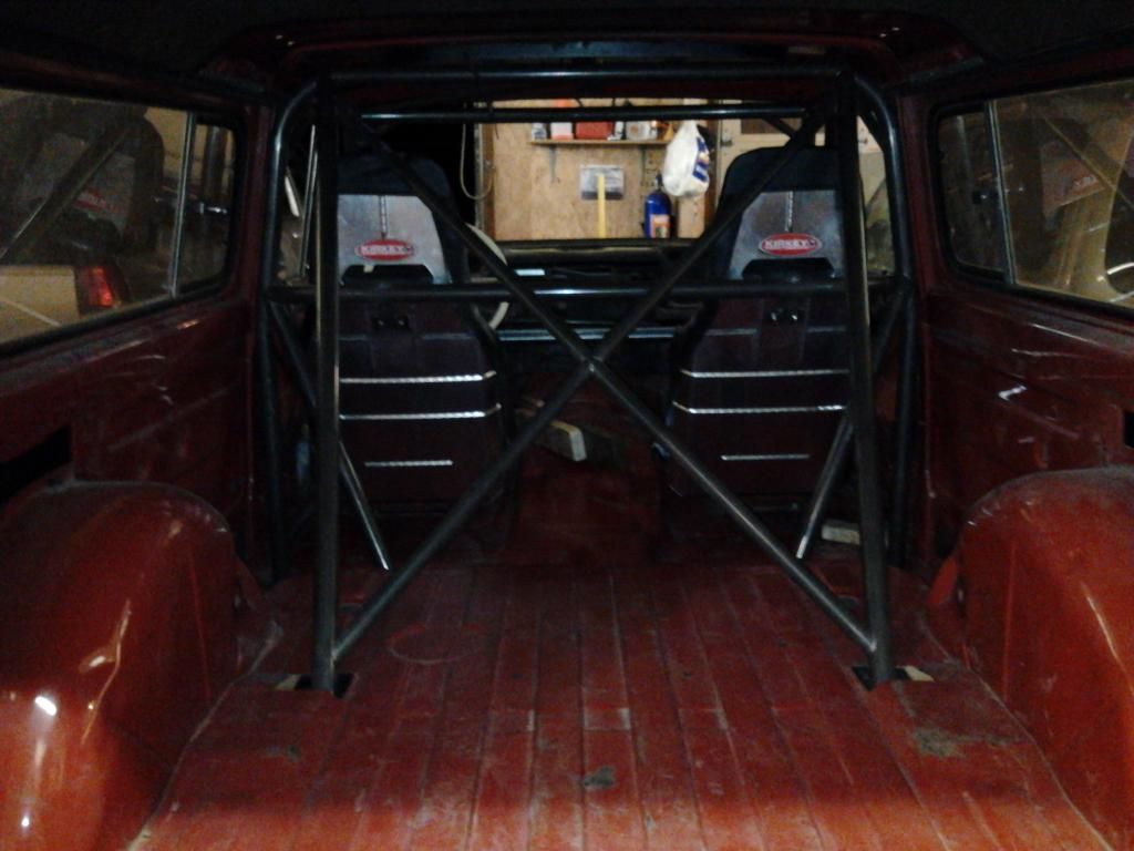

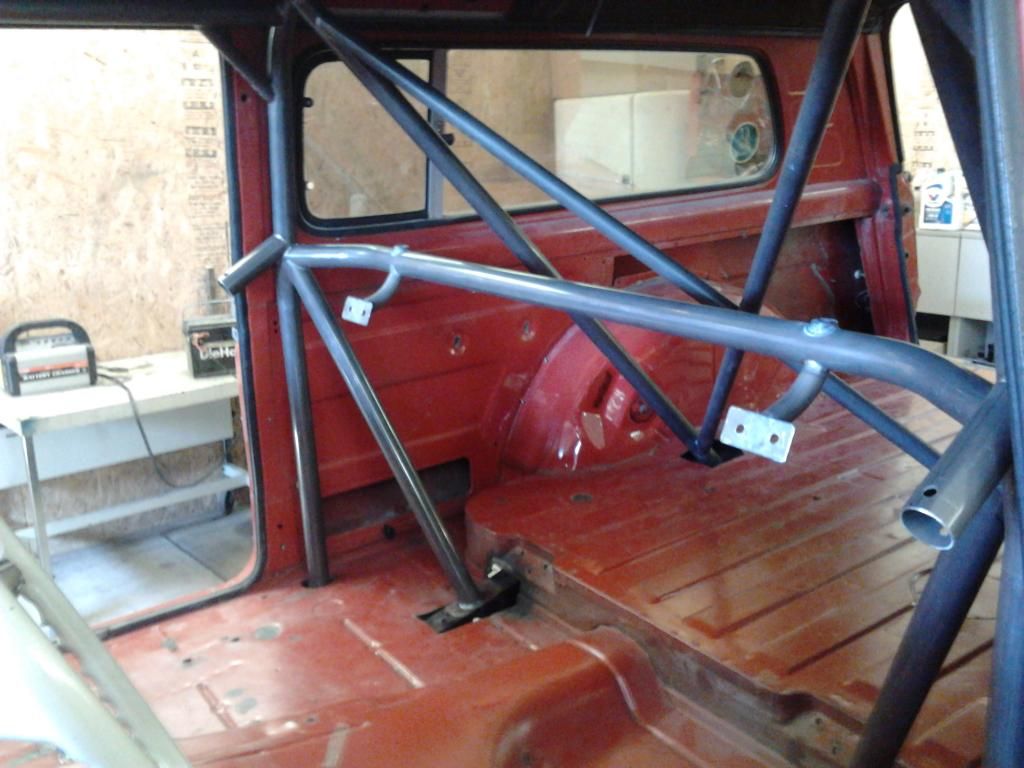

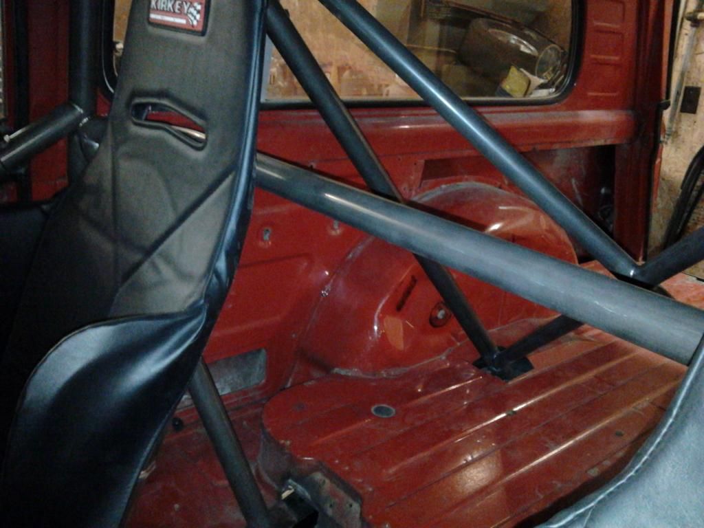

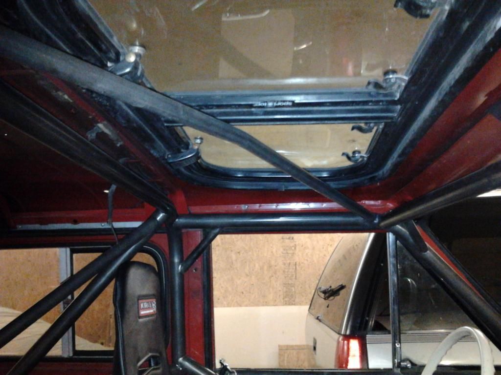

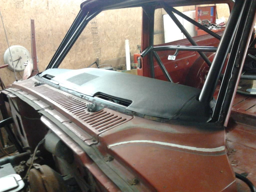

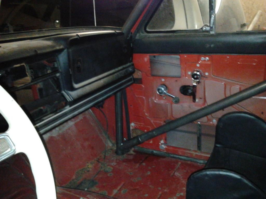

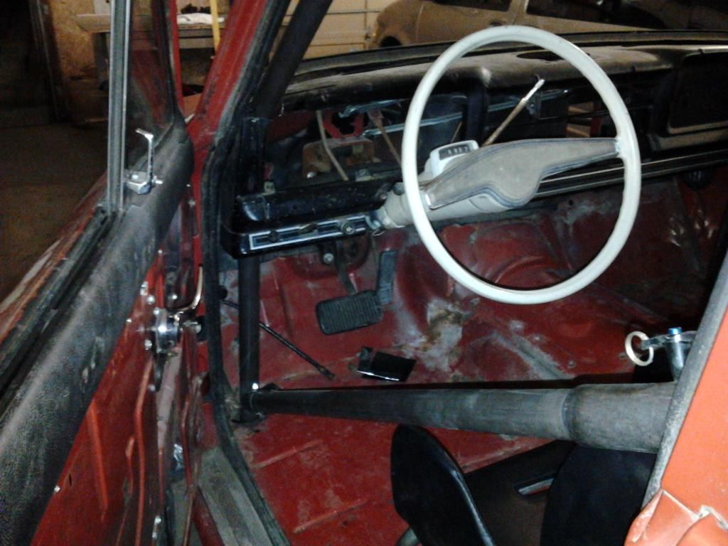

And off to the chassis shop for the roll cage. It's a full chrome moly 8.50 cage (remember, it was going to be a drag car).

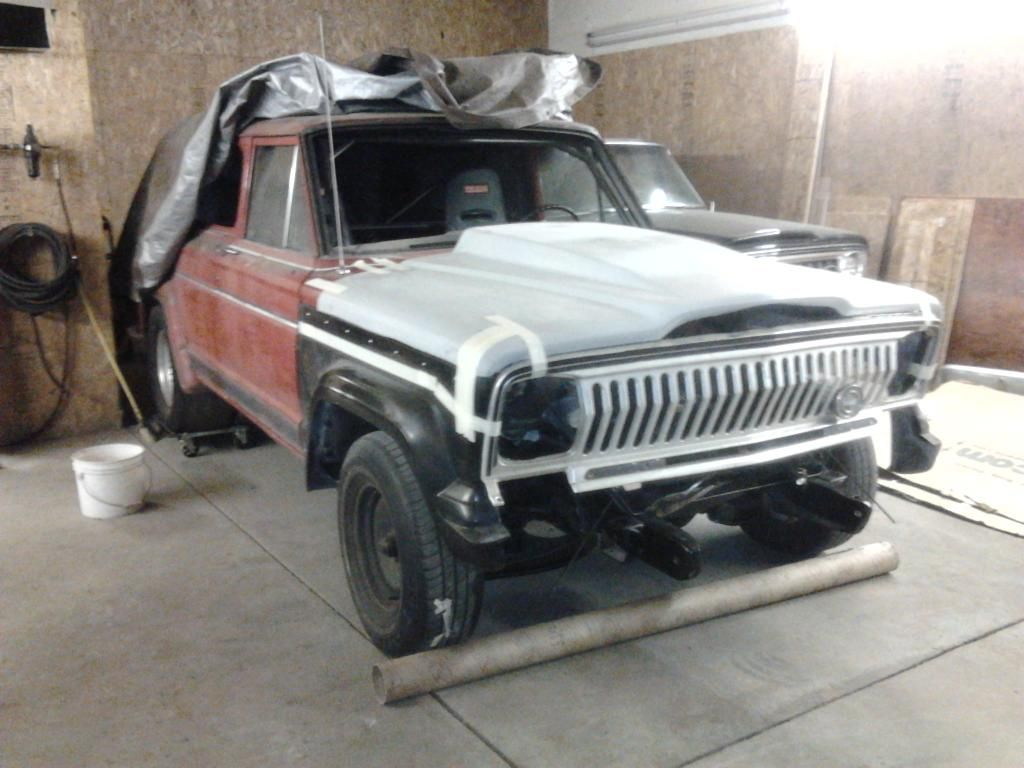

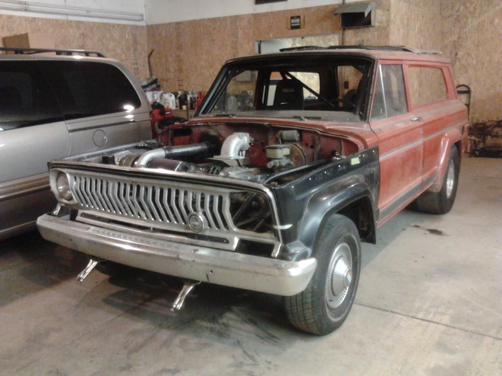

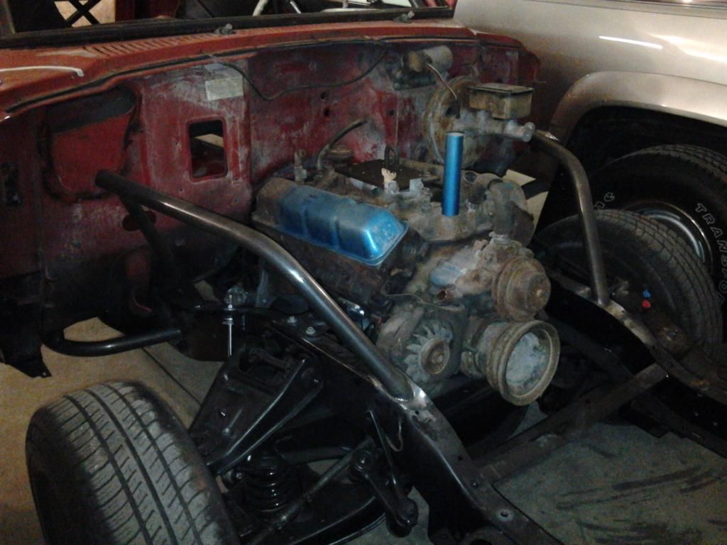

Got some fiberglass parts and made a lift off style front end.
https://www.youtube.com/watch?v=IX3RpiTf1N8

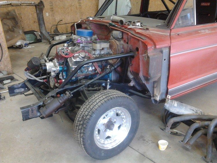

And a shot of the engine plan (at the time). AMC 401 based engine with an 83mm turbo. It's now all in my '77 4 door Wagoneer.
After the engine/turbo got donated to my Wagoneer, I threw this one in there for the time being. 712 hp all motor 401 stroker (454").

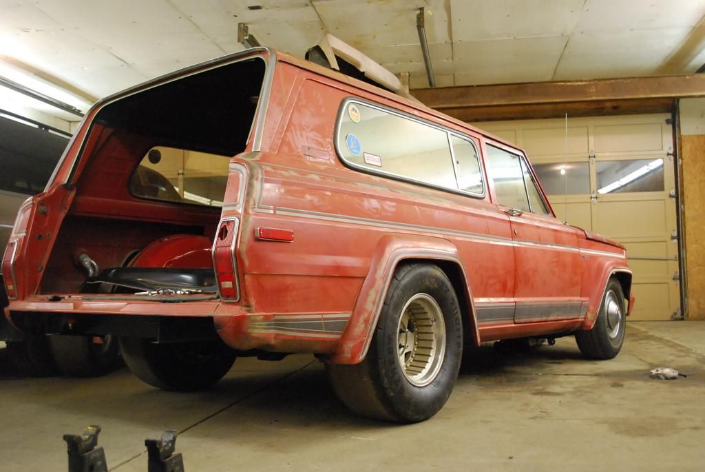

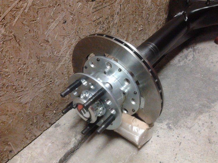

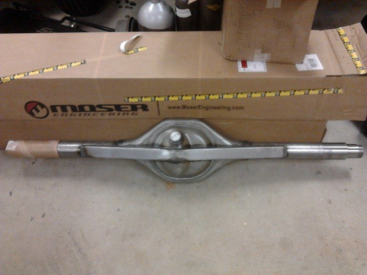

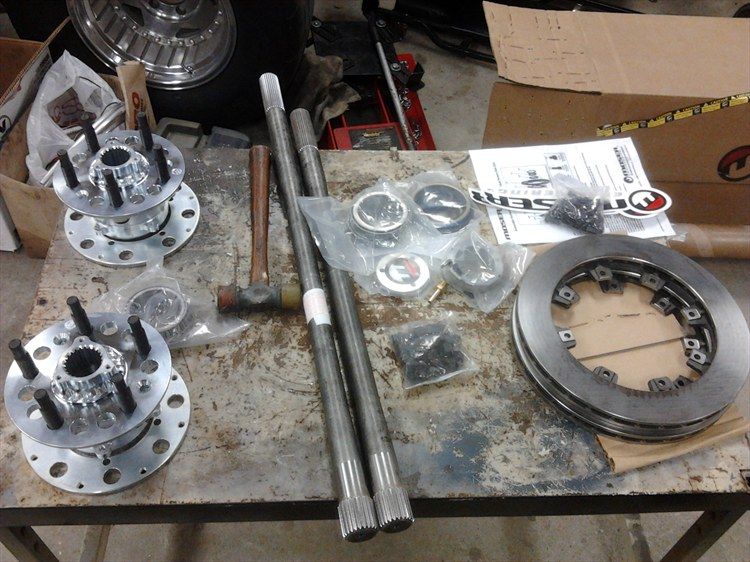

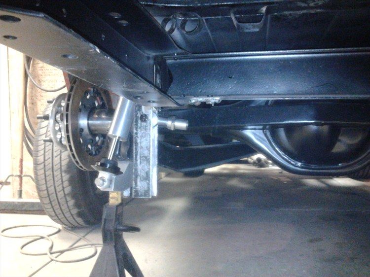

Around this point is when plans changed from drag racing to autoX and street fun. No more spooled Ford 8.8, bought a floater 9".

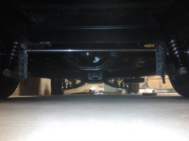

Converted the rear to coilovers and made adjustable panhard bar mounts.
