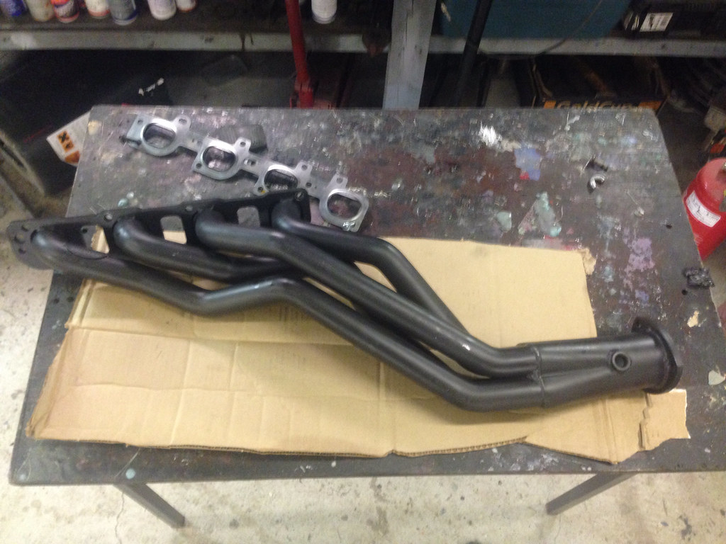

I ordered 1 5/8 conversion headers from Dougs headers, those were on sale and shipping was reasonable. Fits with original subframe and steering box, and fast ratio pitman & idler arm. Went awfully close to torsion bars so bit of heating and bending was needed

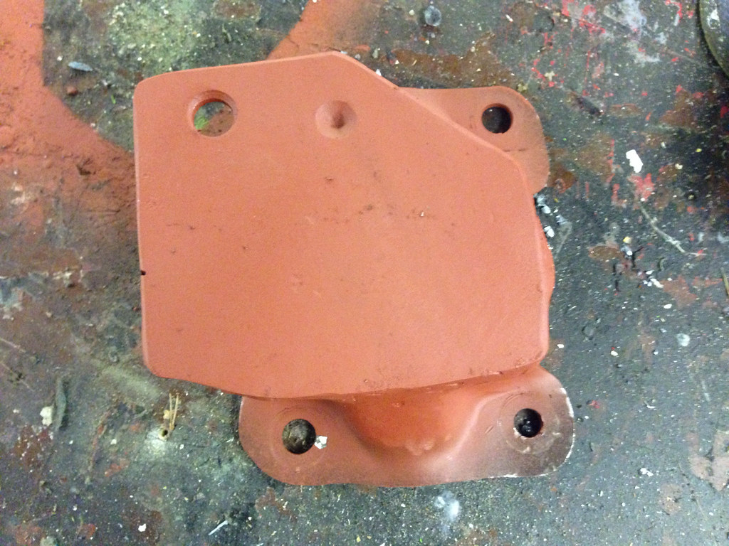

Made engine brackets from Jeep ones, use this with new small block engine mount.

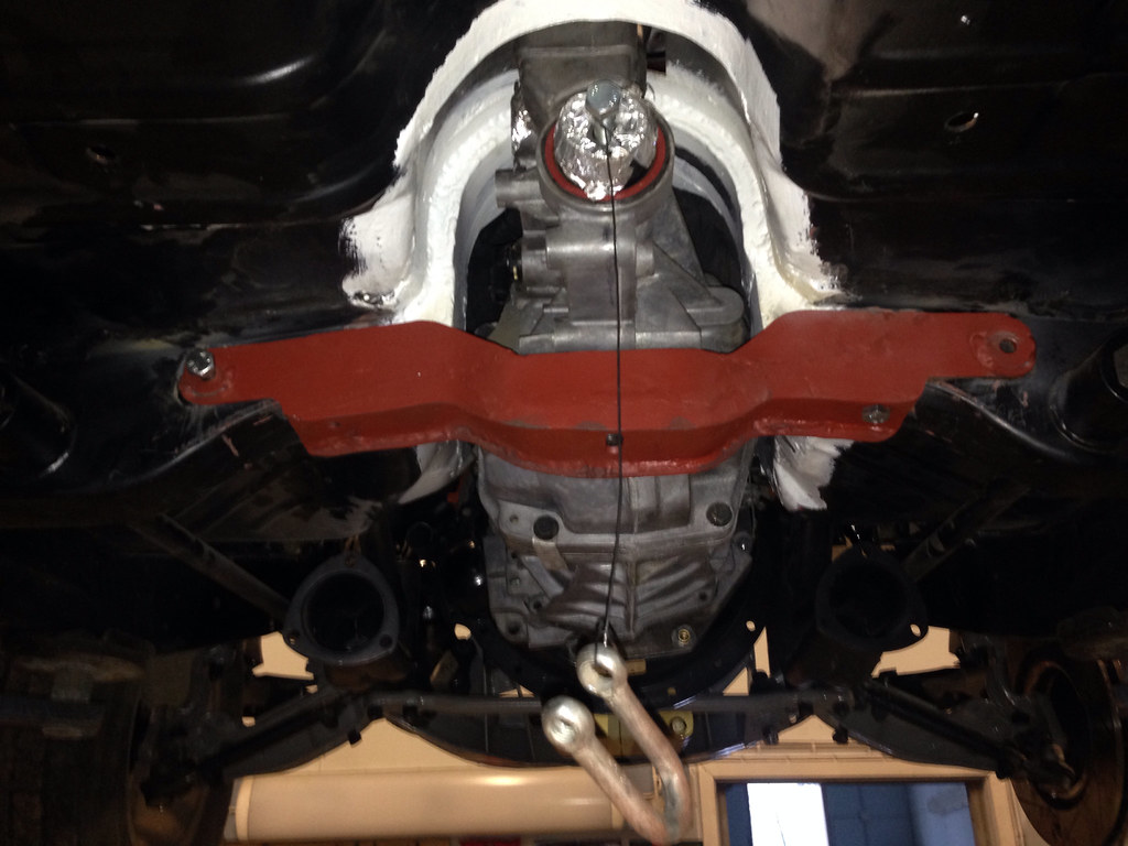

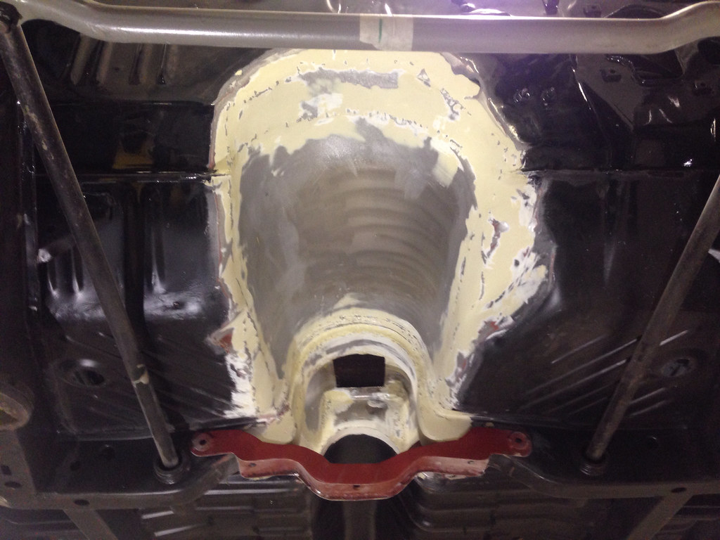

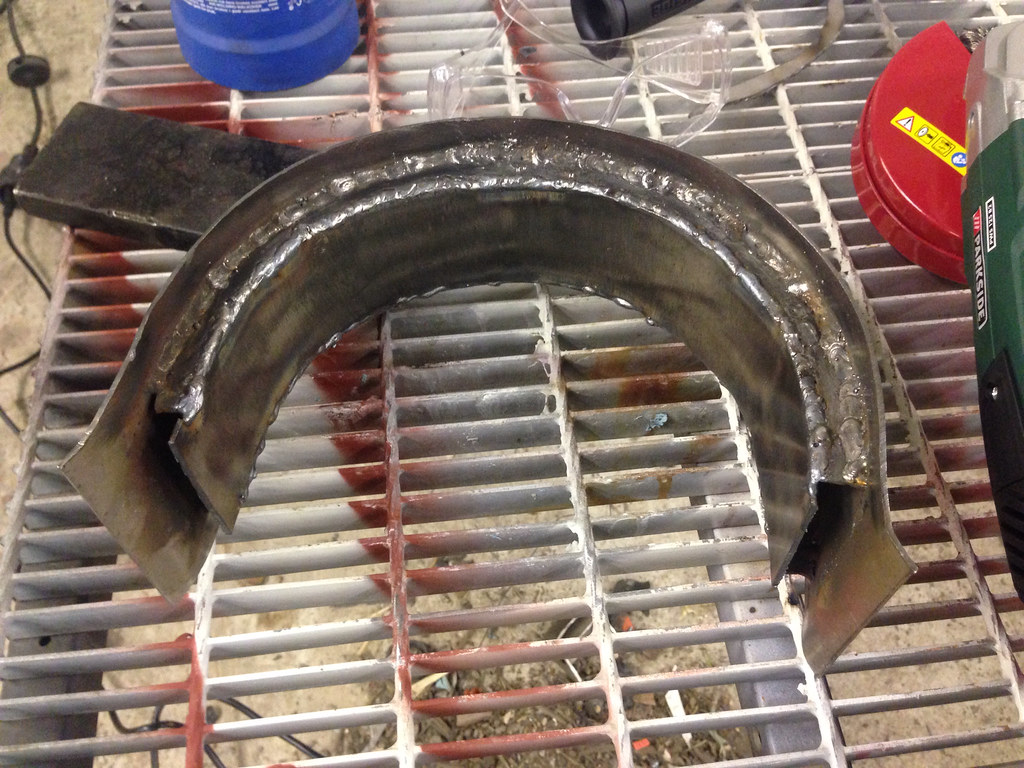

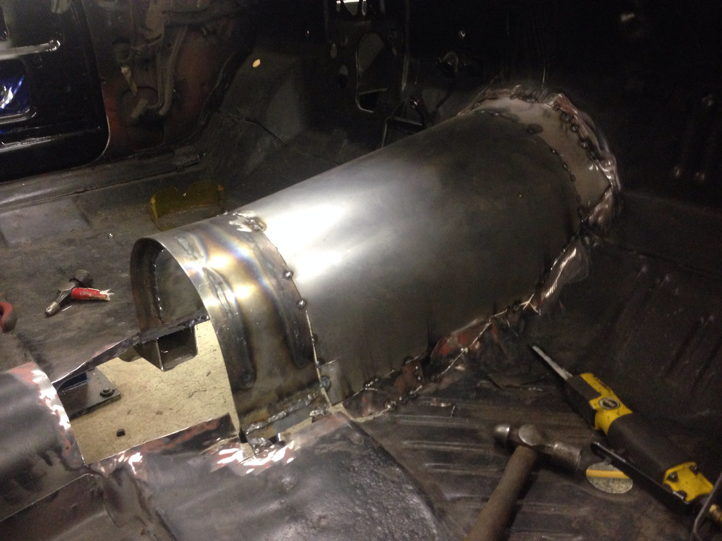

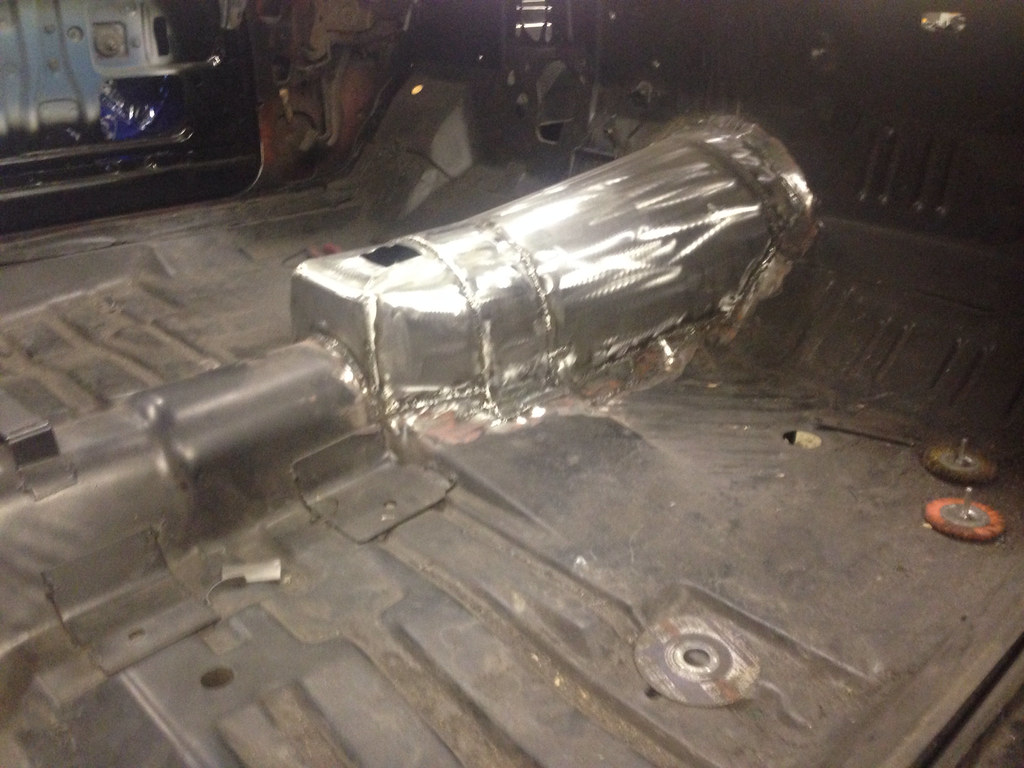

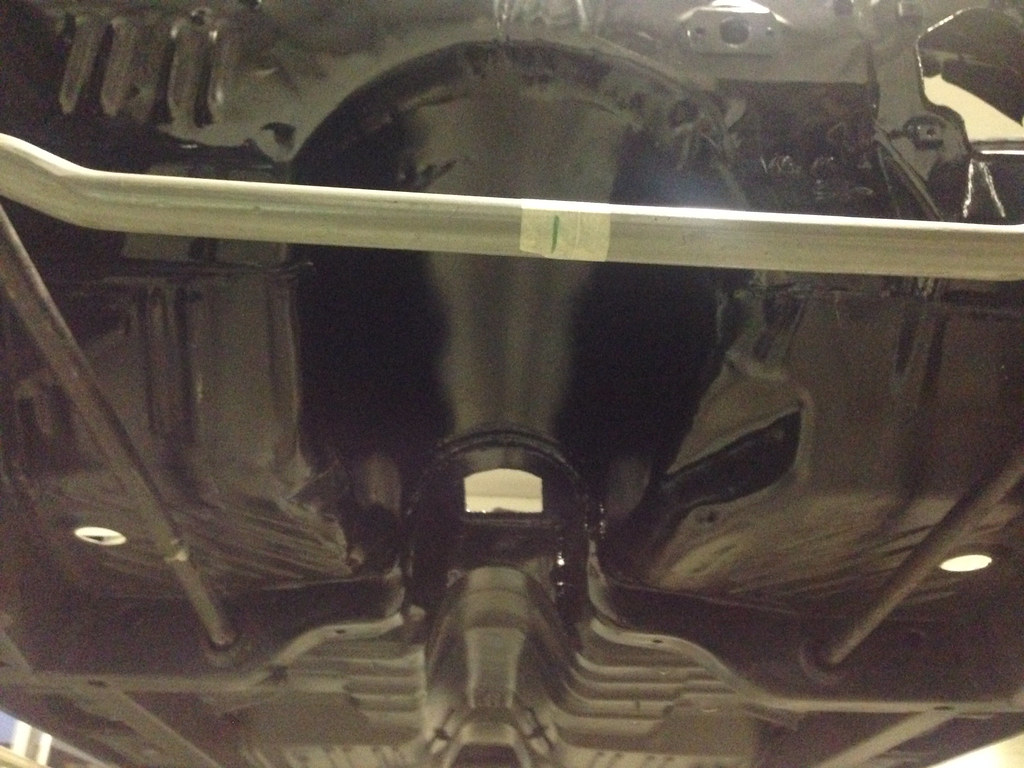

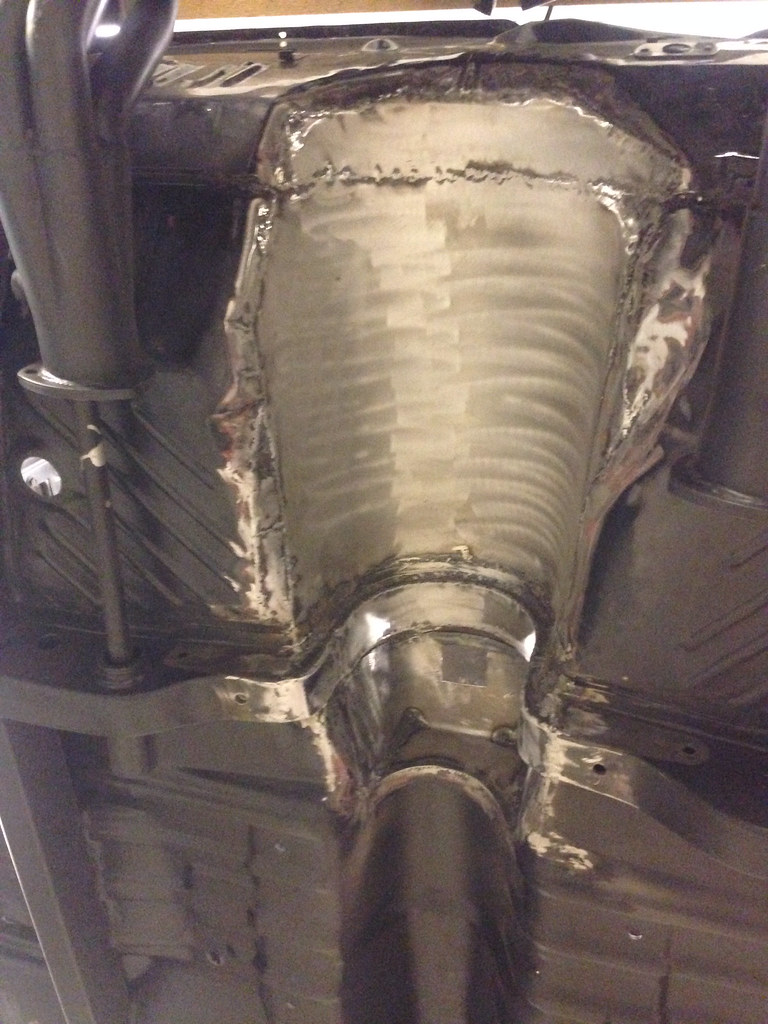

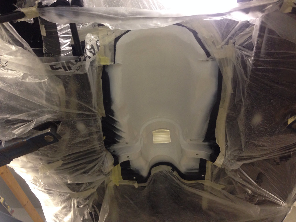

Gearbox tunnel also done and painted, and tranmission bracket.

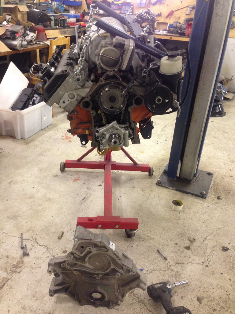

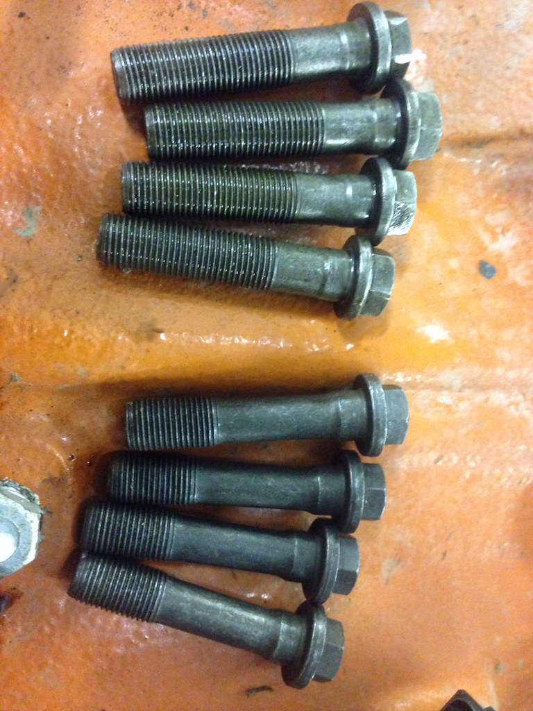

Also changed timing cover for engine, original was cracked in crash. Sourced one from ebay. Oli filter neck was also broken so opened two connection rod caps and checked bearings, should be first things that damage if engine has run without oil pressure, all like new so back together.
One question related to this. Ordered 4 connection rod bolts because of this, these are torqued to yield. Part number has changed and bolt design also. New bolts are 2gram lighter than original, so bottom end balance is now 8 gram of from factory balance. Should i worry about this?
