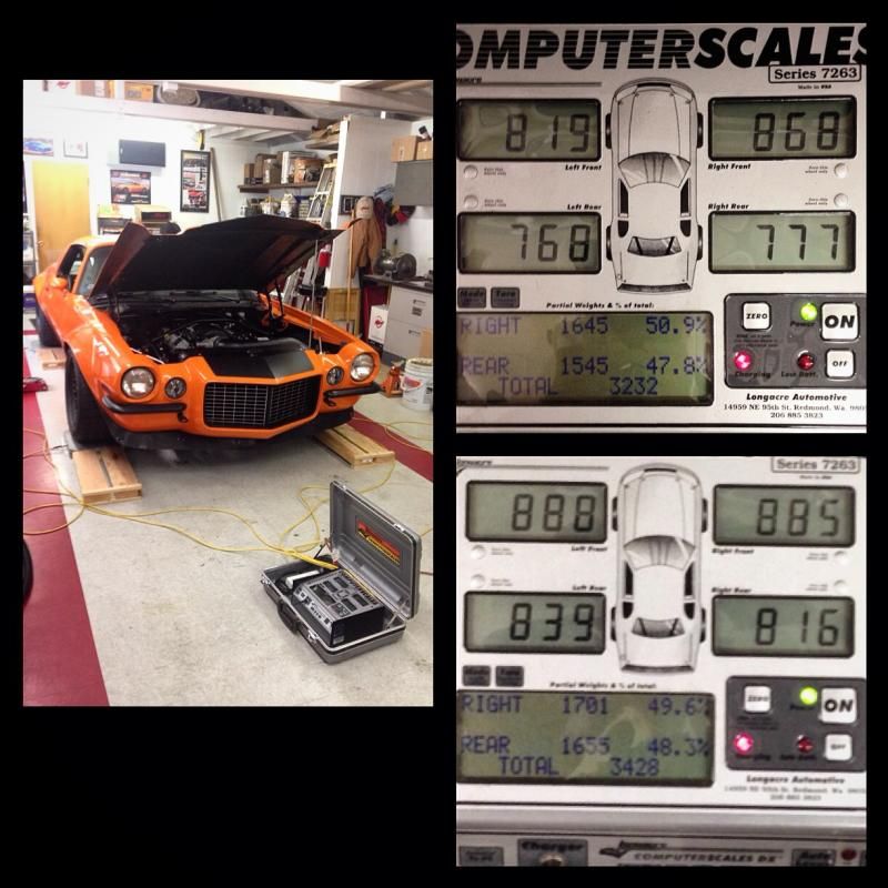

I will be taking the Camaro to the first Optima Ultimate Street Car event at Thunderhill on February 28th. I am making a few changes to the car to get ready for the event.
I also corner weighted the car again. I changed the transmission bell house from a stock Corvette aluminum unit to a steel scatter shield. Safety added over 40 lbs to the car. The aluminum bell housing I had on developed a crack.
I just ordered door glass for the car, so that is going in next.
Hi Brian,
50.4% left side weight & 49.6% right side weight is pretty dang close to 50/50. Sweet !
We achieve that 50/50 L/R balance in scratch built race cars because we can put stuff where ever. But that's often hard to do in production based cars. Good job.

Thanks Ron. We could have got it closer, but we figured the fluctuation in fuel level at this point put us dead on. That is with about 3/4 tank. We run full as much as possible on the autocross. Full gets it even closer.
I also need to loose about 8 lbs.
