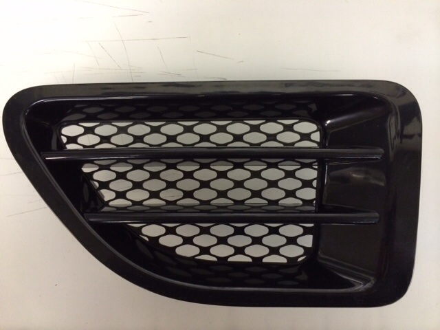

Here is a picture of the vents
I bought at Suumit
Bob

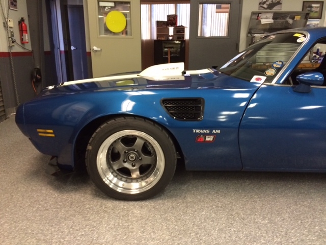

Bob, you could spend some time with a vacuum/pressure gauge a take readings at different spots on the car to determine where changes need to be made to allow the air to flow. For instance, you may find that a partial belly pan in the engine bay will help evacuate air from the bay by increasing air pressure in the bay relative to the outside at the vents. The air will flow from high to low pressure. The hard part may be to achieve this while keeping the pressure in the bay lower than it is in front of the radiator so air will continue to flow through it.

Trey,
I just finished the install yesterday
After coming back from a short drive I shut
the car down but left the fan and elect water
pump run for a short time.. walking by I could feel
air coming out the vents... I did a quick test with a
piece of paper and the air goes up near the top of the
vent and then forward?? as I head lower.. now sure when
the car is moving...
Pic of Vent installed
Bob

Looks good! Hopefully, it'll work well for you.
