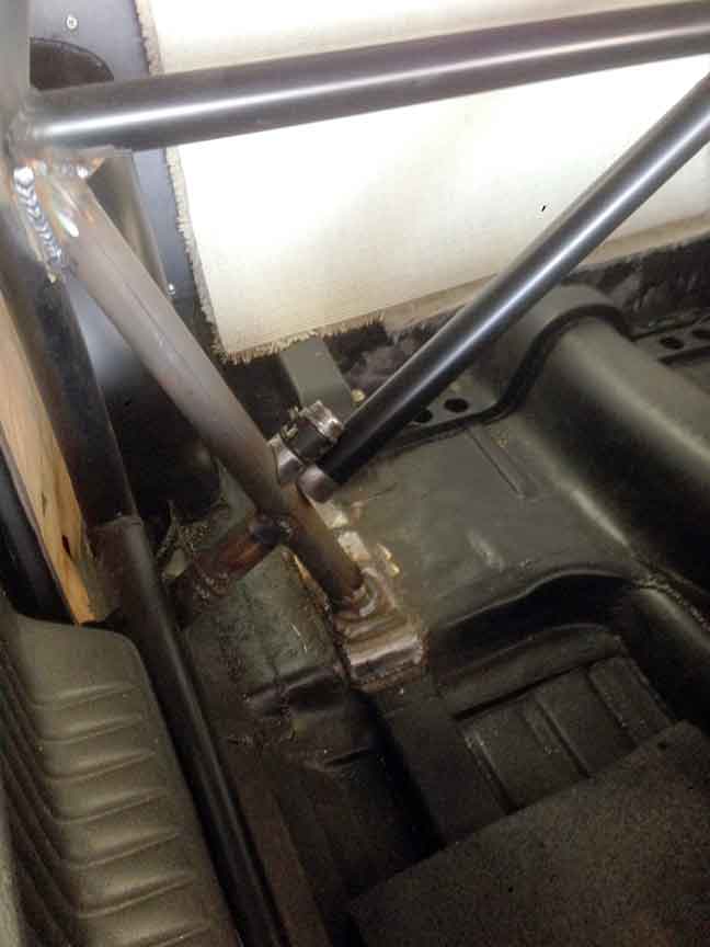

Still alive. Just saving money for expensive parts and have been busy with other events. In the meantime I ran across a thread about rollbars/ cages so now I want to modify mine to connect to the frame rails. Fortunately, I have enough extra metal around to not have to buy anything for this little project. I made some plates and welded them into the floor using many plug welds and around the edges. Not sure if it shows but the area is double layered. Next will be the tubing itself.

They fit nice. Should be a ridged mounting spot.
Thx, Wayne. I hope so. I did my best to get it on top of the frame rail, and there is actually two stepped pieces of metal I added to help disperse the load.

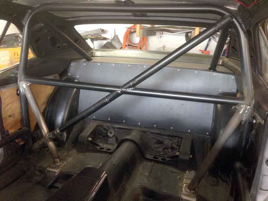

I was able to add the additional tubes on my roll bar this weekend. Next will be to sand down the mess/ burnt paint, and repaint it.
