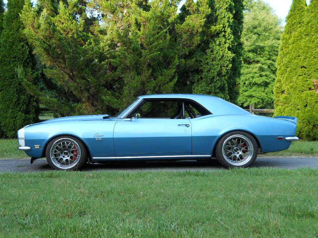

Since tires have arguably the greatest effect on handling, wheels and tire selection has become a priority...thinking I should make a selection and build the suspension around them. I've been on the fence about the appearance of wheels larger than 17" on the first gen f-bodies with some 18's looking good, others not and anything over 18" just not looking properly proportioned to the car. I don't really want wheels tucked up in the wheel wells as I'd like to avoid clearance issues (since this car will mostly be street driven and the industrial park where my business is located has ridiculously tall speed bumps) so I'll likely go for a ride height that puts the fender lip just a touch higher than the height of the wheel/tire combo. I found this picture and am really, really liking this look...but just a touch higher with the ride height. I was pretty much set on five spokes like a VWW V-series but this looks excellent. Alas, Forgelines are absolutely not in the budget.

I was on the fence for years, 22 years to be exact. 18's are proper and they fit proper brakes and provide a good selection of tires.

Im a 17" fan but Sieg is right. For front suspension clearance at tie rod with deep back space plus tire size selections it appears 18" is the way to go.
