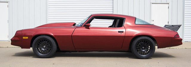

Love the car.It's cool that you pretty much do everything with it.My question is with front wheel & tire combo.How much clearance do you have near the control arms, sway bar & frame etc. at full lock?
Mike,
Old 03-09-2015, 05:29 PM
Panteracer's Avatar
Panteracer Panteracer is offline
Join Date: Oct 2013
Location: SF bay area
Posts: 1,175
Thanked 276 Times in 114 Posts
Default 78 Camaro
Just wondering what offsets you
have on the 18" wheels
Thanks. Bob
Old 03-09-2015, 08:43 PM
silver63c10's Avatar
silver63c10 silver63c10 is offline
Join Date: May 2007
Location: Carrollton, TX
Posts: 221
Thanked 11 Times in 3 Posts
Thanks! We had to do a little bit of clearancing on the swaybar, which is a 1.25" Suspension Techniques piece. We also welded a small piece of metal (1/8" or so) on the steering stops to gain a little more clearance there. Doesn't appear to have hurt the travel much.
I feel like they would probably hit on the stock inner fenders in the rear, but I don't know for sure.
They are 18x11, +20 all the way around.
Duston
Follow along on the insta

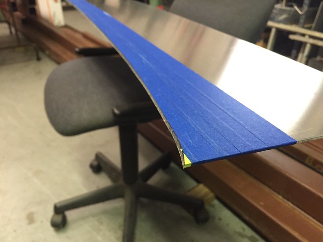

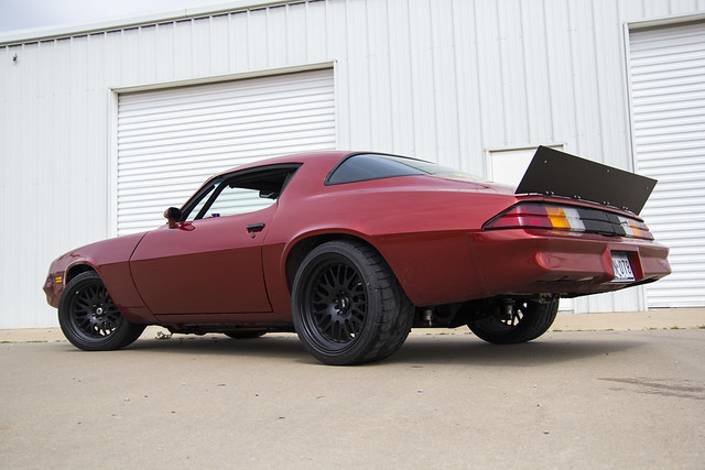

More progress! We took the weekend off from playing to get the spoiler built and wrap up some other miscellaneous things. Of course, the SCCA event on Sunday had lovely dry, warm weather, but so it goes.
Little items included chasing down a leak in the front which turned out to be accumulated rain water, swapping rear brake pads to Wilwood Polymatrix Bs from a stock compound, and doing some interior cleaning.

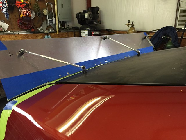

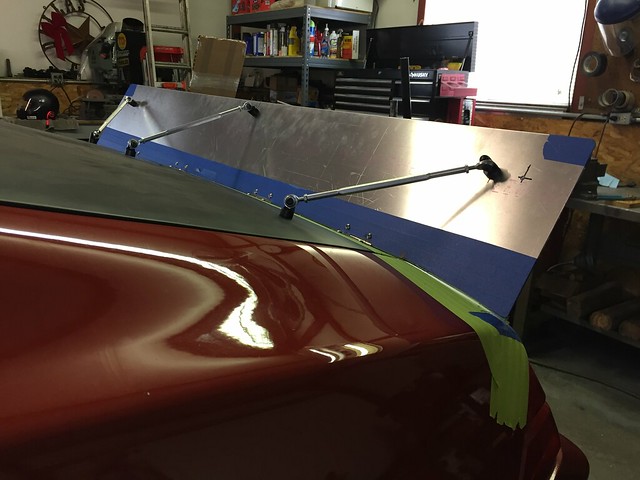

The big ticket item was out back, and I'm extremely happy with the results.
After scrounging our scrap pile, we didn't have a suitable piece of aluminum, so we hit up OnlineMetals for a piece cut to our specs. This provided us with a square, straight-edged piece, and eliminated a ton of work - all for around $60. The material itself is .100" thick 6061-T6.

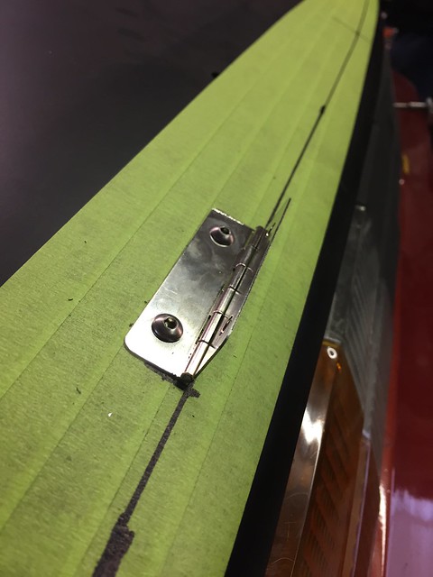

We sourced two pairs of Wehr's struts from Performance Bodies to provide the strength for the setup, along with some piano hinge from the Lowe's cabinetry department for lower mounts.

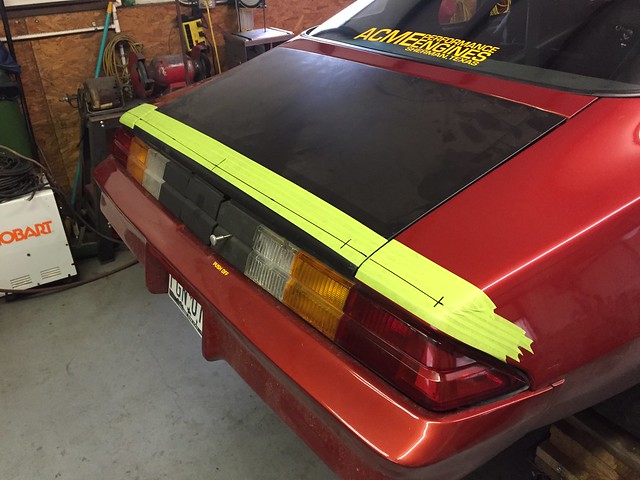

Our secondary decklid was swapped on (the tail-less look is still cool for drag racing and the street, so drilling into the painted one wasn't an attractive option), and the marks we made previously for the template were recreated.
Each mounting screw required a hole all the way through both layers, which was then opened to 5/8" on the inside to accommodate a washer - 4 separate drilling tasks per screw.
Placement was determined in part by how the inner structure is made - we lucked out with the holes falling outside the weatherstrip for the most part.
With the hinges in place, the blade was sat in position and marked for some additional clearancing. We added a relief cut at each hinge, allowing the aluminum to sit down over each and flush with the deck.
Once everything was happy there, we marked and drilled holes for the hinges, starting from the center and working out.
Sometimes a bit of improvisation is required - this bungee-traption made life much easier
Finally, we placed the outside struts in about the spot that felt right and attached them to the blade, then moved to the bottom side of the decklid to evaluate our options. This ended up being our one 'oops', as they were a bit too short to make it where they needed to be on the deck. The secondary holes will be useful if we ever want to stand it up higher, at least.
Our original plan was to use 4 struts, but looking at the beefy hardware included and how busy things got with all 4 of them up there, we settled on 3. There is some give in the blade thanks to the tolerances of the rod ends, but nothing too bad.
With 16 #10 screws on the bottom, and the 3 rod ends having 1/4" screws in them, I don't think we have anything to worry about strength-wise. Nights this week will be about getting it painted along with getting some of the interior pieces (shifter boot cover, dead pedal, and gas pedal cover) that never got finished out properly coated in black as well.

A couple bonus images, just because.
We'll eventually build a splitter/air dam/chin spoiler thing to balance everything out (both aero-wise and visually), but there's no time left for this time. Can't wait to wring it's neck this week!

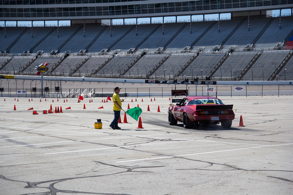

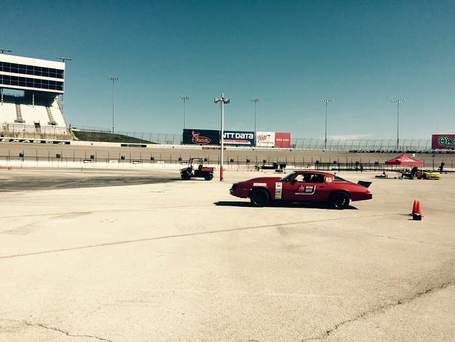

Wow, what an incredible two days of absolute awesomeness! That's a lot of adjectives, but still not enough. From the running of the event, great people, and a cooperative and capable car, this weekend will be a tough one to top.
I'll do a full writeup of our experience with more pictures and video later this week, but I wanted to get something in here while it's fresh.
Waiting to hit the autocross - ended up 4th in GTV
This car just continues to amaze. For something that is mostly unchanged from a foundation standpoint from what we took on Drag Week, it's an absolute monster around the cones and on the road course. I can't wait to see what we can do with it with more tuning, there's still so much left in it.
Speed Stop - the first and weakest event for us. Finished 7th in GTV
Talking things over during judging - Mike from Lingenfelter remembered the car and talking to us on Drag Week
Before I finish this, we have to give a HUGE shout out to Mike from Wilwood. He took a ton of time to discuss our setup, some upgrades and tuning ideas, and even pitched in and got dirty when we were reassembling the shifter after it unceremoniously ended our first road course session.
Excited to get some changes made to make the brakes even better, and I'll cover that as we go.
It was absolutely amazing to step up to the podium twice. Just mind-blowing. We ended up 2nd on the hot lap, between the Ridetech cars, and 3rd overall in GTV - far and away better than even my wildest hopes for the event. Not enough words to express how happy we are with the little red Camaro.
More later this week..

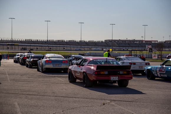

We arrived at the crack of dawn. Well, before the crack. Way before. The schedule to said to arrive no later than 7, and that turned out to mean that gates would open at 7 (live and learn, better early than late, etc.) Once in the gates, we scrambled to get the truck parked, the car unloaded and into the garage, and soon we were off to tech inspection.
The process was fairly thorough, and no major hiccups were found so we were on our way to getting the various decals put on. This was one part I was kind of dreading, but everything went smoothly and we had plenty of time to stand around and BS a bit before the drivers meeting.
The meeting started promptly at the time prescribed, and Jimi welcomed everyone and explained how the weekend would go. Saturday, everyone would split up based on car number, with odds heading to speed stop and evens to the autocross in the morning. Being #51 this really worked to our favor. I was able to get the feel for everything in the speed stop, which I assumed going in would be our weaker event given that I hadn’t done it before.
This ended up being the case, and we managed a 10.991 on the 4th of 8 runs. While this event started as a pure test of acceleration and braking, it’s morphed into a very simple autocross over the years. This was one was a run out that had us tickling the rev limited in first before a hard braking zone, then a right turn back almost 180 degrees, hard acceleration into an offset, and finally the 40×20 stop box. It’s much more a handling and braking test rather than pure braking now, but still fun.
Seeing a short line for judging, we decided to hop over there and get that taken care of. The hope was to get back and get a few more shots at it afterward, but we weren’t able to get back in time.

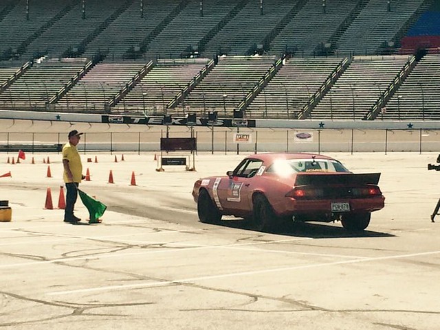

After a brief lunch, and a quick walk through the (by Texas autocross standards) pretty tight course, it was time to take on the cones. The first several runs were really frustrating, as it’s been forever since I’ve run a really tight course, and on top of that, I’ve never had to negotiate elements anywhere near as tight as the 180s and offsets along the back were.
After a few runs, several cones, and some head scratching, things started to fall into place. Five runs in, a 45.559 was the best we had, and we decided to head to the garage to investigate some unusual sounds coming from the rear end. No major issues were found, so it was back to the course to get a few more laps before time was up. This paid off, as the next to last run we picked up nearly 2 tenths.
Autocross final: 45.361 – 4th in GTV
