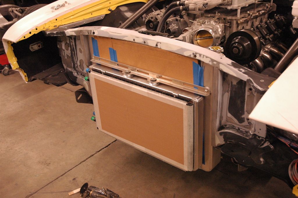

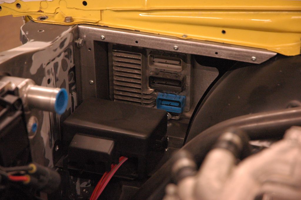

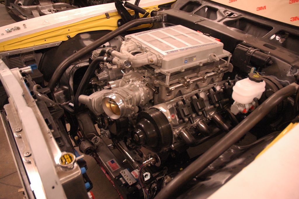

Some updates:
C&R radiator/ICHE and Vintage Air condenser mounting
Bosch ABS controller and coolant fan mounted. Chassis wiring in progress...
E67 controller and fuse block located as was on Hellfire....

Gordon and Mark. Does C&R have drawings for that ginormous cooling stack ? Could any of us peons order one if we were prepared to do the radiator support mods ? Also, is the fan available, or top secret for Stielow Inc. ?
Just got off the phone with Paul at C&R - he handles all of these types of projects - highly recommend you give him a call, I have no doubt he'll hook you up for exactly what you were looking for.
He's at the south office.
Here is the "Stielow inspired" radiator with three integrated coolers that C&R designed and built for me that doesn't require any core support mods. They said it was quite a packaging challenge. I only have a stock LSA so hopefully it will be adequate versus Hellfire's 2X horsepower. The left side connection will be a bit of a challenge with the air intake but I think I can make it work.
I hope Mark doesn't mine me posting my junk in his thread. :>)
Don
Don
Looks good.
The C&R guys are very good to work with. We went back and forth on a few designs with great drawings. The actual parts are spot on to the drawings and fit great.
Mark
