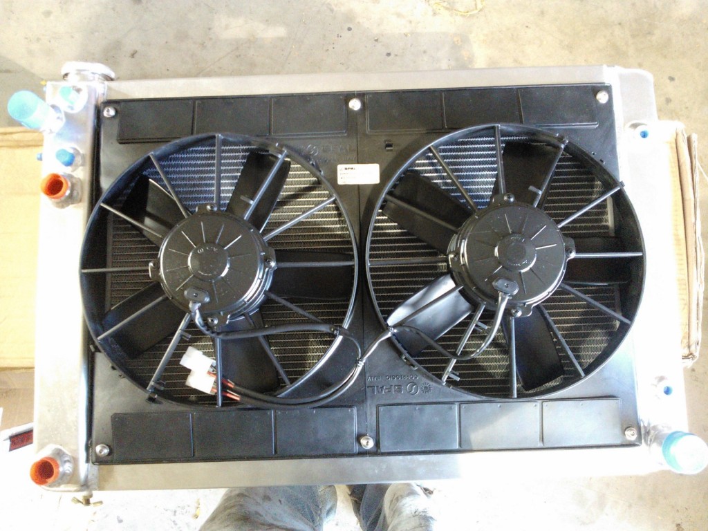

Here is the "Stielow inspired" radiator with three integrated coolers that C&R designed and built for me that doesn't require any core support mods. They said it was quite a packaging challenge. I only have a stock LSA so hopefully it will be adequate versus Hellfire's 2X horsepower. The left side connection will be a bit of a challenge with the air intake but I think I can make it work.
I hope Mark doesn't mine me posting my junk in his thread. :>)

Looks good.
The C&R guys are very good to work with. We went back and forth on a few designs with great drawings. The actual parts are spot on to the drawings and fit great.

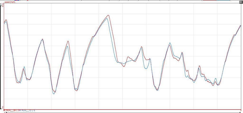

Below is an overlay of Hellfire best lap and JA 2.0 best lap. JA was 2 seconds a lap faster than Hellfire. I know JA can go faster because my "best" lap was without power steering and a small amount of smoke coming up through the shifter boot. So with power steering and not worrying if the car was going to burst into flames I think it had another 2 seconds in it.
JA 2.0 Red Trace
Hellfire Blue Trace

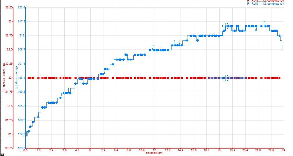

The experiment on cooling is a 100 % success. It was a bit cool on Sunday but the car came off the track with the water at 196 F and the oil at 217 F (I may need to go to a higher thermostat on the oil)
Just JA 2.0 data below

Glad you have fun and that JA 2.0 did so well, Mark. Very interesting to see it go faster than Hellfire given all the weight savings you had on Hellfire. Did you think it would be faster than Hellfire?

The BIG change is going from Rivals to Rival S tires. I think JA is making a tick more power but the corner exit speed is up a lot due to more grip and that is where most of the time is.
