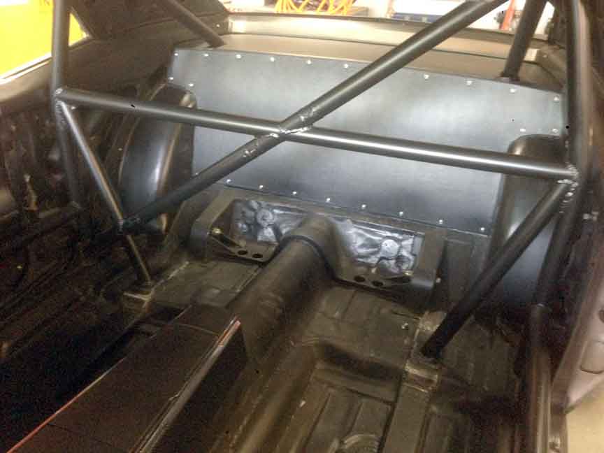

There won't be any flex in that area.
Let's hope not. Or worse, should the car find its way onto its roof that the cage won't poke through like that mustang did (pics of it made the rounds on the internet).

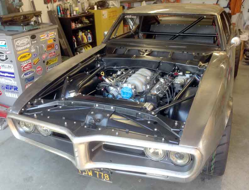

Totally dig this build! Those BMW lights look amazing, I was really thinking about putting Halo lights in my 68... Hearing your build attempt kind of scares me off a bit though, however they look bad ass! Nice job overall though
Thank you. Please keep in mind this is just how I did it with what I bought. The "halo" in these lights are lit with incandescent bulbs. Perhaps there are other brands of lights that are smaller, use LED's and would fit in the stock buckets? I also went into it blind not seeing how anyone else had made them fit. At least you can see how I did and know what to do/ not to do...

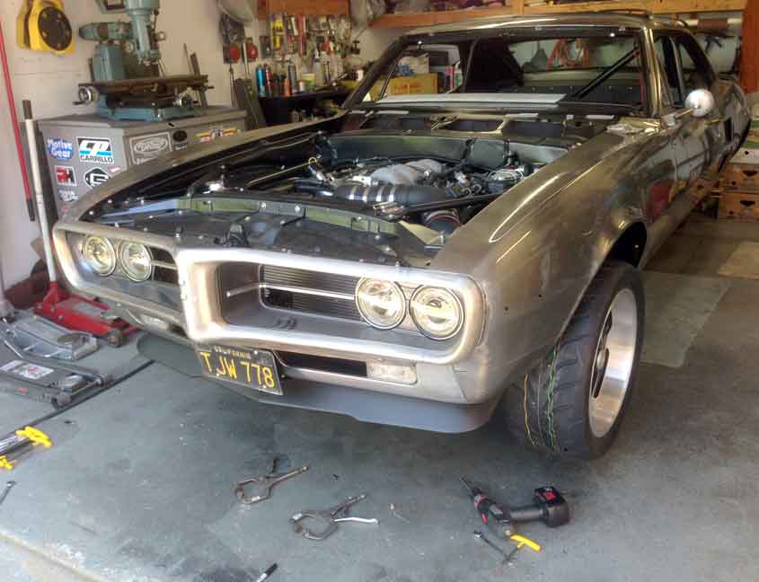

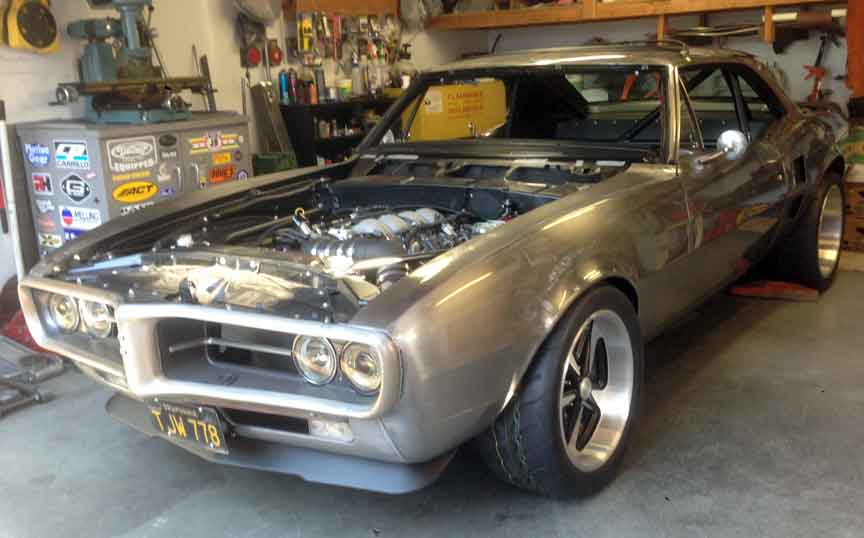

So my rims and tires came in this week. I'm very happy with them. I did a quick mock up to measure for my axle trimming (although I am digging the '70's look with them sticking out. Maybe I should just add some flares and call it a day, ha ha) and to make sure the fronts would fit. I have a tiny bit of rubbing on the backs of the wheel openings against the allen bolt heads. I could just take the bolts out, ha ha. The top of the wheels are a bit close to the fenders but the front end isn't aligned yet. They look to have + camber right now... I also painted the cage modification, started on my air intake assy (need more parts to finish this) and I wrapped my windshield trim in flat black 3M wrap. It was a productive weekend.

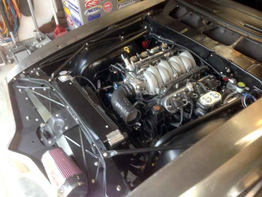

I finished the cold air intake assy, connecting my rad hoses, and RXS atch can. Only thing left in the engine bay is an IAT sensor. Rock auto is sending me one as I write this.

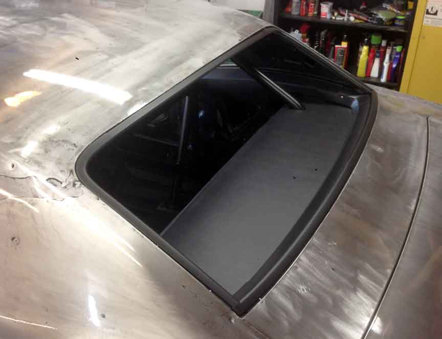

I bought one of those "Spoilers by Randy" and installed it. I like it. I wrapped it in black vinyl for now, as I opted for the brushed aluminum version and didn't want to paint over it at this time. I also had a glass shop come by the other weekend to install the front and rear glass in my car, only they brought a scratched windshield, so I sent it back and hopefully they will be back next weekend with a decent piece.

Thanks, will do. Yeah, these are the US mags- the forged ones. I think it's becoming a trend They are 18x9 front and 18x12 rear.
