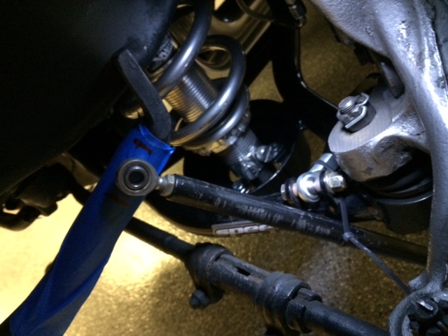

Cutting the Front Swaybar 1 1/2" and putting heims..
then moving the LCA mounts to the front.. Trying to
stiffen up the front without reinventing the wheel
Also installing left and right hand threads on the verticles so I can
adjust it without taking everything apart
Bob

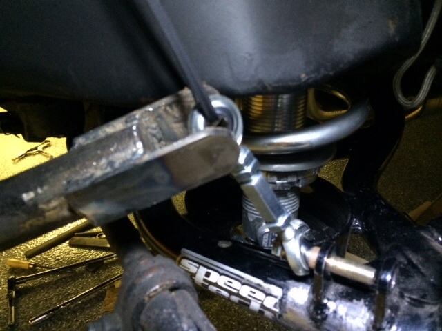

So cut old bar and welded tabs. We were going to
weld lower tabs to get it aligned. Figured out the newer
Bar is wider and will line up good. Back to fabbing
This time should be quicker
Bob

Shortened and prepped the second front bar for welding
This bar is wider and will line up better.. Then off to the rear
bar to make it stronger
Bob

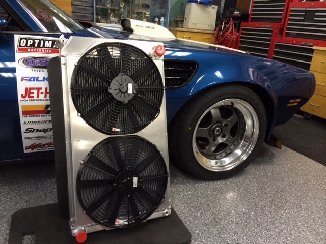

New radiator showed up today
The old one was 4 core that was over 25 years old
New griffin 2 row 1 1/4" tubes with 16" Spaul fans
Need to figure out the mounting since the shroud is
Going away
Bob

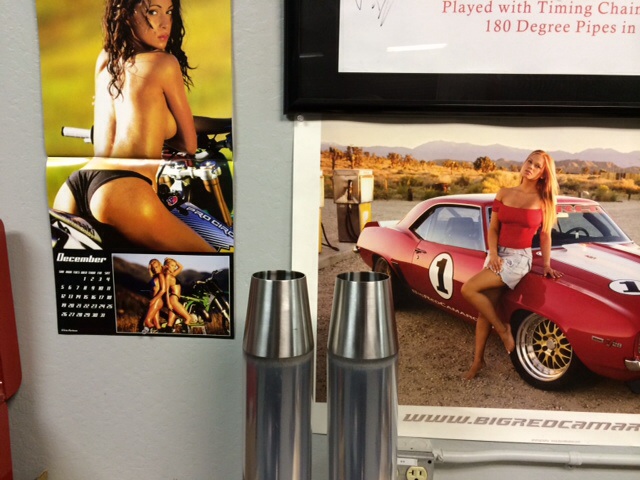

Ok I figure since Sieg can post pics of
his lawn mower I can jump to the Pantera
Going to Texas world speedway near Houston
in a few weeks so need to get the black car ready
Been running 4" straight pipes where I can but after
the carb rebuild the motor likes some back pressure
Gotta run straight pipes cause there will be full race
panteras with theirs. So I bought some SS conicals that
go from 4" to 3". Since the pipes are coated I will have
Lupe a NorCal Shelby guy weld them up for me
I think these will sound pretty cool
Bob
Going away
Bob
WTF - Why would you ditch the shroud???
  #110
Old 04-22-2015, 08:54 AM
Panteracer's Avatar
Panteracer Panteracer is offline
Join Date: Oct 2013
Location: SF bay area
Posts: 1,185
Thanked 313 Times in 123 Posts
Default Dreamin Tas
I am talking about deleting the stock shroud which
actually holds the radiator in on a 70s bird
The new rad has its alum shroud that I am keeping
but will not fit inside the old plastic assembly
Bob
