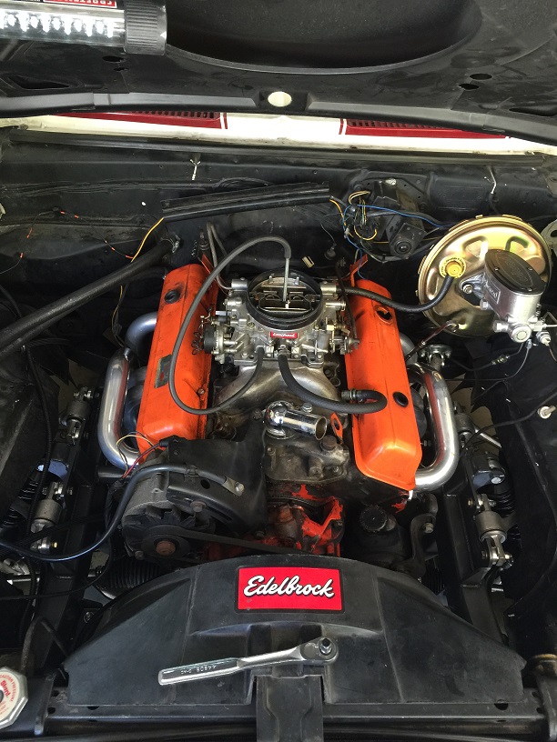

1969 camaro with non orignal 350 SBC with iron heads a mild edlebrock flat tappet cam, crane stamped roller rockers and mystery valves, springs, push rods all done by previous owner..But it does have all ARP hardware so thats a plus
I heard some clacking under the hood. Car had been idling funny yesterday afternoon. I thought maybe my recently changed timing was causing pinging?
Pop'd the hood..Distinct metal chatter from valve cover..Opend to find the rearmost rockers all twisted. Further inspection revealed 2 bent push rods.
Question, what else should I inspect for damage? One of the valve ends is messed up a little/flattened and put some wear marks on the roller tip. I would have to remove the head to change it obviously? Can i get away with just replacing the 2 push rods and reseting the valve lash to get back up and running?

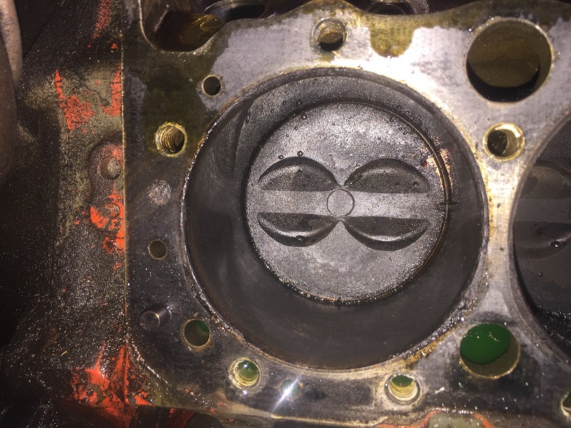

I prbly should have tested the compression before I tore it apart. I was expecting to see piston to valve contact. There was none. How can I inspect the cam? Pull it out or just remove the #8 lifters?
The rest of the push rods on the even bank seemed straight by the roll method. The rockers on the other bank seemed pretty loose. Those push rods also seemed straight.
I would to get this engine back up and running while I decide on the future. Could it be as easy as 2 push rods and a valve and maybe a new flat tappet cam?
