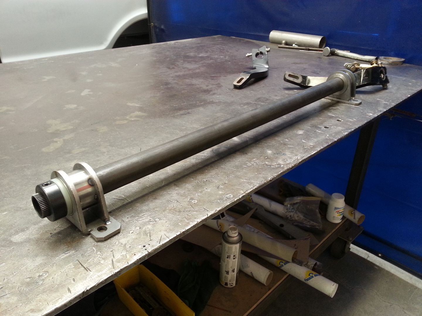

Got some time finally to post what I did to upgrade the suspesnsion.. The car had already been set up for Auto-X but need to freshened up.. So I just went ahead & rebuilt the whole suspension with Van Steel, JRI Shocks & Wilwood brakes.. I built my own front sway bar.. Modified the the rear trailing arms so that I could run the shocks on the back side where the leaf spring would go for quick adjustments & spring changes.. The car already had a quick ratio steering box in it.. Very basic simple bolt on stuff with just some minor changes..
The LS Conversion has begun! We already built the gas for the car.. Went ahead & changed the location by dropping it to get the center of gravity lower.. New thing we are doing in our gas tanks is Vapor domes.. Next step is to build an Aluminum radiator support using a C6 Corvette radiator to bring the cold air tube out the front of the car..
