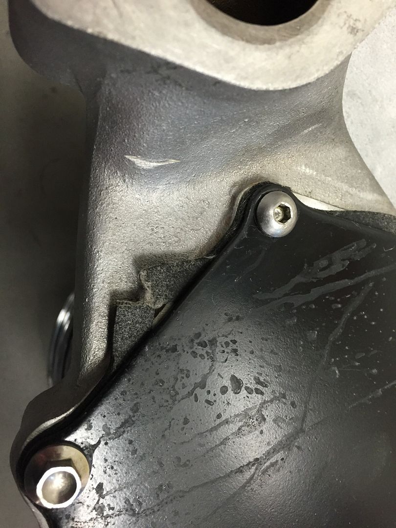

The story gets another chapter.
I got the upgraded stage 4 Stewart pump back, put the car back together, and took it for a ride. Got maybe 5 miles on it, and jumped on it in 2nd gear. Ran it up to maybe 5 grand. A minute later, noticed the gauge was at 210. Pulled to a side street & popped the hood. Was greeted to a motor covered with anti-freeze, and a gusher spraying from the pump. When it slowed down, I could see it had blown the gasket for the rear plate of the pump.
Another 2 hour disassembly (I'm getting good at it) revealed this...
My motor builder had tried to warn me NOT to run a thermostat, especially with the upgraded pump, saying we don't need one, and it is too restrictive. He says we control water temp with the electric fans, and the thermostat needs to go.
The pump obviously made so much pressure, something had to give. I have no other idea how to eliminate the pressure other than to ditch the 'stat.
I made a new gasket, glued it in place with Hi Tack, and put it back together. this time WITHOUT the stat. Drove it about 5 miles, it ran up to about 180, the fans kicked on, and dropped it back to about 170 (where they are set to turn on & off). So far, so good.
Of course now I'm gun shy, gonna stay close to home until I get a few more miles under my belt.
In the meantime, I hope I don't get a ticket for inattentive driving while fixating on the temp gauge!
I hope this is the end of the story....

Lots of folks seldom, if ever, look down at their gauges while driving, so good for you, for catching this in time...again. High rpm's and thermostats usually don't mix. I found that running a restrictor in my water neck, not a thermostat, made my cars run cooler, because it kept the water in the radiator a tad longer, thus giving the water more time to cool. This was not on street engines, but race engines at high rpm's. Something to think about when summer temps arrive here shortly. Don't you hate it when your engine builder is right?

I'm going to disagree with your engine builders opinion of controlling the temp with the fans, while that will work at low speed in traffic, it will not work when moving at highway speeds with airflow through the radiator. Fwiw I have a 750+ hp enine that spins to 8K and it cools just fine with a stock GM pump and 195* thermostat. Imho there's no need for fancy high flow water pumps, running the engine too cool is not good for it either. Ideally you want it warm enough to get the oil to get to 212* to boil out the condensation.

My builder's opinion/experience is way more complex than what I typed above. I didn't want to type a long diatribe, and most don't want to read it. I don't claim to know all he does, but he agrees you need oil temp. But oil temp runs considerably hotter than water temp, and (in his opinion) you don't need or want that much water temp.
A little more info... My motor has about 11.5:1 static C.R., and the cam timing provides for about 220 lbs cranking compression. I use 92 octane gas. I have a 6 speed & 3.55 gears, so in "touring" mode, I am at about 1500 rpm at 65 mph. Another factor is I can sometimes get stuck in traffic on a 90 degree day, and with a black car, want to be able to run the A/C. (What is the point of having A/C if you can't use it?) With this setup, we want to control the temperature as much as possible. His biggest concern is detonation. And I think we can all agree that higher combustion temps lead to detonation.
My car has the Vintage Air Frontrunner system, which comes with the Stewart pump. Do I need it? I don't know, but as long as it was engineered that way, I will run it if I can.
My motor is new, with more static & way more dynamic compression. I also have a new larger radiator with larger fans. And now the "new" pump. Dialing this in is a learning experience for me. I have always run a 'stat in my cars, and read years ago you needed the restriction the 'stat provides to create higher pressure in the block to prevent hot spots from locally boiling coolant in the heads. I had installed it with the new pump, but it obviously didn't do well with that restriction. I can control the fans with my ECU, and (so far) it seems to work well.
Drove about 60 miles on Saturday... it ran at 150 in 55 degree weather, and about 165 when it warmed up to 75. Drove it about 50 miles yesterday in 80 degree weather, sometimes with the A/C on, and it never went over 180. I am very happy when the gauge is under 200.
Time will tell about the city vs. highway speeds, and 90 degree days with A/C. But so far, so good.
And thanks for weighing in!
