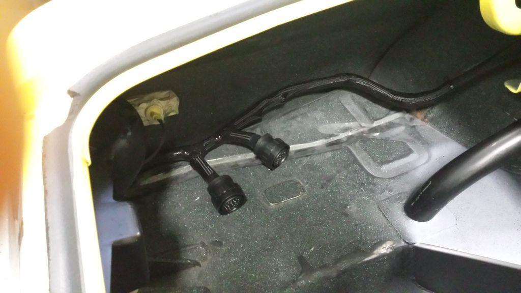

Thanks, Robert. I believe that's the lower access. I know Mark has said he was putting a door in one of the cars he has built. I just can't remember which one it was.

the removable lower is access to service the tank and get to the lines. there will be a fill port / dipstick through the firewall similar to how it was on hellfire

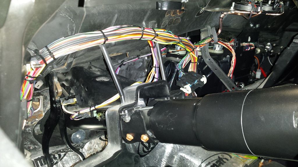

We wrapped up 90% of the wiring. I need to finish the ABS brake lines then we can repaint the engine bay and bottom of the car.
Mark

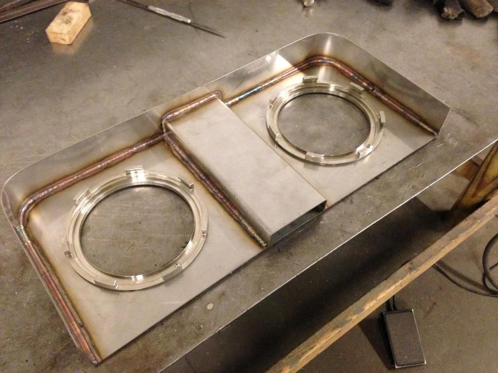

We finally have a solution for fuel flow. With a lot of help from Kinsler, Carl Casanova and Jason Hines we feel the best solution for E-85 and Gas for street and track is going with 2 CTS-V fuel pumps controled by Carl Casanova’s Vapor Worx system.
We need 2.2 gallons a minute at 65 psi at full power.
Because JA had a Ricks tank Matt is modifing the tank to allow two pumps and the in-tank pickups.
Good choice! It'll prob look like this when done.

Very nice.
I guess pm'ing Carl is in order to see if that retrofit is doable/available for my Ricks tank, as i do get starvation issues on the road course at 1/2 tank....(hmm, maybe i'm not driving hard enough?)
