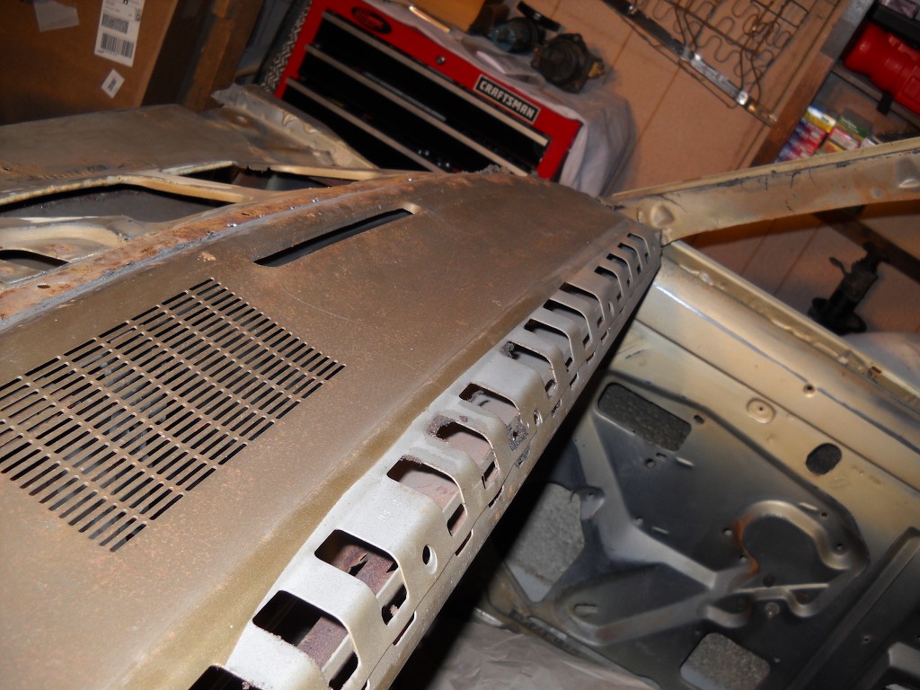

Chief, do you have any pics of how the dash and cowl come together? On a nova they are welded, does the camaro do the same?
Lance ... the dash and the cowl panel are welded on the top. My front and rear AMD glass just came into town, figured I'd mock it up first before I welded them together. Same thing for the rear glass, trial fit before the quarters go on .... OCD!

Thanks for those two pics. That was the before correct? Do you have any pics that show what it looks like after? Do I make holes and "spot" weld it or tack it in all the way across and then grind down? I'm sorry for the ignorance on this one? I'm just not sure how to move forward because my dash was already pulled apart and I cant tell how it was together?
No problem ... in the first pic you can see where the 2" band of rust goes across the cowl, that is where the upper dash came to and I just drilled out the spot welds to remove that strip. I will use my hole punch to prep the upper dash for spot welding.
I need to fit the front glass to make sure the angle at the bottom is in-line with the A pillars when the glass is set inside the opening ... I may have to sharpen the or change the angle to match the A pillar.

I got ya now. So it is spot welded between the two. Thanks a lot!!!

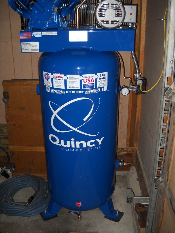

Oh yeah ... got my compressor in and bolted to the floor ... back in business!!
